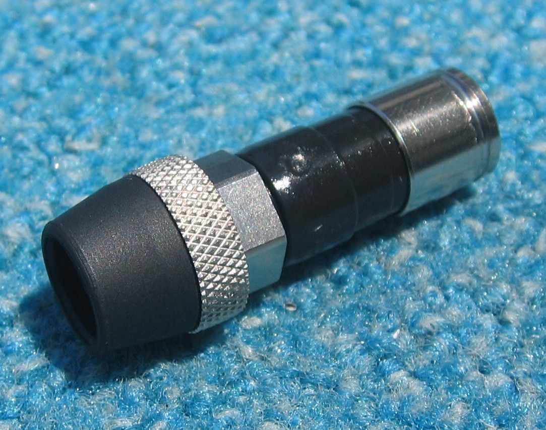

    I'm convinced the moisture (rain) got in through the threaded couplings. Some of them I have are the type with a flat on one side. Probably intended for use in electronics backplains. I have purchased some others now. The type of f connectors I use are the same as the Cable/Sat installers use. No crimping, just compression onto the cable end. They use a type with a water seal ring on the back end. I haven't found any of these but I do put sealant in that area. I'm thinking, maybe put a shrink sleeve on that area.
    My present installation is only temperary since I haven't dug the trench for my conduit/cable run to the house. I will eventual put a weather proof box at the pole with my grounding connector. I think, at that time, I will rerun the cable going up to the LNBs since I don't think I have enough to cut back the effected section and still make a drip loop (plus some extra for future changes). I have plenty of single R6 Coax left over from an extensive Cable Co. job on my old house.
