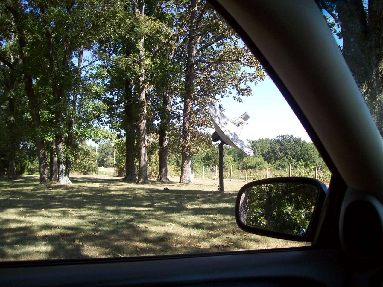

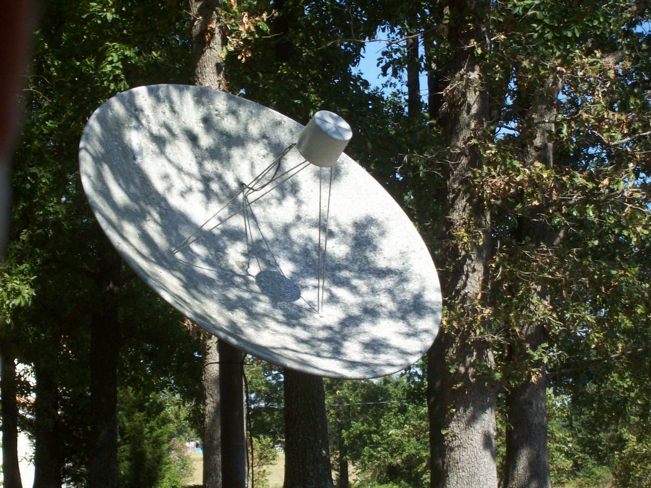

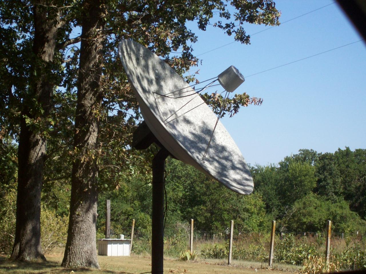

    I believe I spotted a Birdview dish Friday night,and wanted to know how good are they with Dvb-s2 C-band and Ku-band. What signal's if any are you guys not able to pickup with it. The reason I ask is,if I get one it will have to be mounted about 9ft. in the air.And I would not want to do the work of putting it up,only to replace with a bigger dish later on. Sorry I have no pics of the dish I spotted but it had six rod's holding the lnb and cap, and the mount looked just like some of the pic's around here. Please any info,about the good, the bad, and the ugly of the Birdview Dish. Thanks Long Hair
