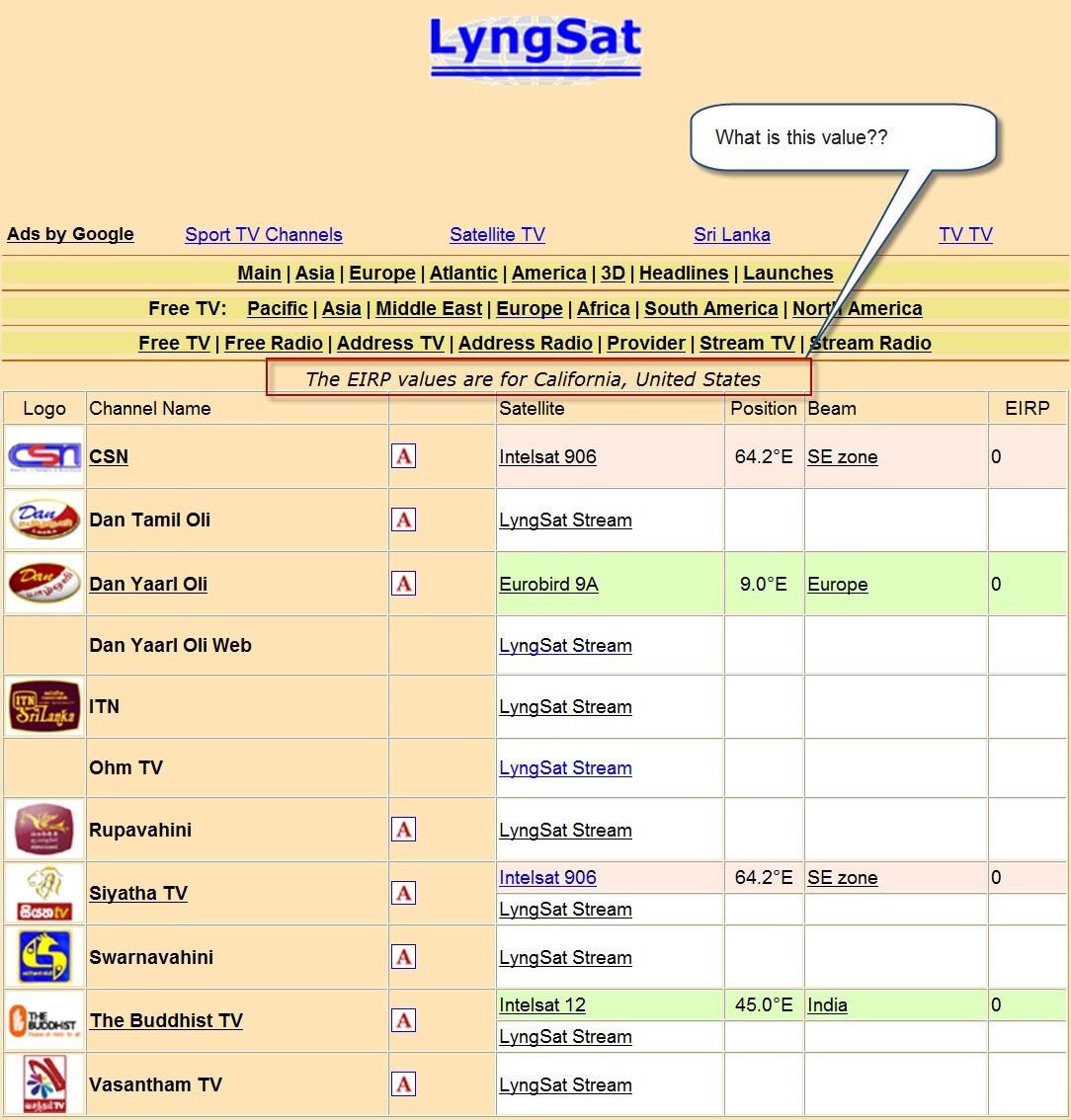

    I captured this screenshot from LyngSat web site. It gives the position INFO for relevant satellites. But, I do not know what is EIRP value and its connection to watch these channels from California.
    Are you sure, I cannot watch these channels even after seeing this INFO. Please advise!

    Basically, an EIRP value of zero means you can't get it. Also, if you look at the beam, sometimes you may be able to see a satellite, but it isn't beaming anything in your direction. But in the case of the two satellites you list, you can't even see them (below the horizon).
