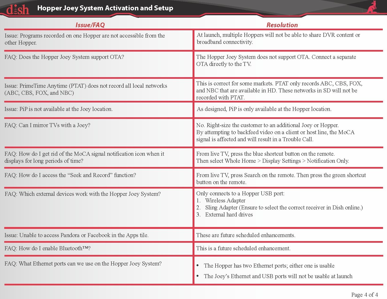

    Hmmm... According to Dish the Ethernet port on the Joey is not active as of now.... Did you try hard resetting both the Joey and Hopper?
    Attached Thumbnails Attached Thumbnails Click image for larger version.

    Yes, Hard reset on both the Hopper and Joey. The Ethernet on the Joey works as thats the only way I can get it to access the internet.
    When i plug it in the Ethernet drop down on the Network Setup page becomes blue and it gets an IP Address from my router.
