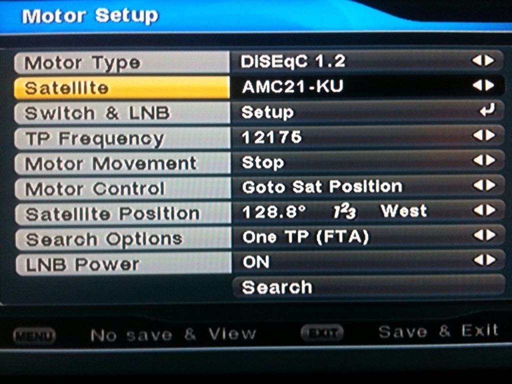

    DISEqC 1.2 or USALS
    Get Rid of this Ad! Register Today!
    I know you guys are getting tired of my tiresome noob questions.
    Once more:
    When setting up the motor in the DSR200C settings, should I be selecting DiSEqc 1.2 or USALS? (with a SG2100 motor).
    Also, until a few mins ago I had a steady LED light..now nothing.
    I have tried resetting the motor and making sure that the connections are tight, still no go..
    Mark
  7. #6
    Help Keep SatelliteGuys For All, Click a Star and Become a Supporter! ESA1178 did! Help Support The Site And Get Rid of the Syndicated Ads, ESA1178 did! If you enjoy the site consider supporting it, ESA1178 did! Be COOL like ESA1178 and Click a Star and become a Supporting Pub Member today!
    Join Date
    Oct 24th, 2011
    Location
    Sacramento, CA USA
    Posts
    116
    Post Thanks / Like
    Thread Starter
    Dsr200c & sg2100
    ADVERTISING BOX
    If anyone has the dscr200c and sg2100 combination could you please pm me?
