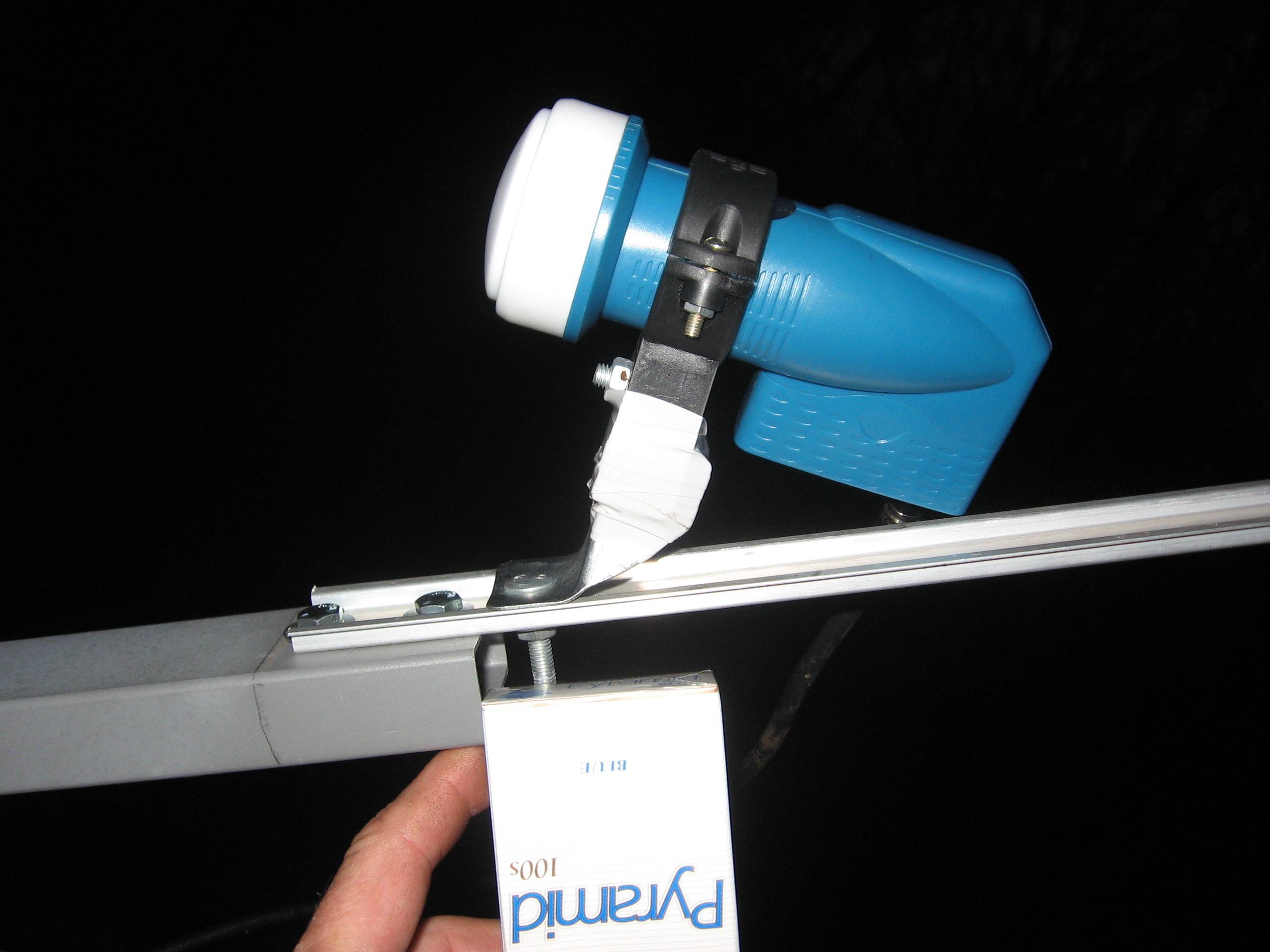

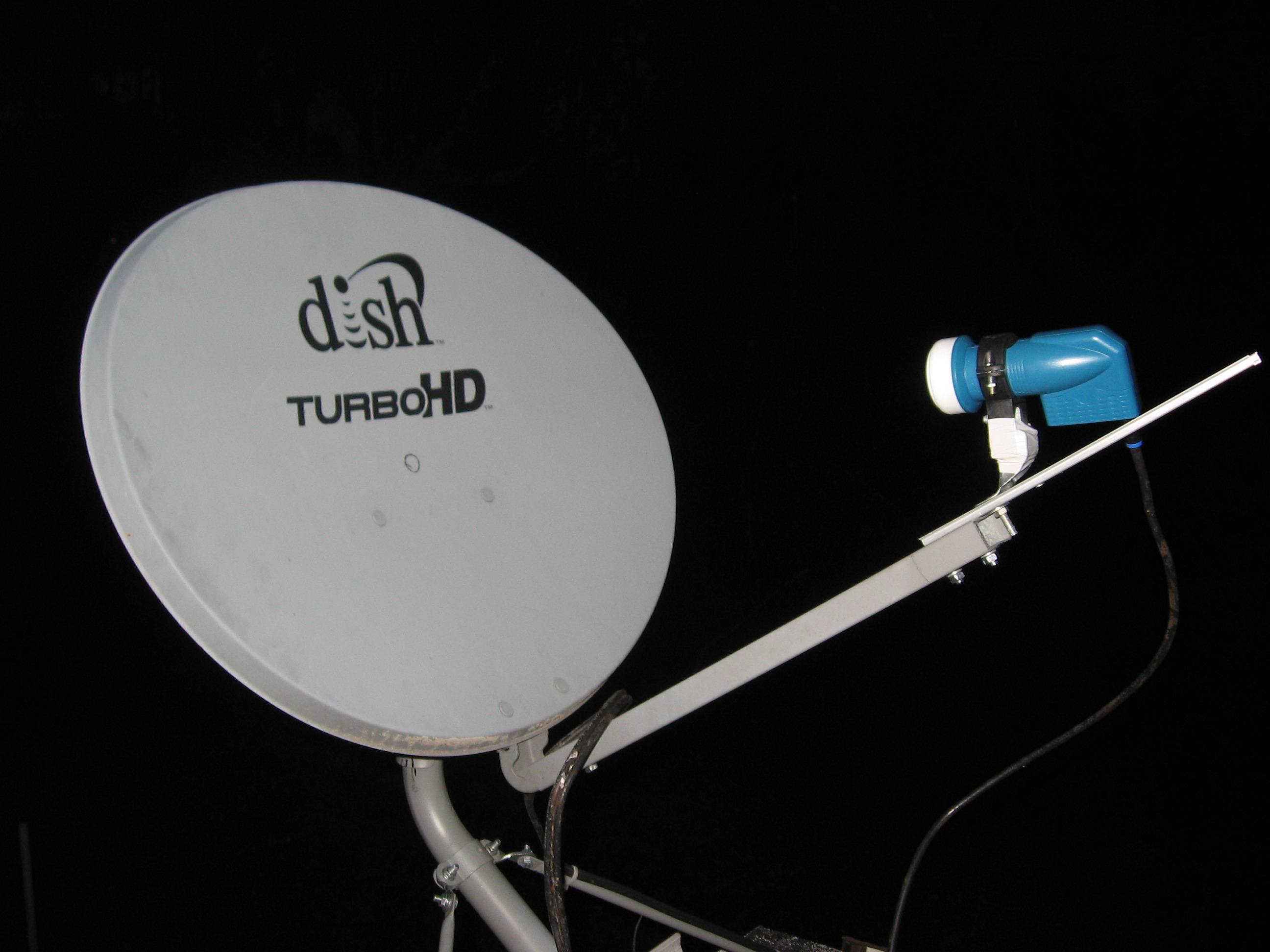

    Yes it is posssible, but remember the bigger the dish the stronger the signal.
    The smaller dishes are designed to receive KU signals.
    I used a new $12 LNBF and I had to extend the LNBF arm to get max signal.
    This dish is stationary and is pointed at 97W, only 1 satellite. This dish would be to small to put on a motor.

    Anole is right about the nutshell dishes.
    I would recommend that you read a lot here to have a basic understanding how things work and how to set things up and ask questions especially before you buy anything.
