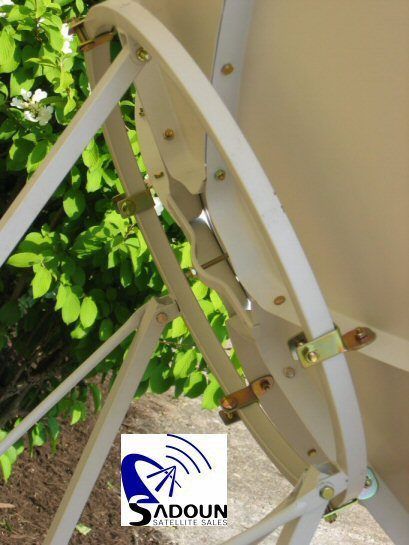

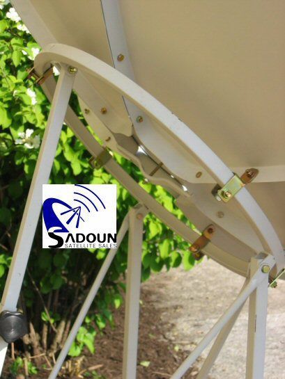

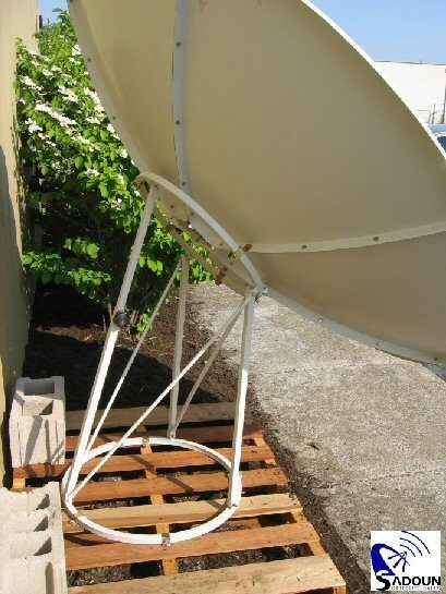

    I'm thinking about buying Fortec 180cm dish and making it moveable...
    Is this even possible? Welding is no problem, my question is, can it be set up correctly to work with actuator arm?

    I think the only way is with a proper polar mount, it looks do-able.
    Gotta love those prime focus dishes

    "Proper polar mount' ... meaning one designed for that particular dish or universal mount?
    I wonder if Fortec makes a kit or something. Everywhere I have seen it is has the "ground stand" mount only.
    I'm not real familiar with how these polar mounts work. Any explanation or pictures would help greatly.

    The ring looks like it'd attach to a regular polar mount, you could use a standard prime focus mount which should fit with minimal drilling.
    When Sadoun sends me one for review I'll get right on it

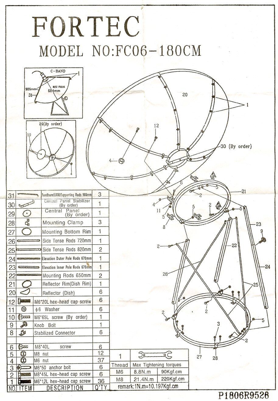

    There are 146 pieces/parts. A real pain in the a$$ to put together, I'm sure.
