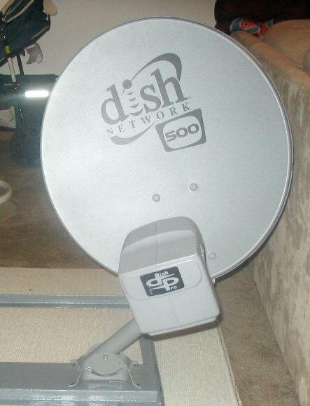

    If your dish looks like the one below (trimmed from another picture on this forum), and has either the twin LNB (shown) or two individual LNBs, then...

    To answer your question, there is an adjustment on the back to the dish, which allows you to twist it as shown in the picure.
    That is skew. You need to dial in the amount suggested by your calculator as the first step, and lock that down.
    Then you set elevation, and snug it down gently.
    Now, swinging the dish from side to side around the correct azimuth, you should find whichever bird the LNB that's connected to your receiver is aimed at.
    After a little left-right fine tuning (then you snug that down), followed by a little up-down tuning, you should be pretty well peaked.
    People talk about the left or right LNB, but nobody is clear if you are behind or in front of the dish.
    It's easier to say "the LNB on the east side" of your dish, or "west side".
    If anyone gets that wrong, they can go back to grade school.
    Anyway, the eastern LNB will be 91 and the western LNB will be 82.
    Hope that helps.
