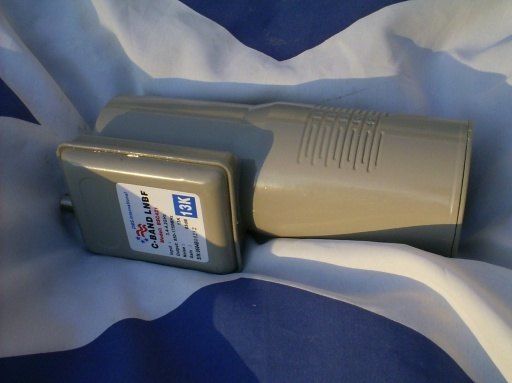

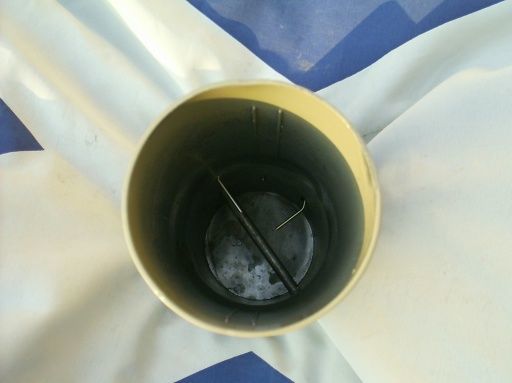

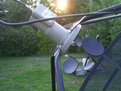

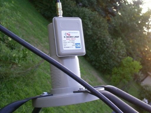

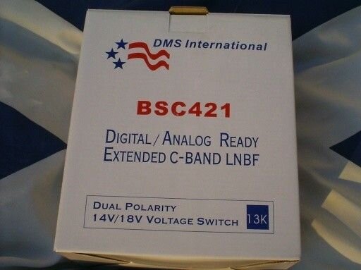

    My BSC-421 C-Band LNBF just arrived!
    Took some signal readings from where I was parked (G4R) while using the ASC-421.
    I swapped over to the BSC-421 and immediately seen an increase in signal quality on EVERY transponder.

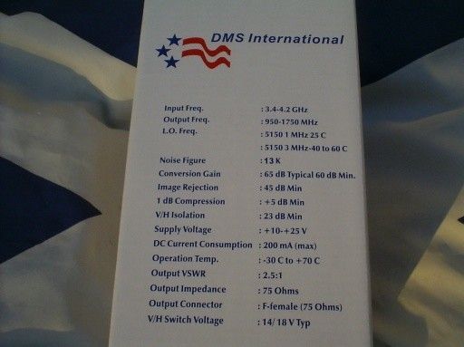

    Seems that with the new BSC technology everything is on one chip, increasing the reliability and signal quality! Works for me!
    I have not even tried tweaking the LNBF at all yet, this should really help with the weaker C-band signals, 13k noise level.
    G4R
    WB HD was getting 58% JUMPED to 76% Quality
    Nets was 52% now 61% Quality
    ABC HD was 61% now 64% Quality
    "The above signals were on the DVB World USB receiver, so lower signal levels than most STB receivers."

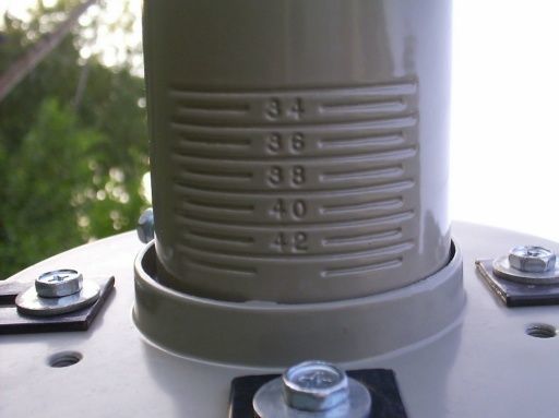

    Pete
    Is the unit heavier than the ASC421?
    On my 6 footer, I have the LNB pushed in to the "38" line for optimum signal

    ASC-421 = 12oz or 350g
    BSC-421 = 9.5oz or 275g
    The BSC-421 is also longer at 7" compared with the ASC-421 at 6"

    Is that on your 6' mesh..
  5. #5
    Join Date
    Nov 5th, 2003
    Posts
    Post Thanks / Like
    Thread Starter
    ADVERTISING BOX
    Quote Originally Posted by BKP
    Yes, just noticed the 76% signal quality on WB HD has jumped to 79% quality today
    I put he ASC-421 on my skewable Globecast dish for kicks and giggles
