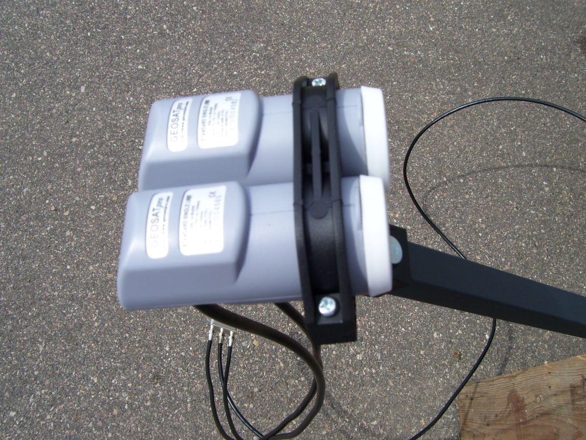

I cannot believe how small these things are. My DirecTV ones are twice it's size. It took me longer putting together the 4 degree bracket and LNBs then it did all the dish parts. Part of the reason is I found it very tight and hard to get the LNBs properly lined up 3/4 inch from the edge of the bracket. Of course then I realized I put the LNBs in backwords and had to do it all over.

Following the install instructions I first tuned to AMC4 and ABN. Very little tweaking I'm getting 97 level and 97 quality. On LLBN the weak one I get about 60/60. I'm thinking, this is too easy.
So I swap the cable over to IA5. I notice that ABN still has about a 40 signal but nothing quality. I just note it because I figured there would no signal.
So's I tune to TBN and with a bit of tweaking I get about 75 level and only 30 quality. Nothing for the weak channel (Miracle). I swap back to ABN and I'm down to about 80/80, still very solid. Back to TBN I can't get above 30 quality.
Rain moving in so I'm done for the evening. But I'm wondering what might be done with TBN and the IA5 channels. If AMC4 is coming in so good I'm a bit leary of adjusting elevation much but that was my next target. Could it be the LNB itself needs to be tweaked? I see in the instructions each LNB can be rotated a bit or pushed in or out. It's a tight fit in the dual LNB holder so I want to avoid that if I can but obviously will do it if needed.
Thoughts?

Even though you are connected to the wrong LNBF (3ABN selected, connected to LNBF2), the receiver will show a Signal Level, but it will not show Signal Quality. This is because the receiver is seeing a RF signal, but not the correct signal.
Few things to check:- Was the reflector checked for warping during shipping prior to assembly? (Lay the reflector face down on a perfectly flat surface and verify that all edges are perfectly flat. If not follow the instructions on pages 13 -14.)
- Skew angle set correctly on the dual clamp? Page 16
- Skew scale visible if standing in front of the dish looking towards the reflector with LNBF1 on the right side and LNBF2 on the left? (AMC4/ Right, Galaxy25/ Left) Page 16
- Are the white faces of the LNBF slid forward towards the reflector 3/4" (20mm) from the clamp? If the LNBFs are slid completely forward or completely back against the clamp, the signals from the two satellites will not converge properly. They must be set at 3/4" forward to locate the satellites. Page 17
Expect to see Quality Levels:
LNBF1 (on right side):
Channel 7, 3ABN 80% - 90%
Channel 5, Hope 70% - 80%
LNBF2 (on left side):
Channel 2, 3ABN 70% - 80%
Channel 3, Hope 50% - 60%
Call our support department if you need any help!
