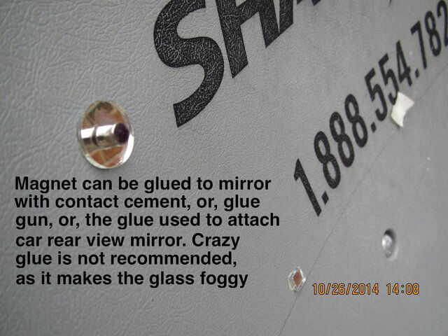

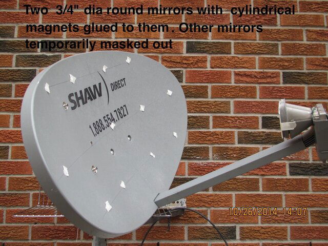

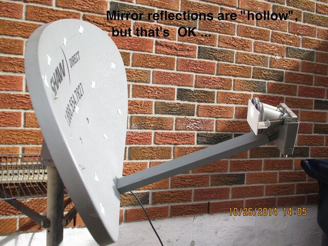

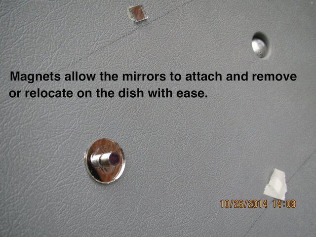

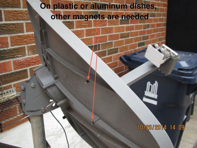

This could be useful for checking used or reclaimed dishes, big or small. String test is not reliable in some cases (for example, a steelpan would test perfect, despite having obvious "dents")
The previous version which I tried, involved glueing mirrors to dish using double-sided glue tape.
This could introduce some errors. Similarly, thin magnets between mini-mirror and dish could also deflect reflected light.
Present version assures that reflecting mirror stays strictly on dish's surface. Easy to move, too.
Mini-mirrors and magnets can be bought from craft stores. Handy for experimenters.
Five pictures follow.
Cheers, polgyver
