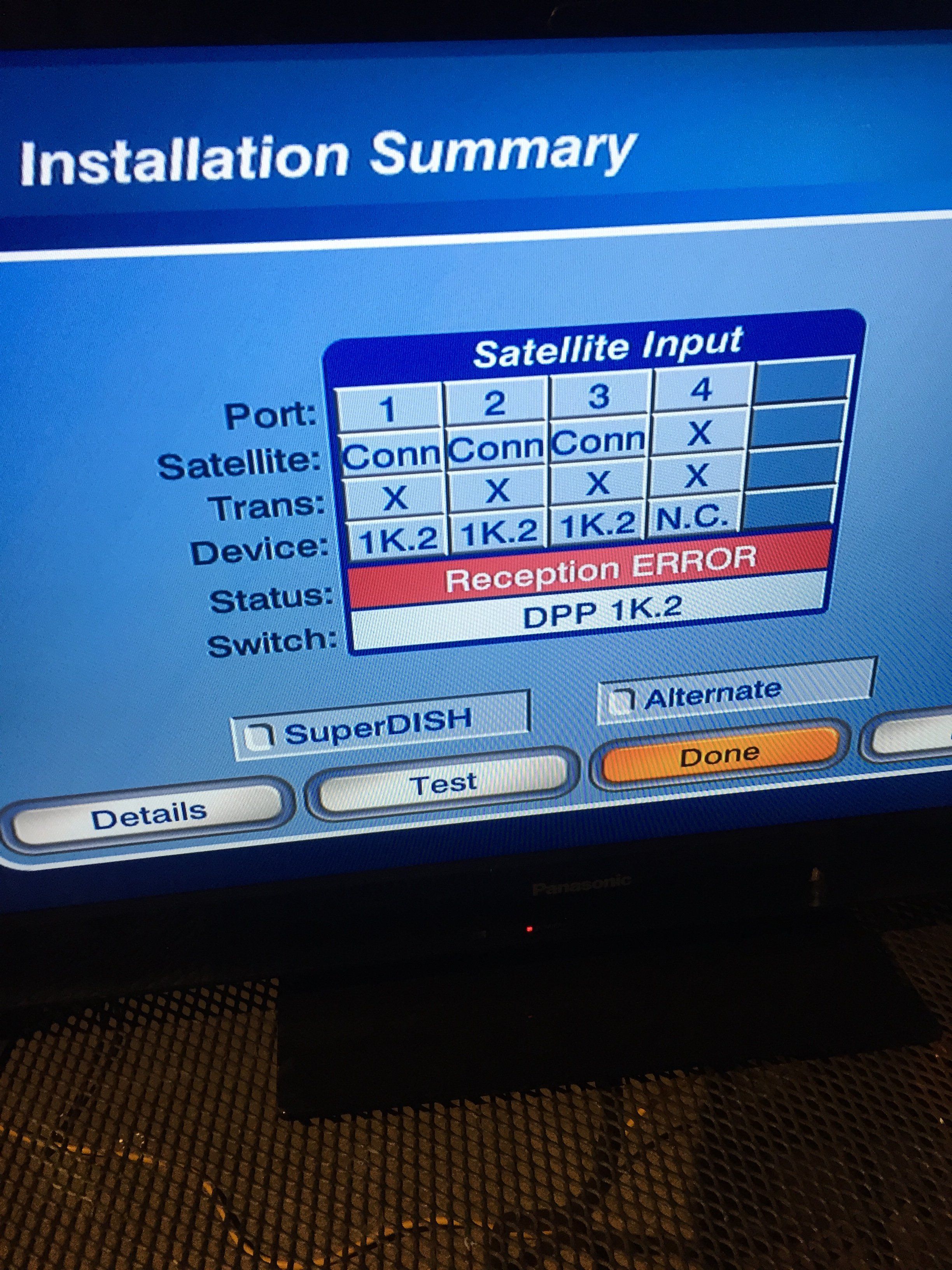

Okay RONZ, I've covered the two end LNB's with foil and performed a switch check, just as you recommended, and I get the following message:
Without going back into it, that sounds about right. That was magnetic north, not true north, correct? They were about 10 degrees off.
yeah. True is 186.8 and magnetic is 174.4

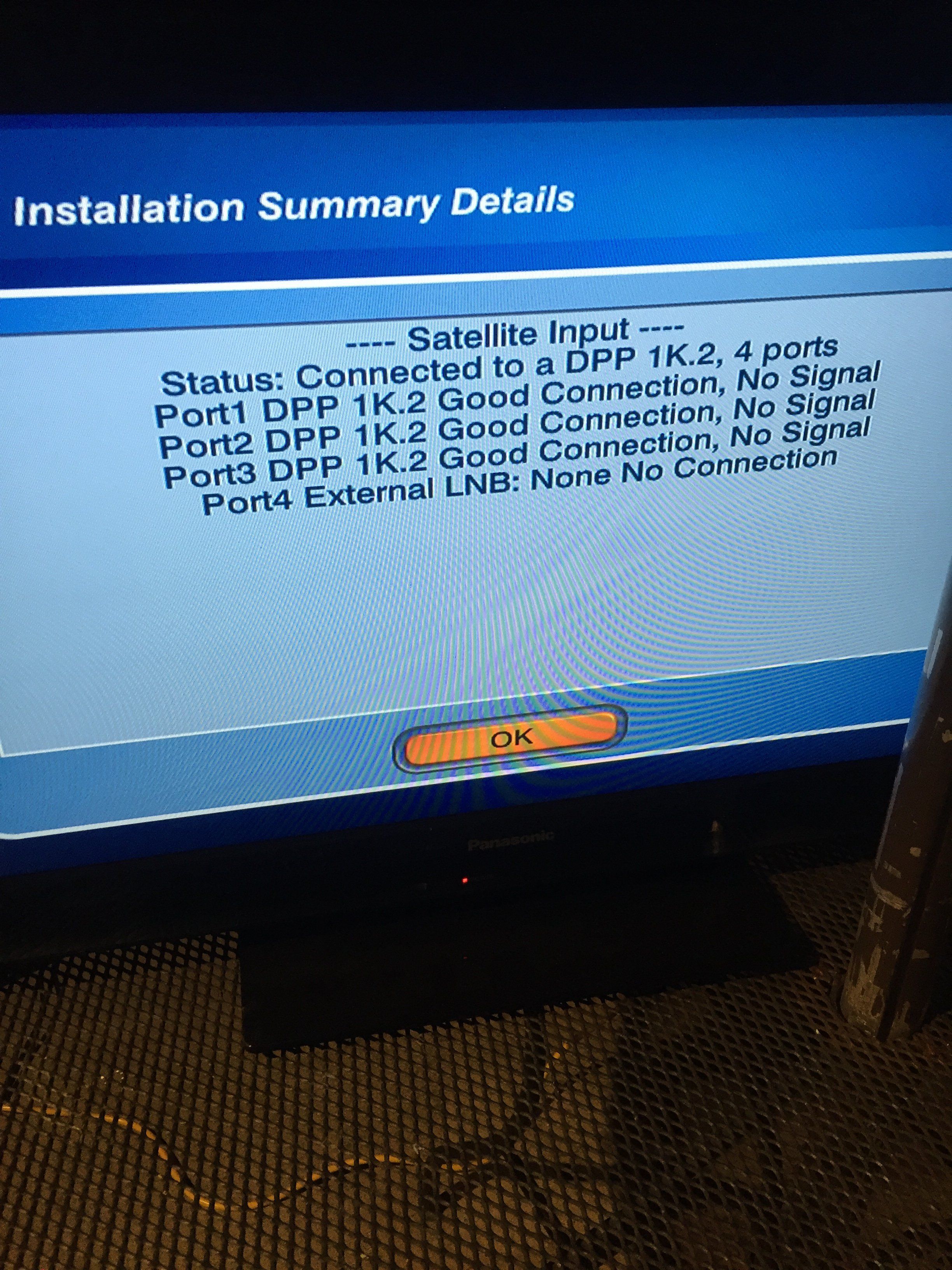

Sorry RONZ. This is what I see:
What does this mean?
That means you're connected and LNB is likely good, but not pointed. Can you pull out the old tripod and give it a go, and see what happens? This all started after changing the tripod, correct?
