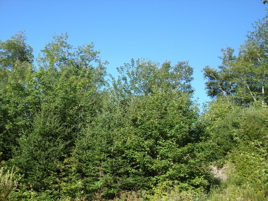

    Some installs are tougher than others. :D Here you go...position your dish pole and line up 125W right through that space gap that drops down at the right side of this pic. All the tree tops are well above the 11 degree elevation of 125w. It's going to take a little longer than an hour. :rolleyes:
