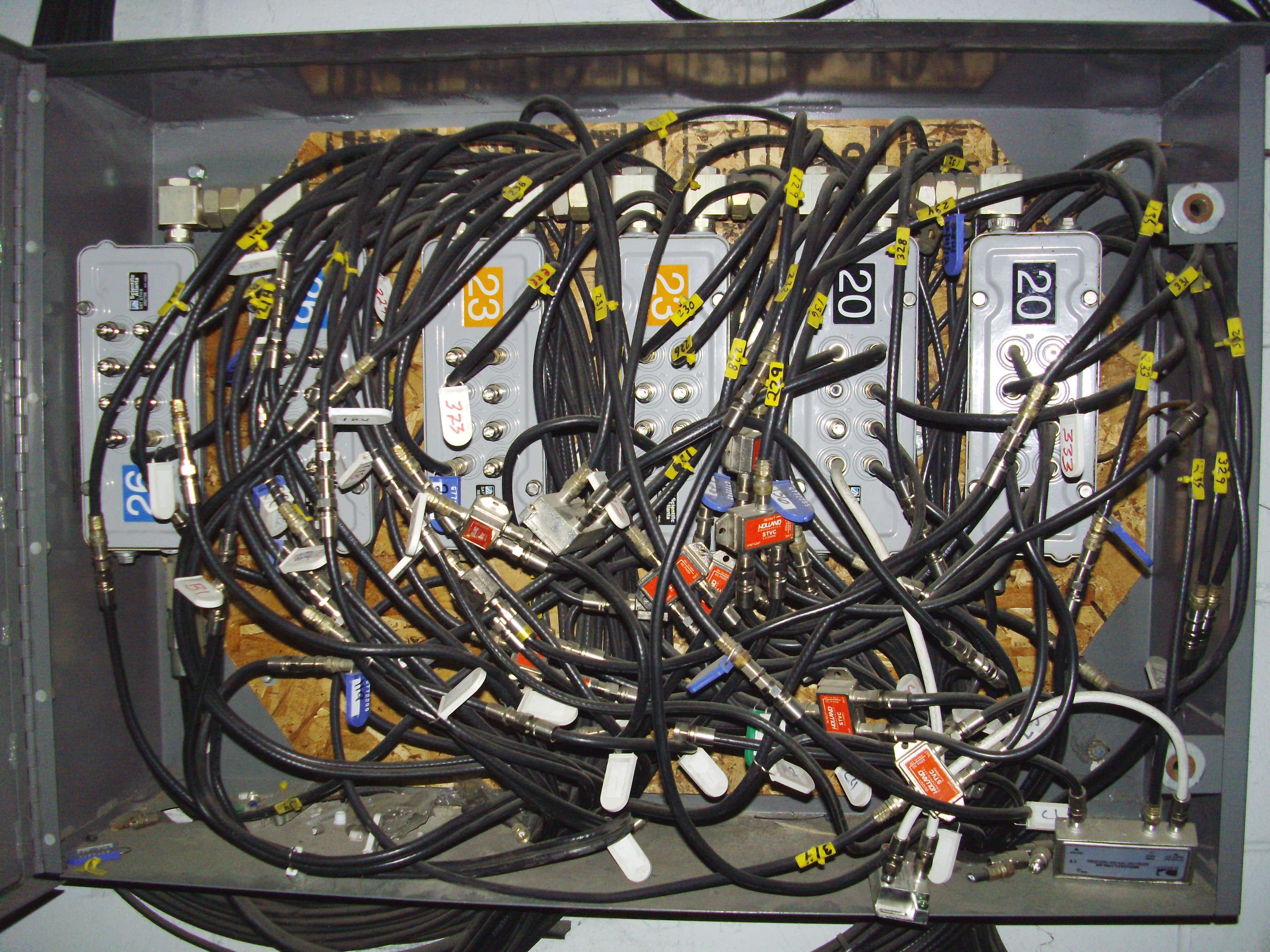

yes you can. Here at the complex we only have one line from the cable junction box downstairs up tot he apartment and folks have Directv and cable internet. Plenty of diplexers in the box. But then again most of the folks here are just SD only ;)
here is a pic of one of the junction boxes downstairs (we have two of them)
If you blow the pic up you'll see a few red holland diplexers there.
