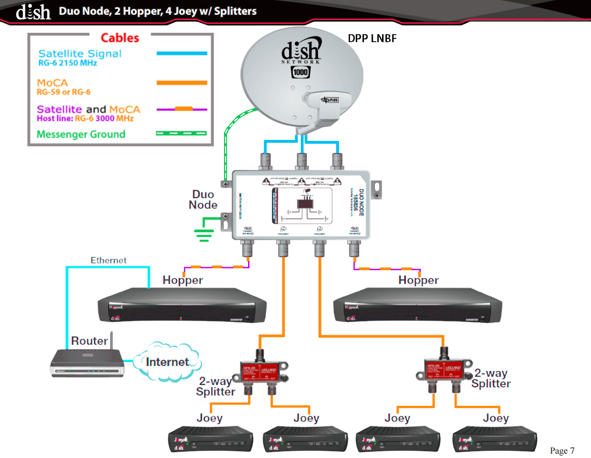

The attached diagram is what I think you should have had for a 2H/4J wiring setup, before you started moving things around. You might want to verify that as a starting point...or at least to give us a point of reference in troubleshooting.
That is not how it is set up. I put it back to exactly how the dish guy set it up, but they have the hoppers running to joey directly for two of the joeys. They don't split the joeys.
They are only split in his picture because it's showing you a six room setup.
You would just minus the 2 other joeys and splitters.

It's not confusing, The diagram is good .
Anyone whom actually knew what they were doing could figure out that picture as is.
