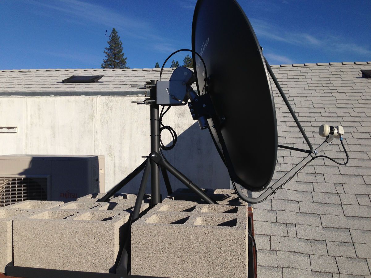

I usually make a loop and loosely nylon tie as shown in this photo. If I need to reroute, put on a new connector or if the dish somehow gets loose and spins in a bad storm, the spare coax length comes in handy!
Service Loop, I use them with cat5 runs also. Just in case you need to redo something.
