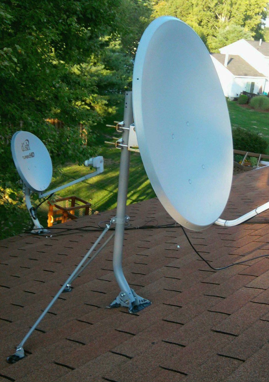

Right now, I'm u sing a 76 cm dish for all my Ku channels from 15W to 129W. I have a pretty sturdy setup with a pole mounted to my roof with the base plate bolted to a roof truss below and diagonal braces also attached to roof trusses preventing movement front-to-back and side-to-side (see my avatar picture). I'm thinking of replacing this with a 1.2 meter dish with C-band scalar ring and side mounted Ku LNB. Is this a good idea? If anyone else has done this, I would love to hear the results. Are the CBC feeds on 107W receivable on a 1.2 meter dish?

I was reading an old thread that Iceberg posted. It was a review of a 1.2 meter dish, and he listed the C-band channels he could receive and the corresponding signal qualities. It was impressive. Now my only concern is how a dish this size will hold up on my roof. The surface area is about 2.5 times greater than my 76 cm dish, and with a 20 psf wind, that's 244 lbs. of force.
As you can see, I'm using a 1.625" diameter pipe. It's fully braced. And every contact point with the roof is connected to a roof truss below. This is my only concern now. If I can just switch out the dishes and use the same pole, that would be great.
You'll need a larger mast for a 1.2m dish. If you go for it, I'd suggest 4 guy wires and 4 anchor points around your eves. If it's braced and guyed properly, you should be ok. I guess it depends on your prevailing wind speed. If you have nearly constant 20 mph winds, I wouldn't do it without much more bracing in the rafters and joists, along with the guy wires and braces. You can't have too much when you are dealing with your roof. Lose the roof, and you lose your house!
Here's a picture of my current setup...View attachment 81364
in my opinion your post does not look strong enough for a 1.2m dish, winds are alot stronger up on a roof with no protection, as opposed to the ground....for what its worth, here are my results on a 1.0m dish, i didnt try very hard though, only for a few hours....

I was reading about the Winegard DS-3100. It's a 1 meter dish and requires a 2-1/4" outer diameter pole. I was wondering if I could use my 1-5/8" diameter pipe and reinforce it by filling it with concrete.
NO, that's a bigger dish than you'd think. I have one from Solid Signal I'm about to install, and it's going on a Primestar 2-3/8" pole, which is what it's designed for. You'd have to shim the 1-5/8" pole too much, and it'll never hold up.
