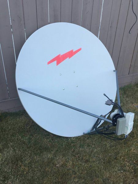

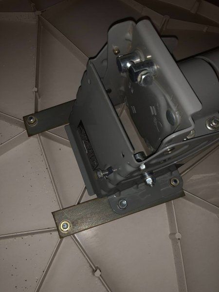

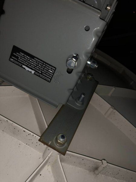

I found an almost new 1.2m andrews dish on kijiji for $80. The dish is very clean and looks like it was kept indoors for most of its lifespan. One thing I noticed it does not have the original mount and has a smaller mount custom fitted. Maybe someone with experience can identify the mount.

That mount will be fine as long as you use the support arms....which I suggest anyway, if you are going to wall mount it.
That's a DTV Slimline mount. And it looks to be a 1.0M dish. The size is cast in the molding on the back of the dish
I think you are right. I didnt look at the molding or measure the size. I asked the owner if it was 1.2m and he said yes. I think he really didnt know much about dishes. When i picked it up it was a little too easy to fit into my car. When i go home I will check and confirm.

Andyboy90 Do not worry, you've got 120 dish. Distance between bolts on the face of the dish is 178mm and it is 6.76 times smaller than horizontal size of the dish. Andrew120.jpg

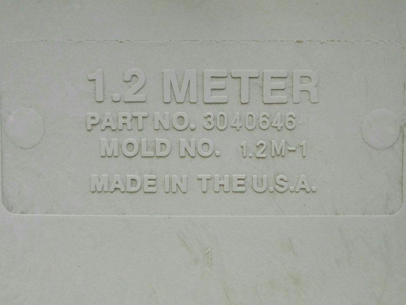

When you get home you will see molding stamp on it's back, it will look exactly like this print.jpg

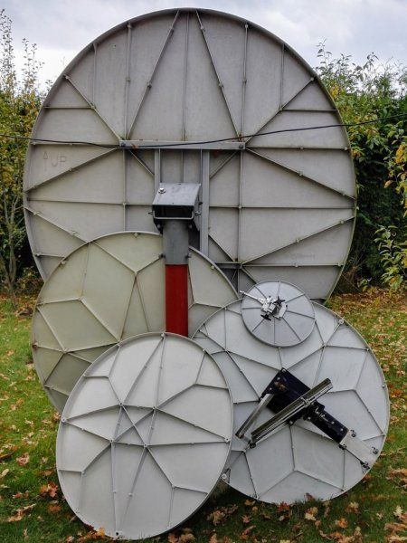

Among all Channel Master antennas, 1.2m of course is there. In addition I have 0.35cm, 0.75cm (not added to photo-session :) ), 0.9m, 1m and 1.8m. Of course all of them have unique strength ribs pattern. Back.jpg
Sorry for the poor lighting.
No problem with light..... do not forget you have PC to improve things :bday

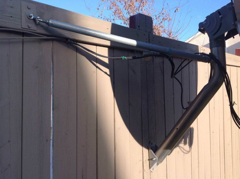

Those support arms look quite beefy.
Yes, feedarms are OK, they can last for long time (problems can appear if installation near salty water). The plastic LNB-holder is bigger "pain" as it is not so durable and does not hold LNB in proper position..... that is IMHO.
