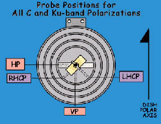

The BSC621-2 LNBF is a voltage switching LNBF, so its works just like a regular LNBF
V =13v
H=18v

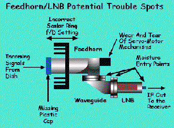

"Most communications satellites maximize their use of the limited frequency spectrums assigned for satellite communications by overlapping the transponders, with their polarization switching from one sense of polarization to the opposite sense every other transponder. This allows twice as many channels in the same amount of space. In order to select the correct polarization, most feedhorns incorporate a small probe that is rotated until best reception is obtained.
The probe is rotated by means of a small servo-motor which is powered by the indoor receiver or IRD."

I have a quick question, I can make the c-band lnb fit on my dish but how do I get the lnb to change from Hor to Ver and back using a fortec classic na? ( HELP )
I manually rotated the polarity probe by taking the servo motor off and rotating the plastic piece the probe is connected to. From what i have read it is a bad idea to touch the probe itself, oils from your fingers will get on the probe and screw up signal.
