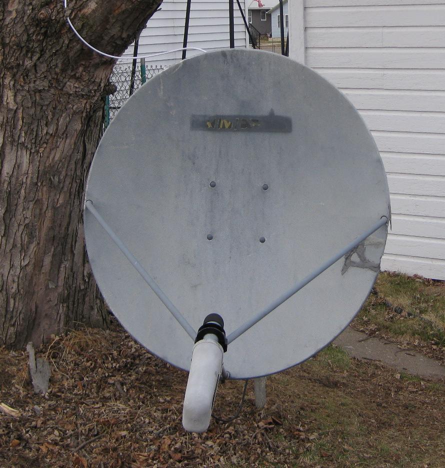

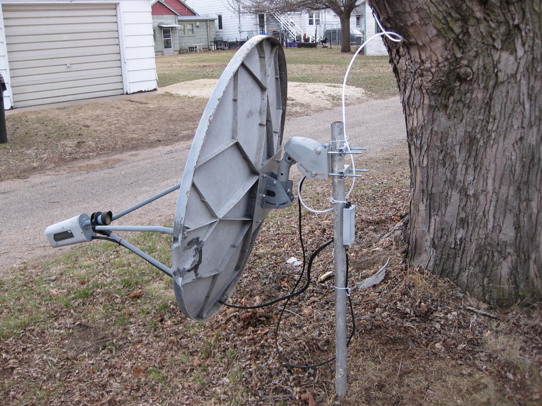

A while back I posted a picture of my 1 meter Primestar rescue, it had some minor damage, and with a suggestion by Anole, I used some J&B weld epoxy to repair it. Soon after the repair was done, I started wondering how I might build a motorized mount for it, so I searched the forums and got some good ideas.

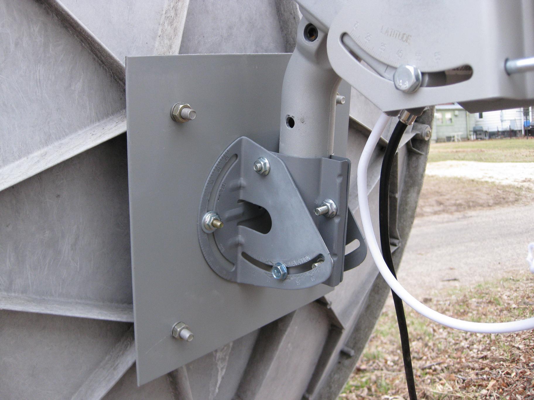

I ended up using the elevation mount off a Dish 500 that a co-worker gave me. And I made an "adapter plate" out of a .18x11x11 sheet of galvanized steel.
I took a hack saw to the old clothes line post by my house, which thankfully was nearly plum, and setup a SG2100 motor. I have been really impressed with the quality ratings I am getting on this dish with the old LNB, Channel Master really made these dishes well. :)

Good work, great results.
There are people in life who no longer do much with their hands, yet the FTA crowd can still think, and then make it happen.
When someone says, "Honey, I have to go out and do the dishes", good things are usually under foot.
Good work Jullius, been needing some inspiration/ideas for the same project here. Now you just need to get some spic n span and wash that thing good, and spray it with some paint!
Awesome job Jullius! :up
The JB Weld done wonders! Will not hurt it a bit there off to that side! Great Rescue!! Glad to see it in service again!! :up :up On the mounting also!!
Bonus points on that back plate mount!!
B~Man
So, . . . the JB Weld did the job to your satisfaction?
That's what I would have tried, but I wasn't certain it'd work.
Okay, I was 99% sure... :rolleyes:
I'm with Turbo on the looks, though.
Here's 99¢, go down to Walmart and get a can of flat gray primer. :cool:
very cool :)
I take it the elevation was more of trial and error and not what the elevation slide scale showed?
I will paint it eventually. I just had to see if was operational..... and give my neighbors something to talk about. :)

Nice job on the mount. I'll download the pics for future reference. I'd like to do that one on my 84e.
