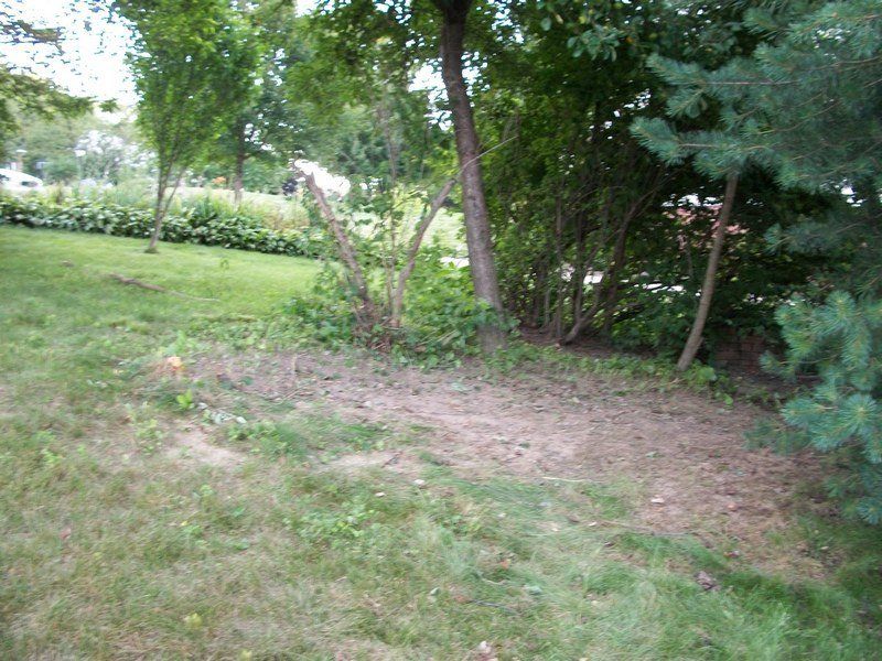

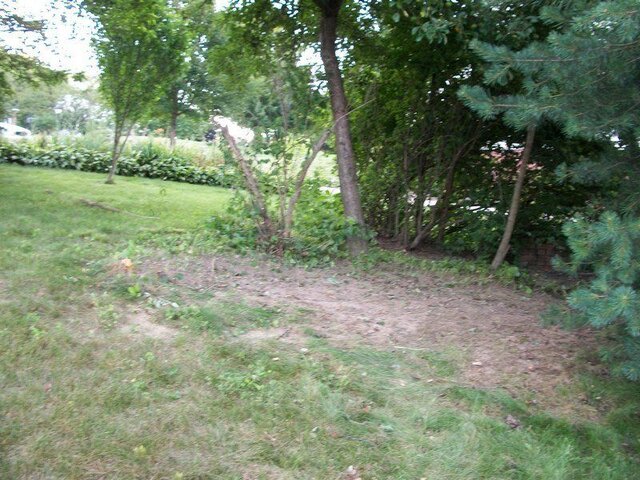

This week I'm installing an 8' C band dish in the backyard. I had the same problem with my wife. I either had to install it where I had wanted with a perfect view, but install a partial fence around it or install it near trees as shown in the picture. I still will see most of the arc, but might need to trim a few trees to see others.

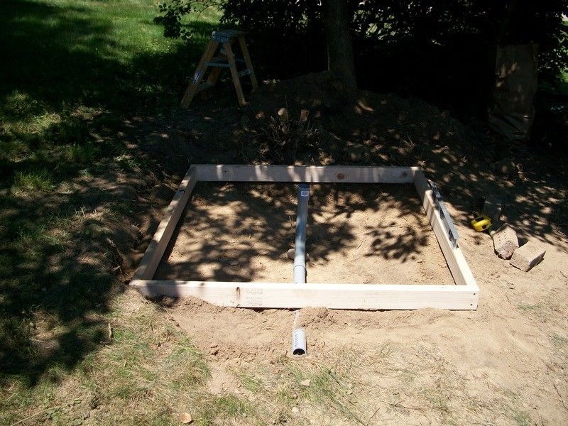

We had a 10ft'r mounted on a flatbed trailer (car hauler) for rentals way back when. same mount as I have still today on a floating slab. see pics for ideas here http://www.satelliteguys.us/free-air-fta-discussion/214870-concrete-pad-8-dish.html#post2216052 The 3 bolt base allows plumbing the pole. We'd put wood or cement blocks under the rear lip of the trailer, then lift the tongue with the jack till weight was removed from the axles, and fairly level. then plumb the pole with the base adjustments, tune it up. usually only took about a half hour.
