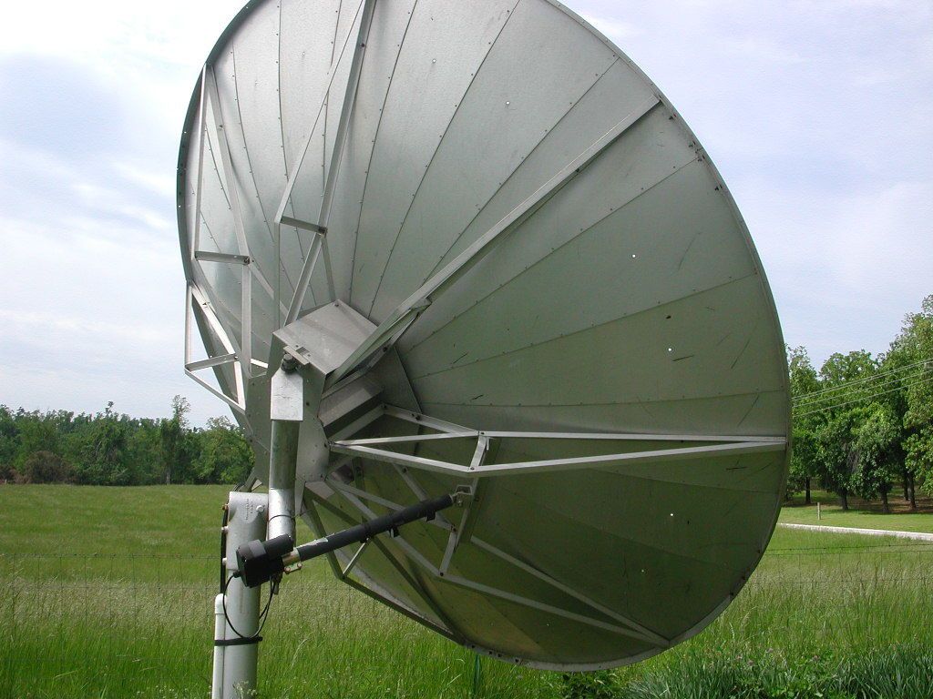

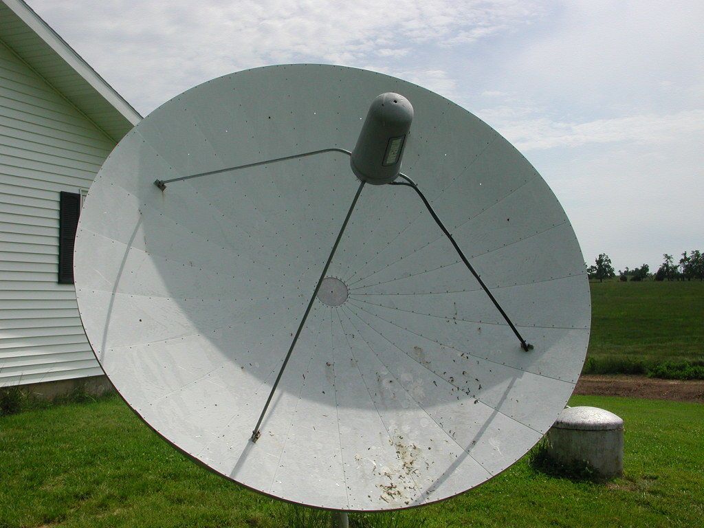

10' "Drake" Solid info?
I posted these pics a while back (maybe in one of the "Dish Hunting" threads?) and don't remember getting much feedback, but now I have found one of these and wondered if anyone has any knowledge or info on this brand/model of dish?
I was told it was sold as a "Drake", there was an old Curtis-Mathes tv dealer in town that sold them back in the 80s-90s.

As far as I know Drake never made dishes just the receivers. I looked at the LNB cover and it says Winegard but it doesn't look like any Winegard that I ever saw. I just can't tell you who made that dish.

thanks whatchel1, that is what I thought also. :)
The pics I posted are of a different (but basically identical to the one I looked at today, as far as I can tell) dish, when I spoke to those people they also told me it was a "Drake", and they bought it from the same dealer.
They look to be very well made and, to my eye at least, have a nice parabolic shape. The mount looks a little wacky but I bet I can figure it out. ;)

One odd thing I noticed about todays (and the one I posted the pics of) is the "petals" are riveted to each other, not bolted together like the one you found. Unless there is a way that I couldn't see to take it apart, I am going to have to haul it in one piece.
Pretty sure it was delivered to the site in one piece and mounted......or it was hand-assembled and riveted together on-site! :eek:

Looks like a commercial dish, maybe Scientific Atlanta? Might be a Drake also...
It does have that "commercial" look to it, Tron, although the feed supports look pretty flimsy to me, they appear to be 1/2"-3/4" EMT?

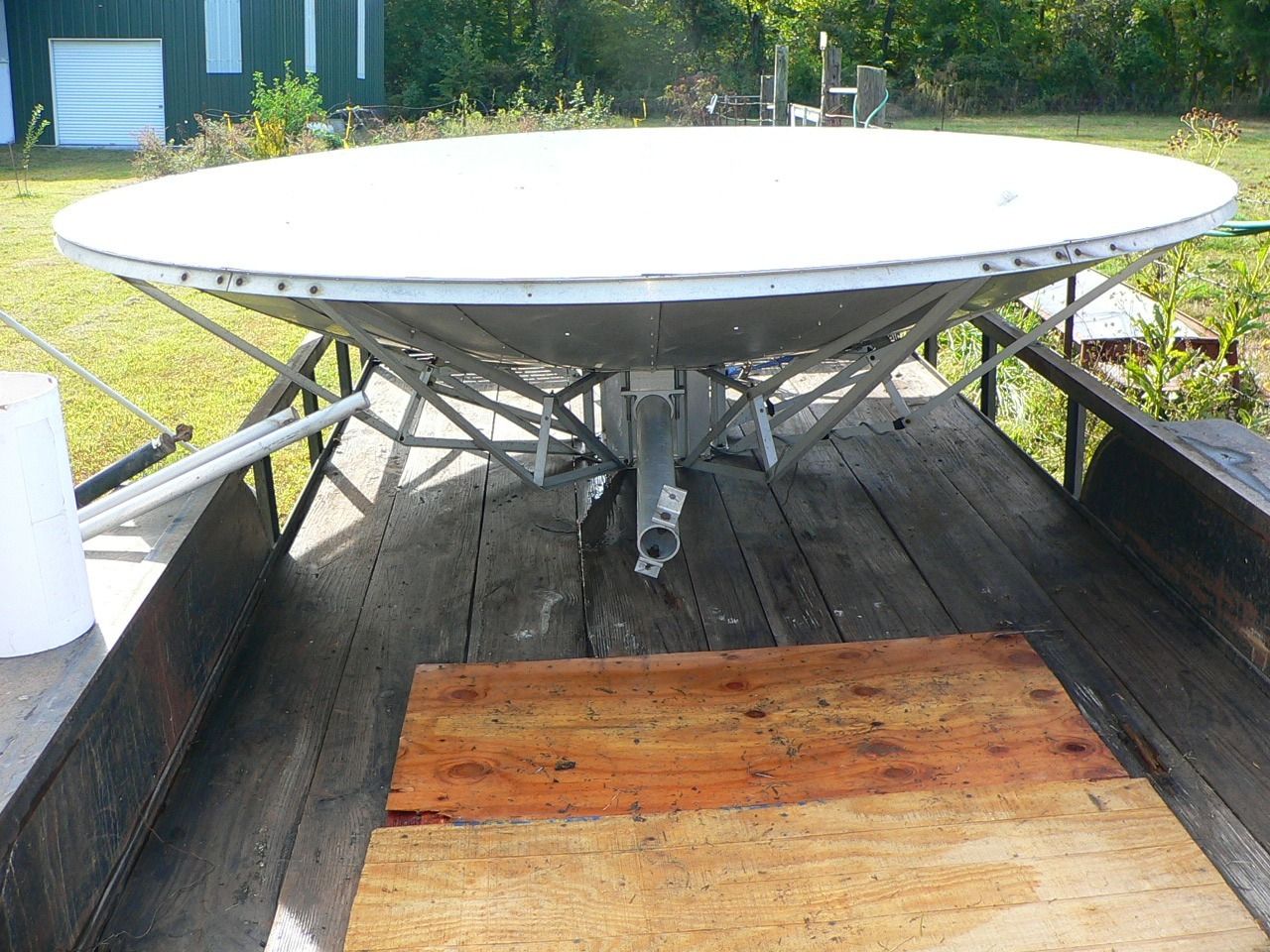

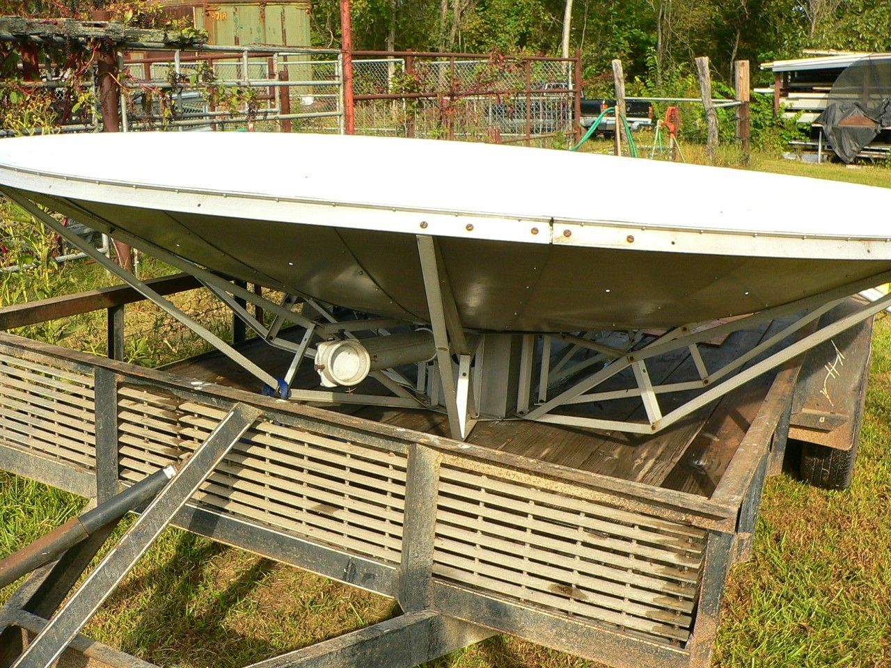

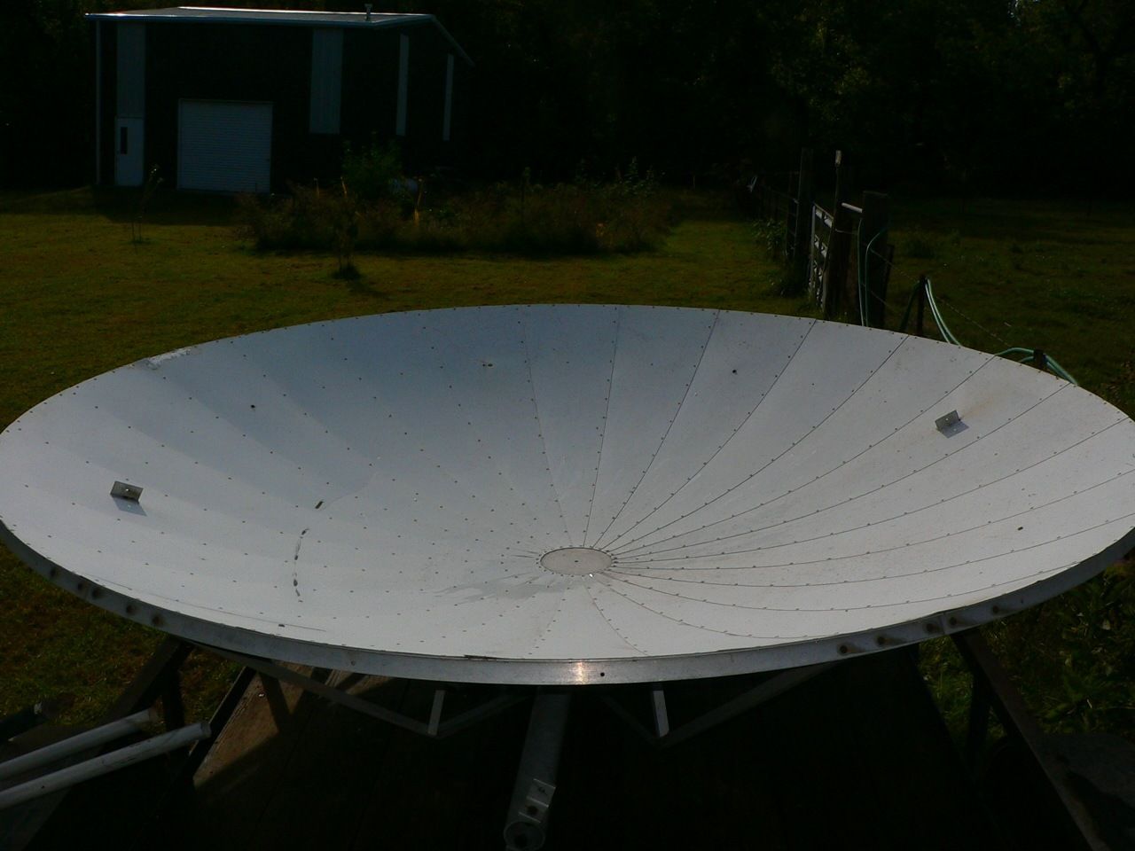

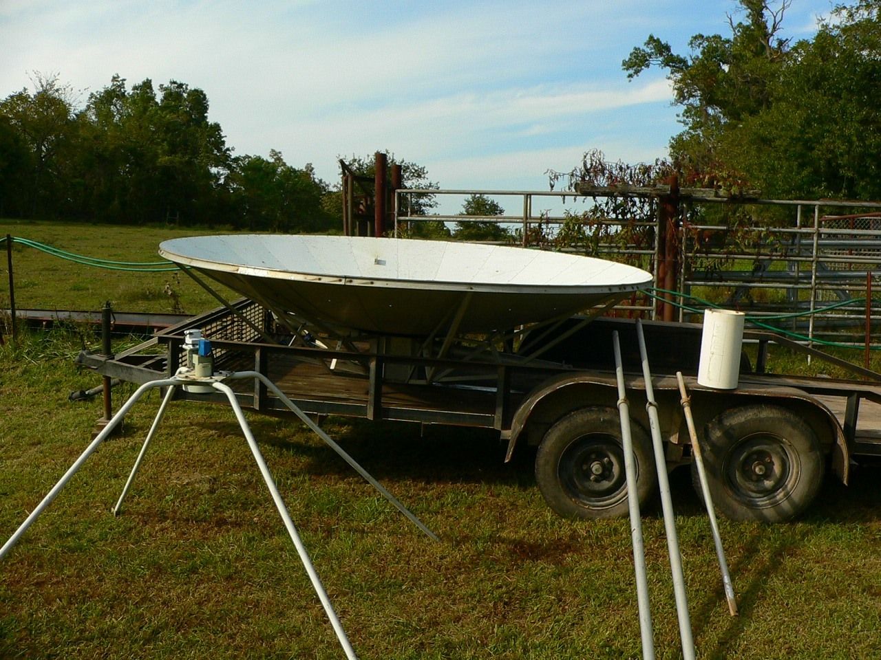

Got the "Drake" 10 footer home today. Still don't know what brand of dish this is but it says Drake on the LNB cover.
I'm sure that's why the 2 people I have spoken with that have these called them Drakes....and maybe they got a Drake receiver when they first bought them?
Anyway, this dish is in excellent condition, passed the string test with flying colors, and is very well built.

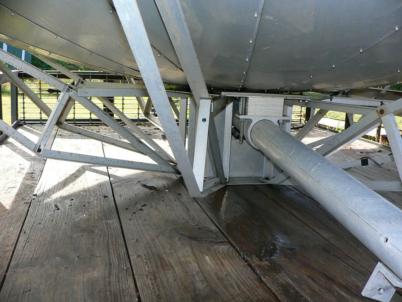

That being said, at this point I don't have a good feel for how this mount works yet. I can see where that main pivot that runs through the center of the back of the dish, sits on top of a 3 1/2" OD ground-mounted pipe.

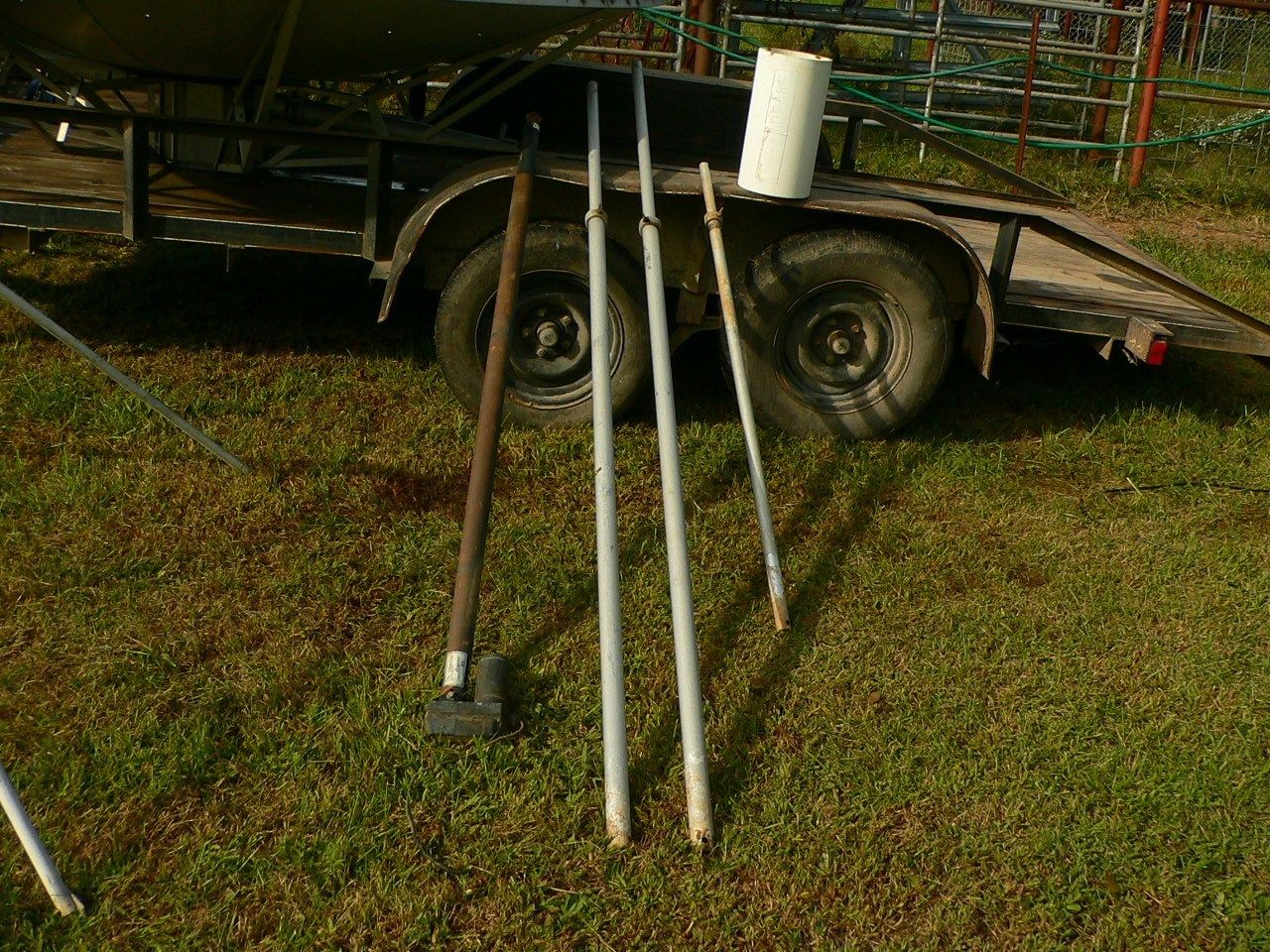

Then I am guessing that the main pivot pipe is set for my elevation, but dont know what carries the top end of the pipe, maybe those telescoping aluminum arms that you can see laying against the trailer?
You can see a stack of shims on the "top" end of that main pivot bracket, I am assuming those accomplish the declination offset, and since this dish was set up not too far from here, should be fairly close, if not I can add/remove shims to dial it in.
Then there is that monster actuator, which I am pretty sure attached to a pivot point on the ground.

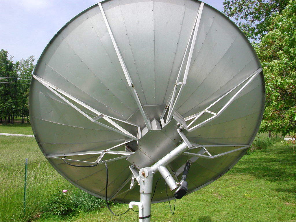

You can see this exact same dish in the first post in this thread, but it has a different mount and actuator setup. I know where there are 2-3 more of these dishes but I don't think any of them have the same mount/actuator as mine.
This one is going to be a challenge, but should be well worth it if I can figure it out. If anyone has any thoughts, pics or info on this setup please post them here. :)

How far away from you was it? Unless it was over 75 miles to the N or S of you don't need to mess with the shims; it will be close enough. The actuator is a 52 " Thompson Saginaw arm those were rare. The pipe you are referring to is a 3 " schedule 40 pipe. Bought so many of those I will never forget what they are called.
The last time it was set up it was about 20 miles north of me. Will have to see how it tracks (if I ever figure out how to mount it), shimming that was "good enough" for analog C-band back in the day, may not be accurate enough for digital C/Ku now.
And that actuator is a Venture brand, not sure what the length is, but I just cleaned it up a little and hooked it to 12V, it purrs like a kitten. :cool:

I did commercial C/Ku and the commercial stuff already digital back then. But if it was just for C only which is possible there may be a small diff but that will only be found out after you have it up and tracking.
