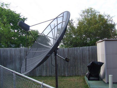

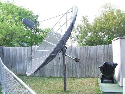

was wanting to know who makes this dish and if $150 is to much for it, found it on a local craigslist and it comes with a Toshiba receiver, considering whether or not to get it and looking for some of the experts insight

i much prefer free but if in your area they are hard to find then they might cost you a little .... if the dish looks like its in good shape ( and this one does ) and actuator in good shape look or ask what type of feedhorn if its a c/ku corotor then the dish is probably worth it...... i wouldn't be beyond paying something for it .... but they are plentiful here so i've been lucky ( but only a few with a c/ku corotor). the toshiba is a analog receiver and dish mover , going price is usually shipping ( which can be expensive plus a few $$ ) so you can probably get quite a few receivers ( analog) off ebay for a few bux + shipping & handling.
good luck
i emailed the owner to see if he was willing to give it away or was wanting $150 from the post it sounds like a c band only no ku, to get start in C band does one need a c/ ku feed horn?
You can get C-band analog and digital (if you have the receivers) with a C-band only LNB/feedhorn.

It all looks good too from what I can see. Can you get a good photo of it from behind to see the mount. Sometimes you will see a little label on the back of the ribs. The actuator looks graet too!!Truckracer says it looks like a sami dish or KTI, both are real good. To me it looks like a Unimesh from the side. The mount may reveal more. I think you got a great find and you also have a reciever to go along with it too. Not bad!

That is 100% a 10ft Unimash Dish.
$150 for the dish is not bad a new one is over $650 plus $200 for shipping.

Mesh is OK for Ku, as long as it is rated for it. You should be fine, I believe the Rule is :
"as long as a #2 Pencil does not fit through the mesh"
My mesh gets super strong KU signals. Don't let the mesh discourage you. I know a solid is better for ku but mesh is still a strong performer.
My PBS feeds on AMC-3 KU peg the meter including montana PBS.
