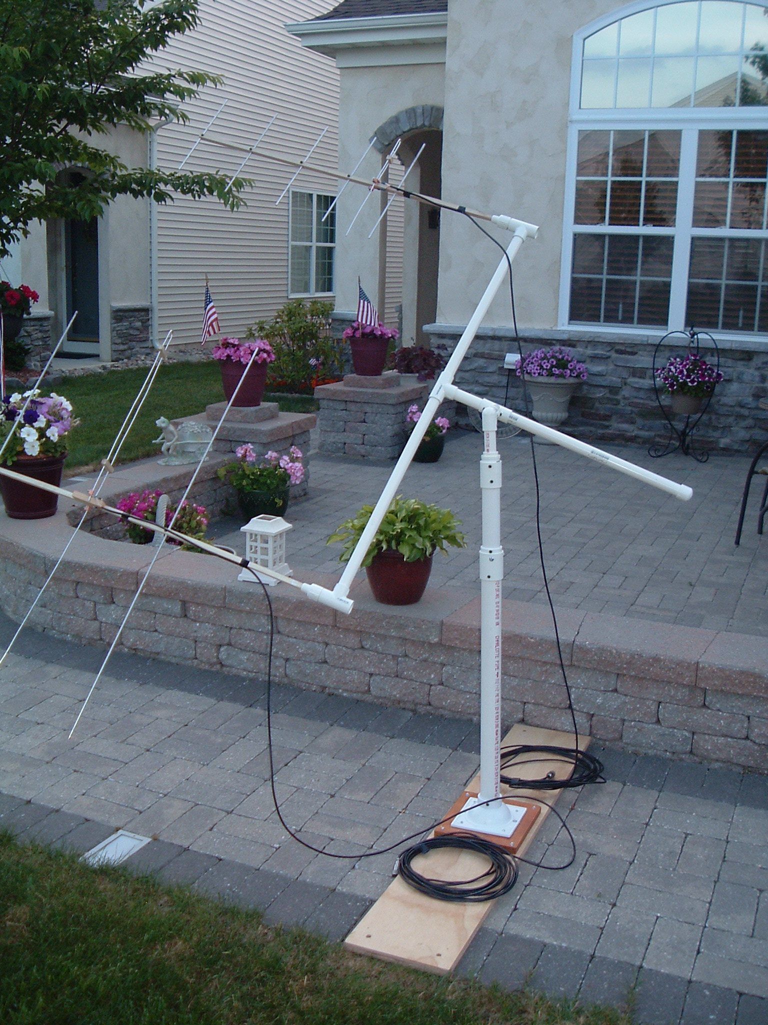

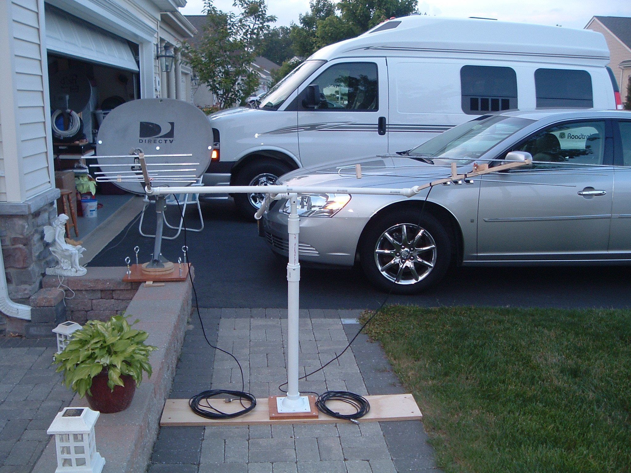

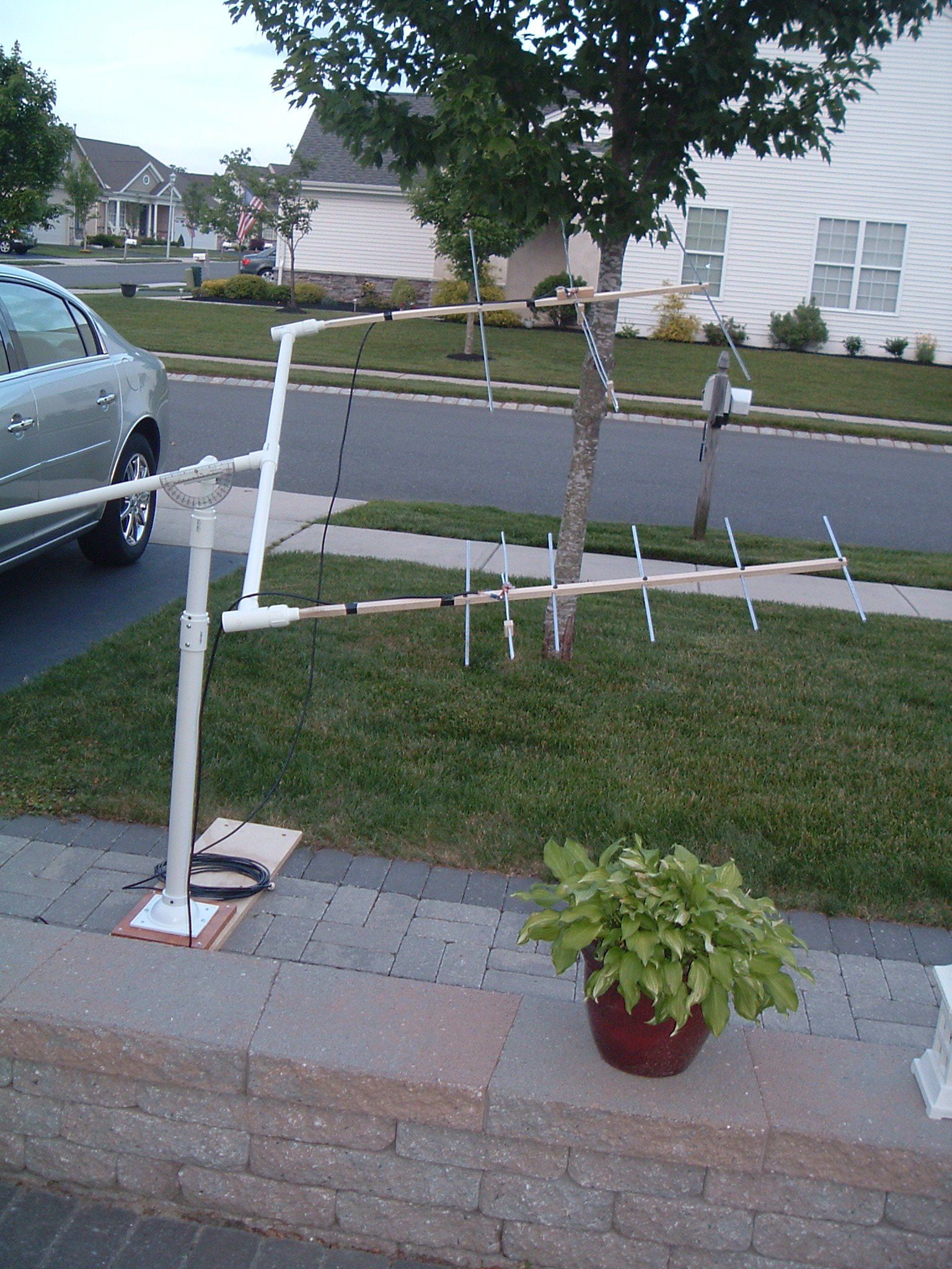

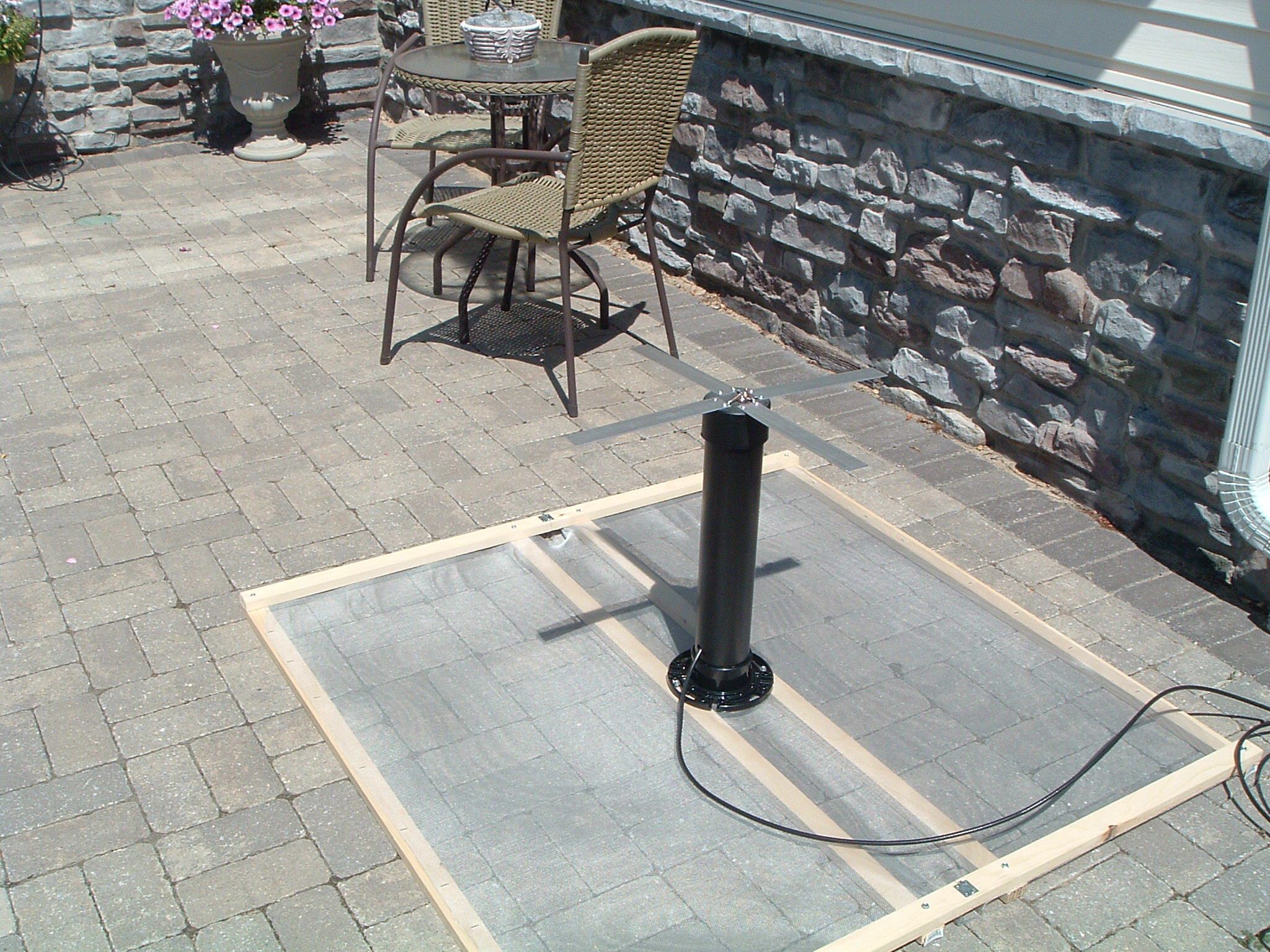

I am helping out with lunch duties and will be trying to make a Ham Radio Satellite contact. See pics of the AZ/EL and polarity changing mount, with a light weight 3-element 2 meter yagi antenna and a 6-element 70 cm yagi antenna I made. I also made an X-wing UHF right hand circular polarized satellite antenna.

Interesting creations! I know nothing about amateur radio but it looks like fun. That last antenna, I guess is the x-wing, is strange looking though. Let us know if you pick up anything on it.
Yes that is the X-wing antenna, I am trying to get milcom on my bearcat scanner. I did copy the Brazilian Priates as of yesterday, check out this story.

Your right I sent an e-mail to Mike Frye the author and designer of the X-wing and he did mention that mil-satcom fm is very rare, here is his quote:
"Satcom signals in the clear are a bit rare but take a listen to 255.555MHz NBFM in the afternoon and early evening time for Brazilian pirates, they seem to use this frequency a lot.
These are wide band data carriers and are best detected in AM mode. As you tune across them you can hear a definite change in the background hiss. I used several of these carriers with a spectrum analyzer when comparing the X-wing gain to other antennas."
You guessed why we don't hear the military, I am going to find one of those digital computer programs that can do ALE (Automatic Link Establishment) so I can copy some milcom.
