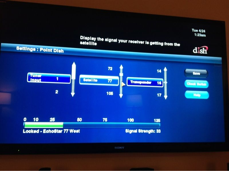

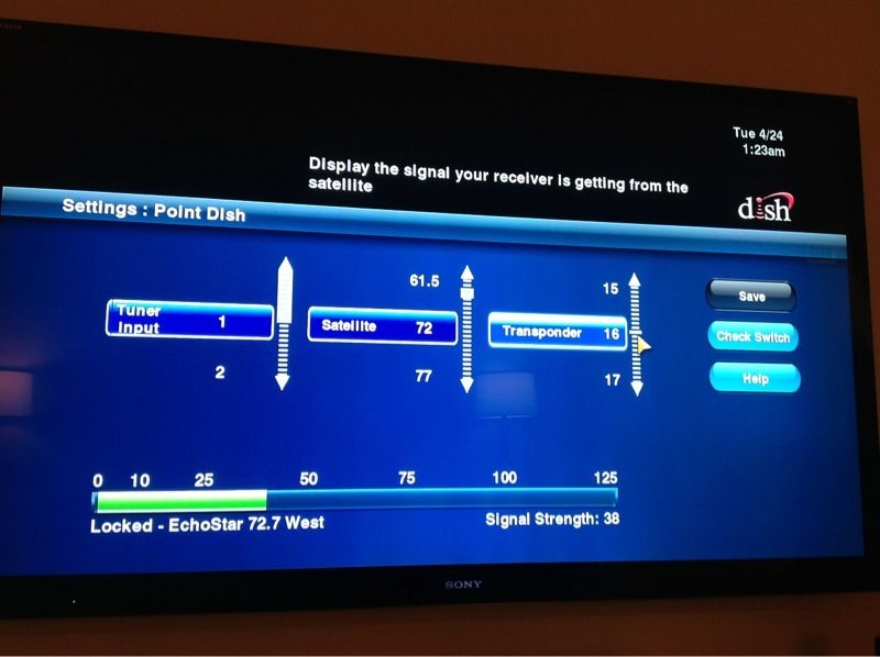

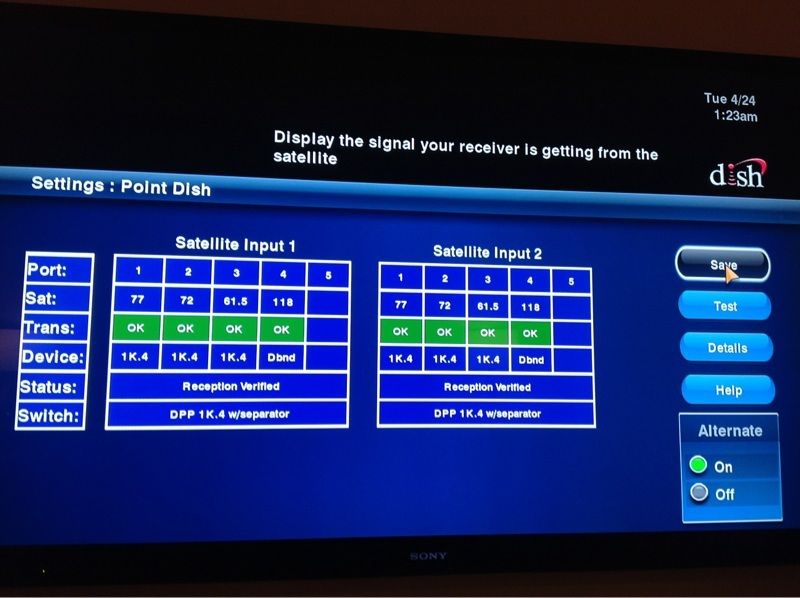

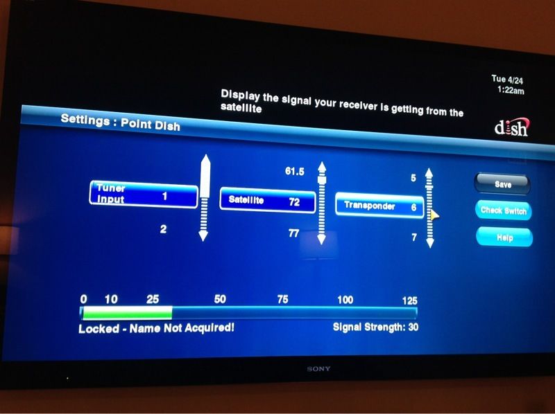

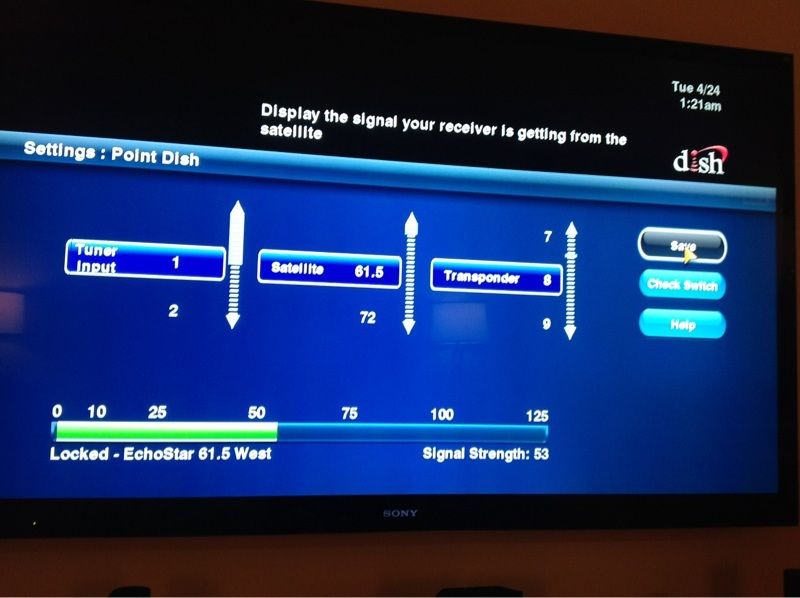

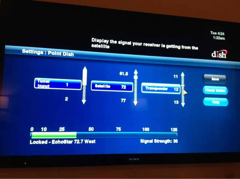

I am using the Eastern Arc dish 1000.4 out in the west coast in Los Angeles. The signal strength are as follows.
72.7 TP 6 (Weakest) about 28 on Cloudy Day and 29-30 Max at best
72.7 TP 18 (second weakest) about 30
72.7 TP 16 (Strongest) about 37
61.5 comes in at 45's at lowest on most TP's and upto 55's on others
77 is at about 28-32 on most TP's
I had the eastern arc on 1000.2 earlier as the installer didn't know what he was doing. Out here on the west coast they don't install the EA arch for obvious reasons. Signal levels on the 1000.2 was in the 15's on TP6 (72.7) and would go out on a cloudy day. the 1000.4 is much stable.
My observances are that if I peak 72.7 to 40's, I totally loose 61.5 where the Local DMA's are. When 61.5 starts to come in, 72.7 signals have already reached on its 30's. I didn't bother to tweak anything on 77 but it came in at 30's as well.

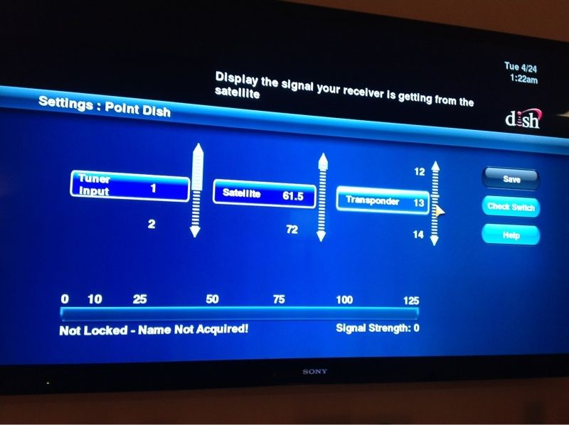

I'm in Los Angeles and don't even get a wink of signal on TP13. Is it because its a spotbeam not meant for the west coast. In that case the other spots shouldn't come in as well right.
My signal levels
I meant that question for 46FD04 since he is in Toronto. I know it won't reach California
