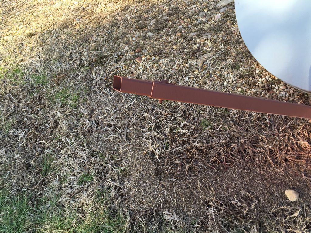

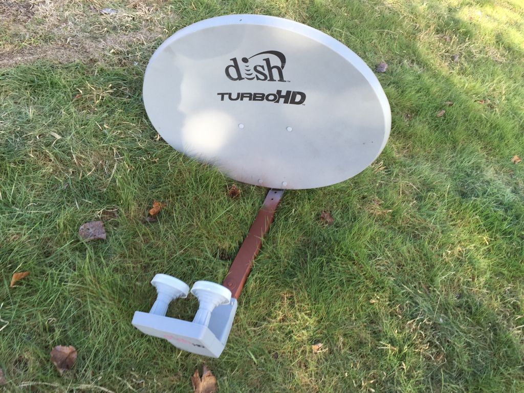

I am not sure if anyone else has posted anything like this before or not. I prefer the 1000.4 dish to the 1000.2. Since I am going to have to go back to one dish from three for the DPH LNBF, I got to thinking about how to convert the 1000.4 to where the yoke and LNBF that works on the 1000.2 would work on the 1000.4. The arm of the 1000.2 will fit into the arm of the 1000.4. What I did was, was to cut off about 8" or so of the arm of an old original Dish 1000 that I had laying around. I had to drill two holes through one end for the little tabs on the 1000.2 yoke to go through. After that, I shortened the end of the 1000.4 arm so that it was about 17" long (cut off 2") and left 2" of the old 1000 arm sticking out, this kept the length of the arm 19" which should keep the focal distance the same as it was on the 1000.4. I have not had time to try it out yet, and my DPH LNBF hasn't arrived yet. I will update this thread, and try not the 1000.2 and modified 1000.4 on the WA to see what the difference in signal strength is, if any. Note, the red primer on the arm is only temporary. I didn't want it to rust so, all I could find was red primer to cover where I had cut. Not sure if I'll paint the dish black or leave it gray.

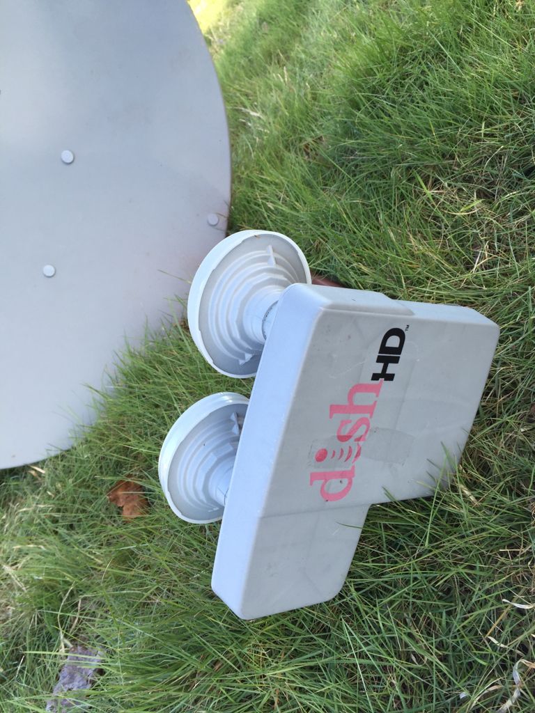

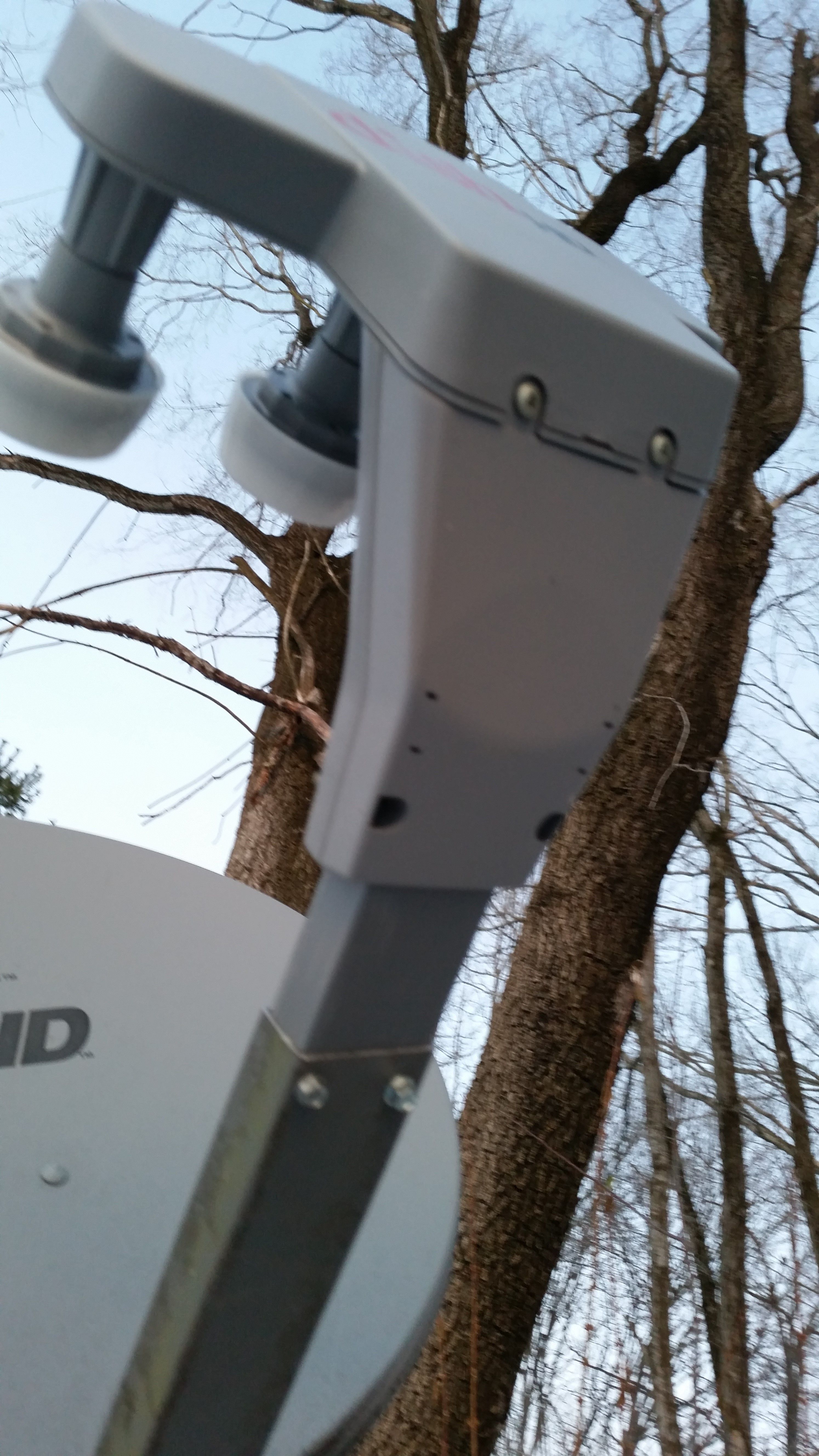

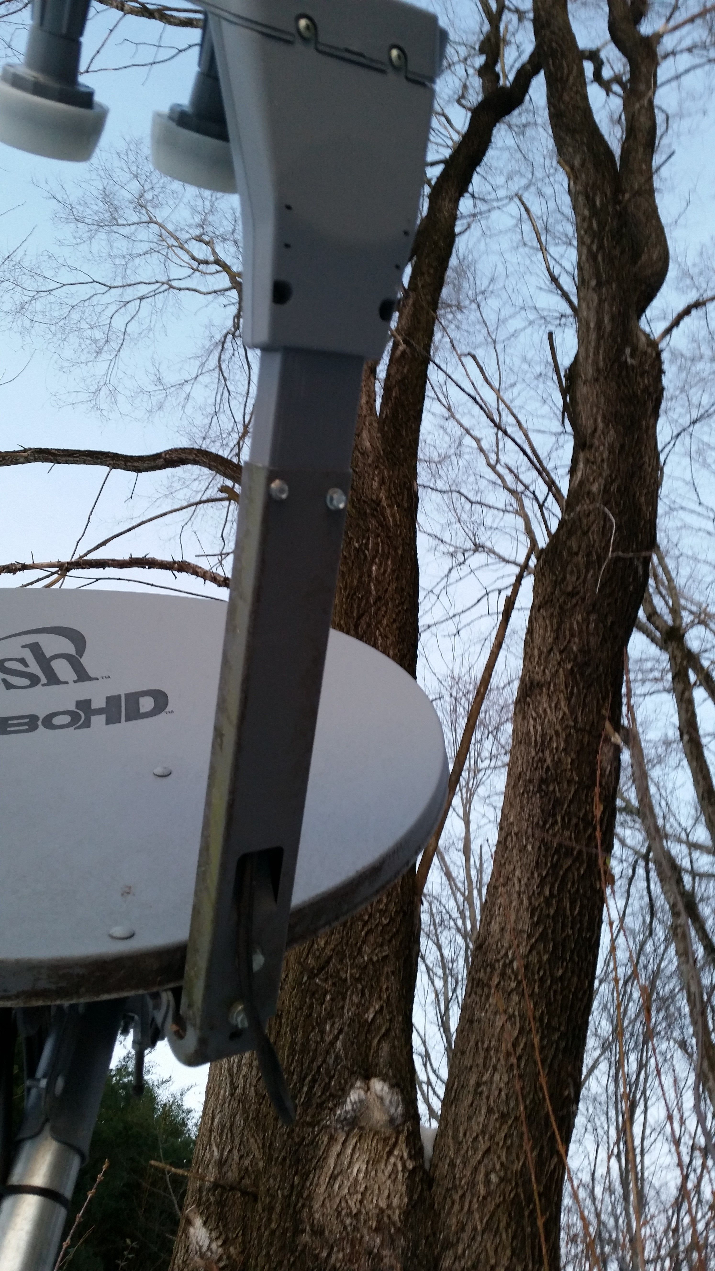

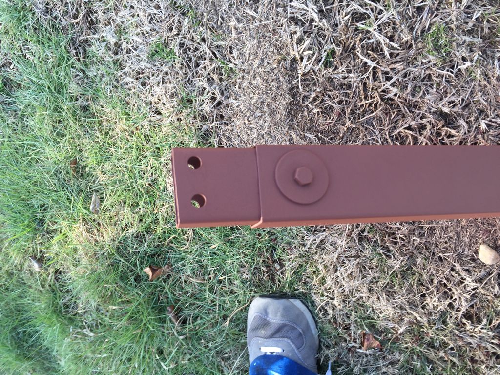

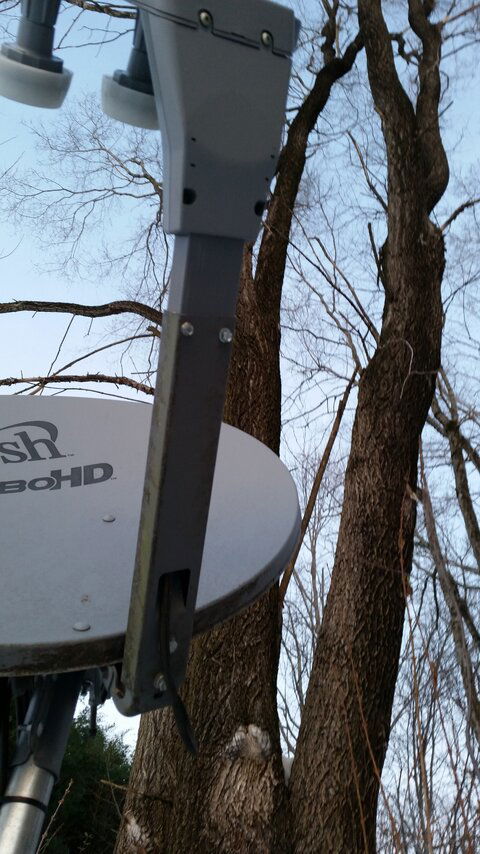

I did my conversion this afternoon from a 1k4 wa lnb to a 1k2 wa lnb on a 1000.4 dish.
It was pretty simple to fit the hardware but was aggravating regarding signal. At 1st I just went back and forth from the dish to the tv checking signal. After about 3 trips I thought you dummy why don't you just grab your super buddy.
Without a doubt I don't believe I could of done it without a meter. The focal point is further in towards the dish than what you would think. I don't recall exactly but want to say around 2" closer compared to the original arm. The elevation had to drop a little also. The azimuth didn't make any difference and did not mess with the tilt.
Am a little disappointed that I couldn't match the same signal or better, but think they are a tad better than a 1k2 dish. I may put up a 1k2 to compare to this rig.
Here's what I ended up with:
1k4 WA lnb
110 TP 11 signal 69 TP 18 signal 68
119 TP 11 signal 72 TP 18 signal 75
129 TP 11 signal 46 TP 18 signal 57
1k2 WA lnb
110 TP 11 signal 71 TP 18 signal 67
119 TP 11 signal 67 TP 18 signal 65
129 TP 11 signal 41 TP 18 signal 53
Thanks bobvick for the idea.

The 1000.2 arm will fit inside the 1000.4 arm, you have to cut the 1000.4 arm and a piece of the 1000.2 arm and insert it inside the 1000.4, you need to keep the length to 19". A SuperBuddy will run you probably around $300-$400 off or eBay.

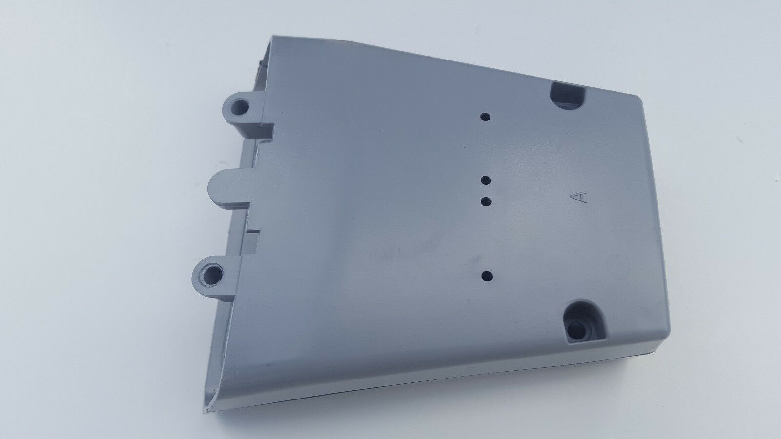

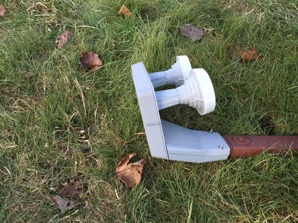

There are two easy ways to keep using your 1000.4 dish with Hopper 3. The "no mod" way would be to use your existing DPP LNB with the addition of a DPH42 switch that basically converts the LNB output to the hybrid format the H3 needs. A downstream Solo or Duo Node would also need to be swapped for a compatible hub.

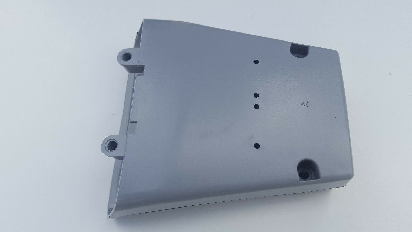

The other option would be to use a standard hybrid LNB (not the newer Slimline LNB) with a modified plastic adapter. The mod takes just a couple of minutes with a utility knife or other cutting tool. The photos below show the simple adapter mod before and after. If you're swapping LNB's on an existing aimed dish, some minor repointing will be needed to peak the signals.
Here's the standard 1K4 adapter:
And here's the modified 1K4 adapter:
That's a pretty simple adapt!
