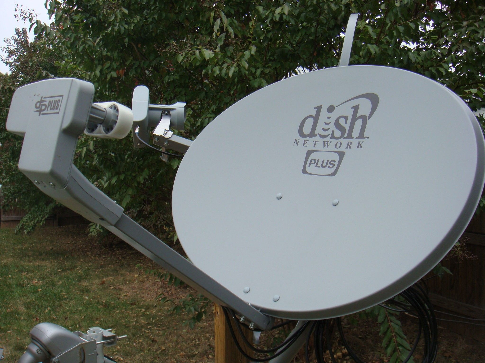

I had an extra "plus" dish in the shed and figured I'd give the 1000.5 setup a try. So far I've seen signal on 61.5 go up a little and 10-15 point increases on 72 and 77. Makes me wonder just how far out of alignment my 1000.4 was! I have before and after readings if anyone is interested. And thank you to all for all the valuable info found here!!!

I changed my .4 into a .5 last week. I didn't get a huge increase in SS, but I'm sure the larger reflector will be better overall, kinda like increasing the amps so to speak. All of my signals went up 3 or 4 points. Like you, I had a plus dish laying around and decided to give it a shot. :)

I took the readings this morning before I changed the dish. The .4 must have been screwed up. The lowest reading on 72.7 is now 66 on tp15 and the highest is 75 on tps 17 and 21.
Dahenny, you are the reason I decided to try it! Thanks for the info in your previous posts earlier this year. The true test will be the rain coming tomorrow.

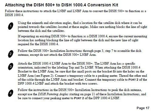

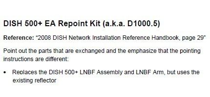

Here's two snapshots of two separate E* pdf's :
Couldn't you just change out the dish pan of the 1000.4 sat dish itself with the Dish plus pan? If the bolts are in the same spot, which they look like they are, it wouldn't be hard to do that.
In the boxes of junk I have, the lnbf arm is packed with the skew plate. And like you said, the bolt pattern is different between the two reflectors. The bottom holes line up, but the top ones are about an inch off. I suppose drilling the top two to accomodate the .4 skew plate wouldn't be too much of a chore.
