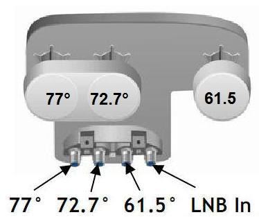

P.S. make sure that you're using the 1000.2 settings, because dishpointer does not show a 1000.4 WA. Are you sure that your lnb is WA? WA = 3 evenly spaced lnb's, EA = 2 lnb's close together, with a third one off to itself.

Just make sure you have the right LNB. Should look like the pic below.
