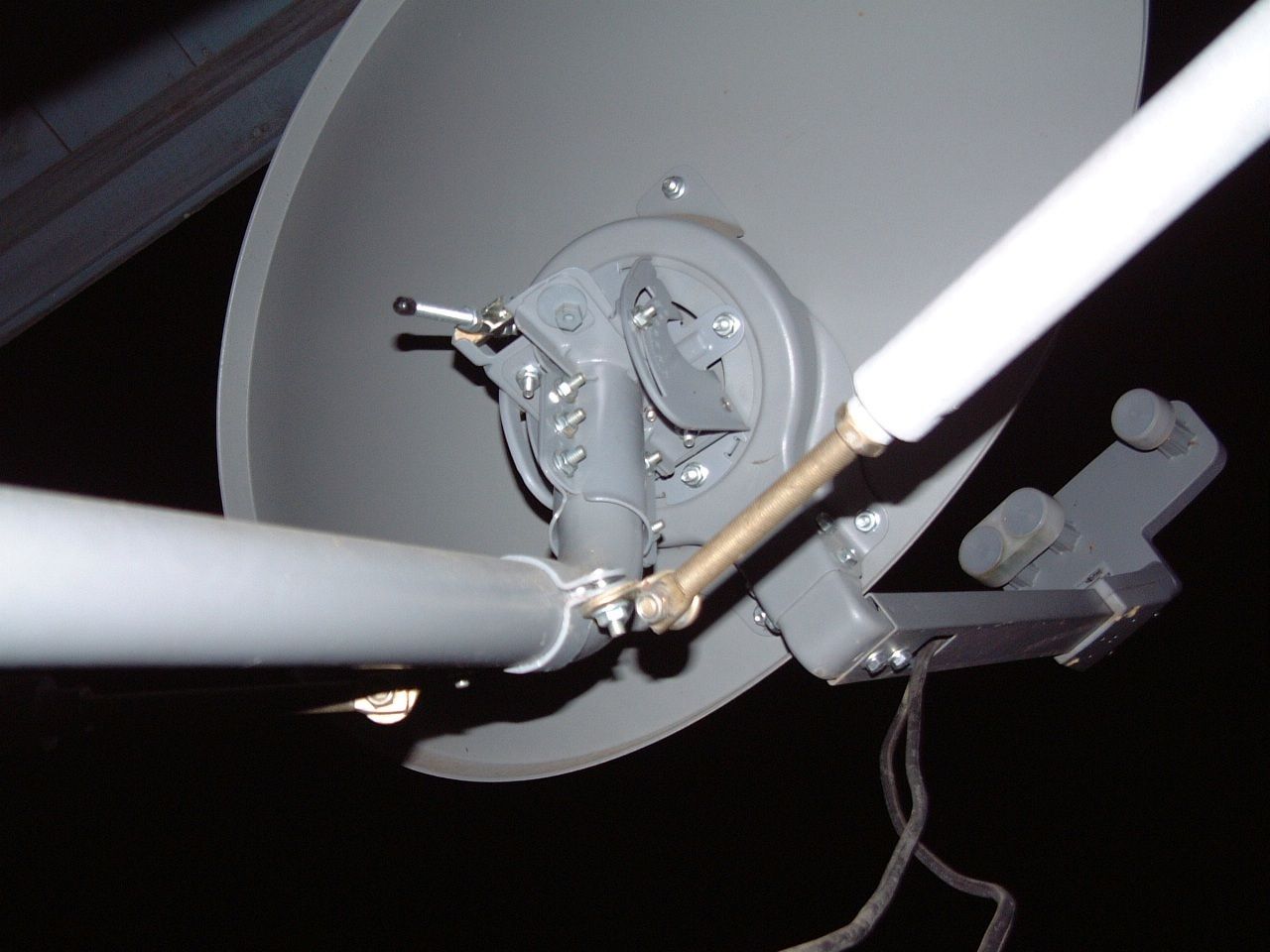

Okay I was bored and decided to take my 2nd 1000+ International dish Reflector and 1000.4 EA and make the 1000.5
Of course the only parts from the 1.4k I could use was the Mast , LNB, LNB Feed arm.
I had to use the Skew and Elevation mount from the 1000+
Now I could have used the LNB feed arm from the 1K plus dish which was also about 2 inches longer, but it would need some small mods in order to use the Plastic LNB holder on the feed arm.
And a Notch cut in it for the wires to the LNB.
But saving that for the future test.
But the result was another 4-7 point again across the 61.5 another 3-5 across the board on the 72.
So my next test will be to see if those numbers will increase or decrease with the longer feed arm .
But here are a few pics.
Sorry it was dark when I finished.
Rain Fade should be greatly reduced, soon I'll try with a 1000.2 EA LNB and see what results it yields.

And I had my first rain fade comparison between the EA2 and 1.5K and let me say I was quite impressed.
The EA2 went out totally on the 61.5, and the 1.5k never went out just some minor pixel-ing at the peak of the storm the other night.
Signal level was 28 on 1.5K, 72 was 30.
EA2 was complete signal loss across the board.
Now with that in mind, since the plus dish almost went out, there is no doubt in my mind that the EA 1.4k would have definitely went out as well.
So if I had to compare the EA2 vs the 1.4k I wouldn't waste any money on making a swap between those thinking you are going to drastically improve the signal.
They are basically the same very minor difference.
But I can confirm the 1.5k does in fact with stand a bit more rain fade.
Especially on the 61.5 where most of your local weather emergency services come from.
