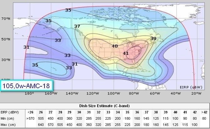

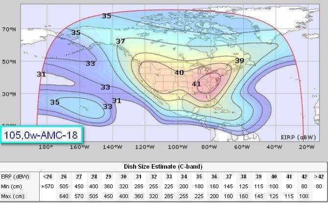

If interestingly card on 105,0w AMC 18, with the sizes Dish.
8' dish gets NASA ok but not much signal headroom. Snow loading, wind, slight mis-alignment and signal is gone. The 4000MHz TP is not really that strong, never more than 90% even on the 10' dish. NBC has a better signal. Not sure about "dvids"... Think I remember seeing something like that on 91 a few months ago. Gone now.
