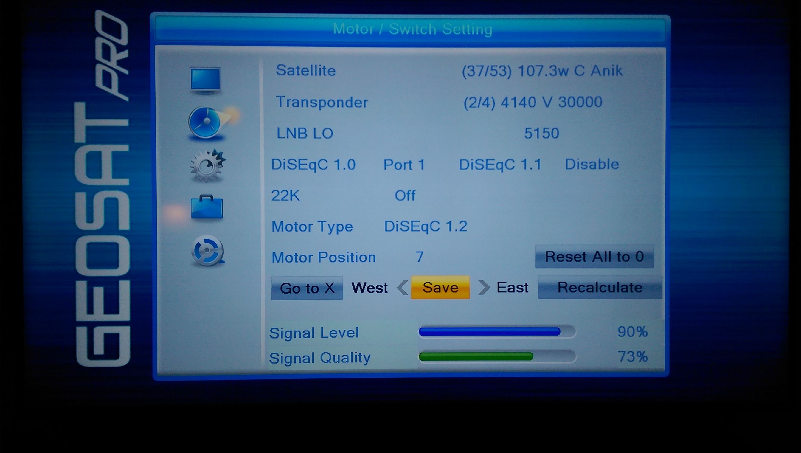

73% Signal Quality and I have a 6 foot prime focus solid dish and ALSO the GeoSat Pro MicroHD. Sorry I'm late to the party but just wanted to chime in since I have a 6' dish (SD180PM to be exact) like you and the same receiver.

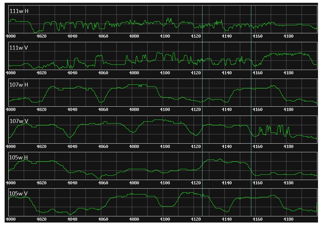

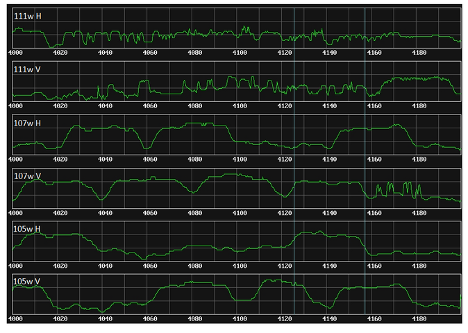

I took a look at 105, 107.3 and 111.1 W with a spectrum analyzer. Nothing really jumps out at me as a problem as far as adjacent satellite interference goes. See what you think in the attached image.
I looked at both V and H as I've seen some indication that side lobes can pick up some of the opposite polarity, that the main beam won't.
There is a strong 4140 signal at 105, but it is horizontal. 111.1 doesn't look like it would be a problem, so maybe bump your dish a bit west? Also, if it was me, I might try turning the skew a bit one way, than the other. Also move the focus in, maybe 1/2 inch and try that. Probably stuff you have already tried.
I don't have any experience with 6 foot dishes, so don't know what the side lobe performance is like.
