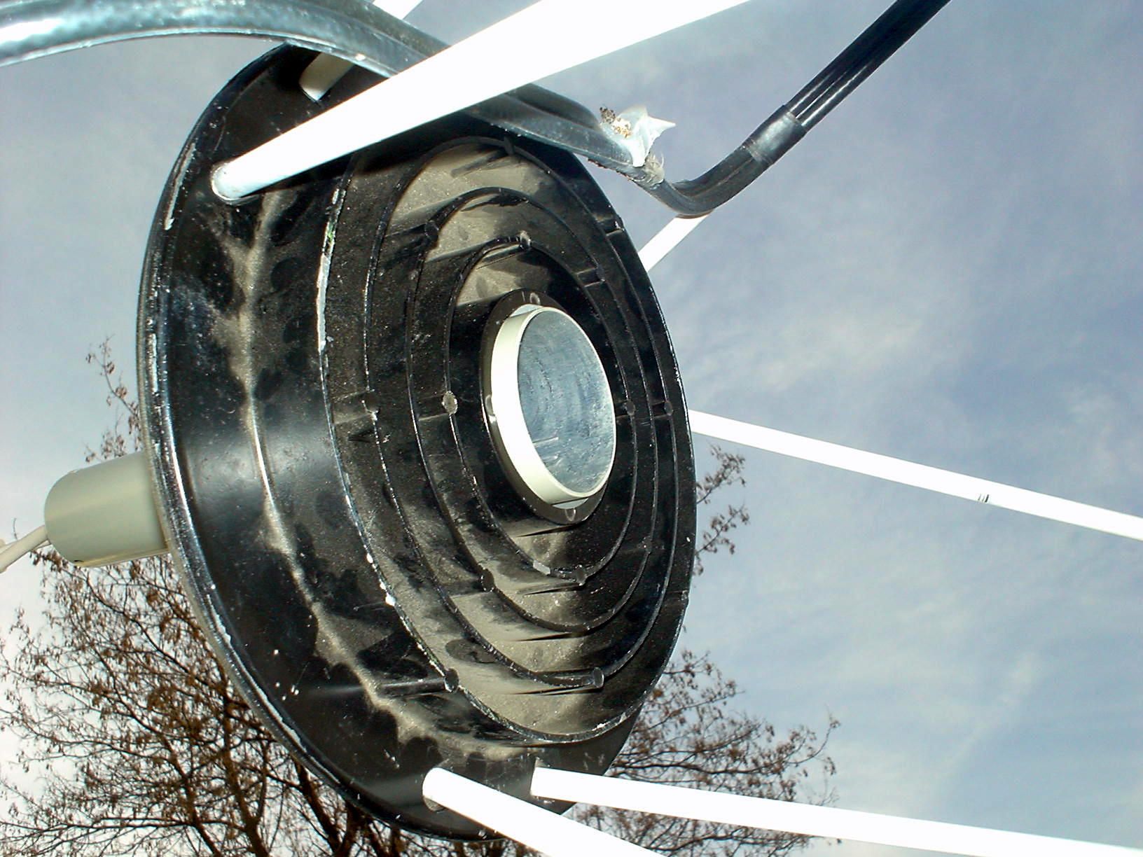

I recently took a project I had on the back burner off the shelf this past weekend and started fixing my old Birdview Dish. Hooked up a Reed Sensor to it and a GBox3000 redid the wiring and hooked the drive motor up to it and the dish is tracking like a beauty automatically now with the motor box. Next Question now is I took the original Lnb mount and made the circle wider and filed the old scalar down so I can mount a new one onto that plate. I even power washed the dirt and moss growing on the dish off looks almost brand new now.

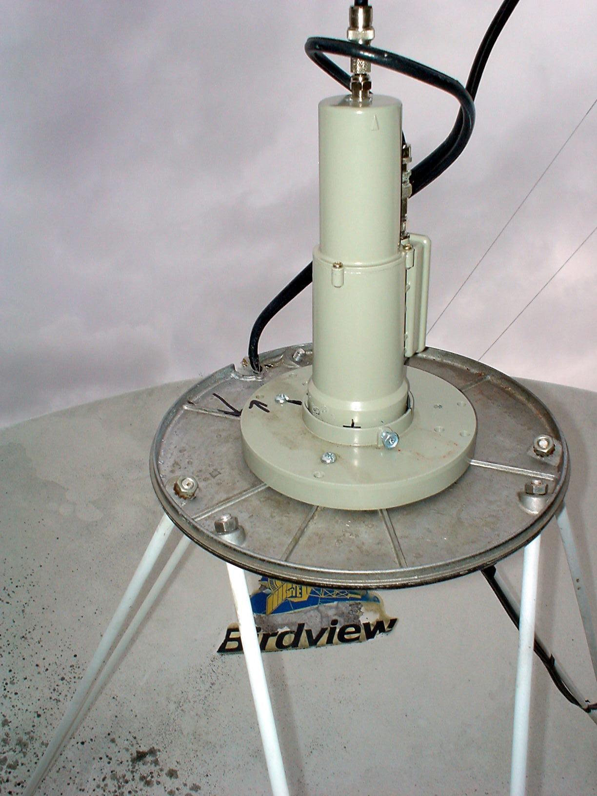

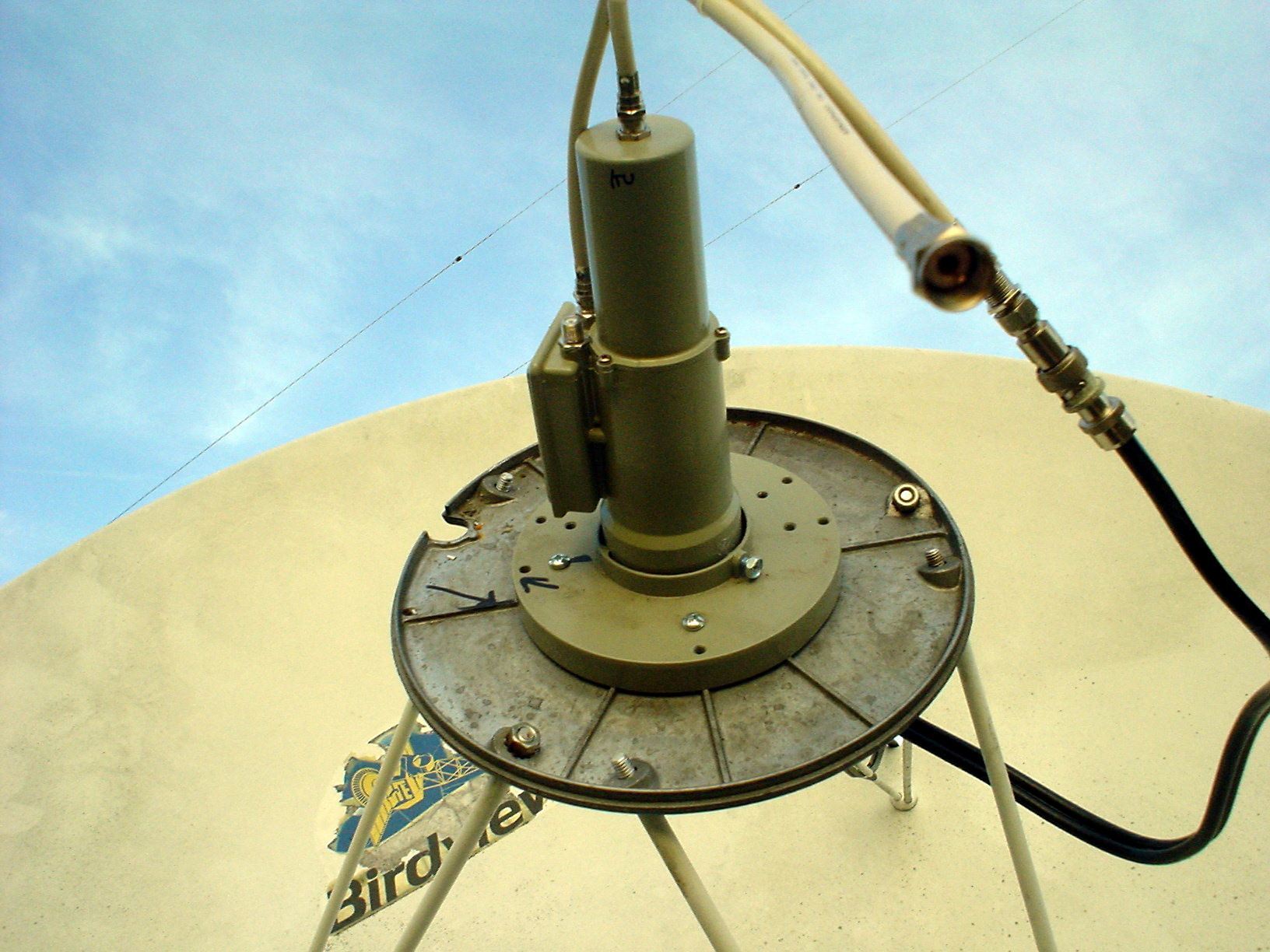

Most any of the modern LNBF's will do you well! I've got two BV's going, one stationary for W-5 on subscription, and one on a G-box and have had (3) different FTA receivers on it! The plates that come with the new LNBF's seem to match up perfectly with your BV original bolt holes, just make sure to get the proper bolt to put in! (and by all means....WATERPROOF your LNB and connections somehow--Today's LNBF's aren't built like the BV ones were of the 1980's!
Pictures attached. May help you see approximately where to put your LNBF, biggest thing being polarity by turning it until its at its best! Mine, by no means is perfect, but she works well! Another member mentioned in my signature line also has modified his BV successfully and had GREAT results, too!
Used to sell BV, but I never sold a 10 foot, only the 8-plus's. If you really have the 10, its "rare" even in the BV collector's world!

Radio of the pictures you've posted that's how the original mounting bracket looks like that I am using I just took the center circle and made it wide so I can stick the lnbf itself into it to adjust the focal point better. Will attach and older picture of the dish before I cleaned it up will attach a new one later.

You should be in GREAT shape, then for ANY LNBF of today. Use the supplied ring, bolt it to the BV's original plate, and experiment! And, by all means, ASK questions! We're all glad to help!

ya the one thing i did that i noticed you did diffrently on the mounting plate i filed the scalar rings down flat so i can use the newer ones from the new lnbf but i also made that circle wider so the lnbf and fit through the hole as well. .. i also made the four holes that way so i can mount a newer cover on top of the lnbf from the weather :) so right now all i need now is just those two things to get this bird up and running again
