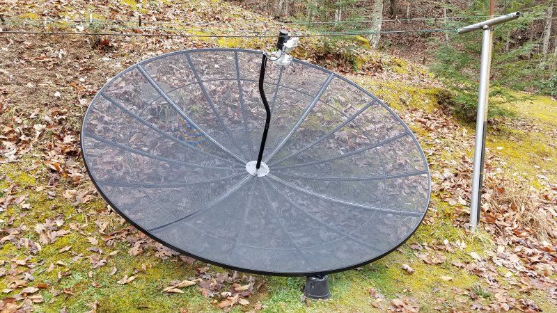

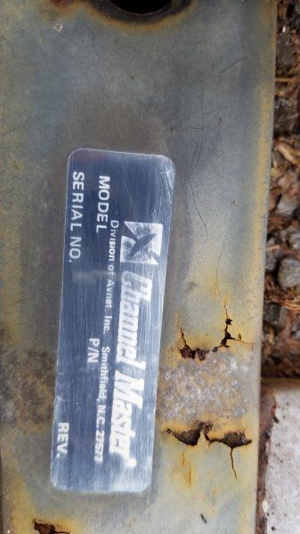

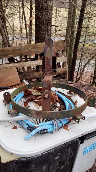

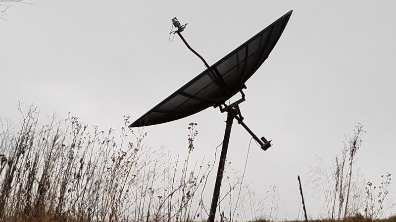

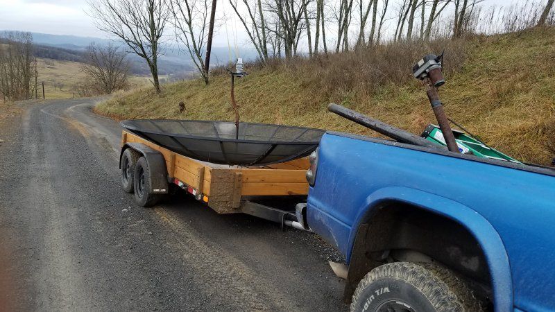

Rescued another dish this morning
Great save! Looks like a long actuator...hopefully it still works. ;)

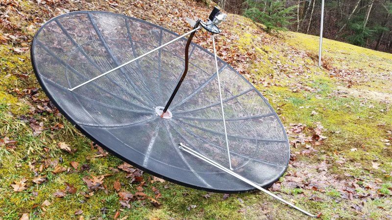

I have a 10ft CM mesh button hook.Works well here.
I added 4 turn-buckles with paracord to steady/center the button hook. Could have used steel cable but this dish is a temp until I put up the 12 footer.

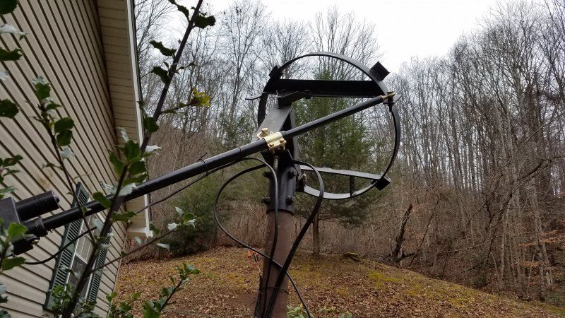

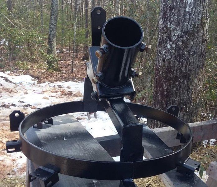

One thing about the mount,if yours is like mine: You'll probably want to make an actuator plate extension. The spacing is so close, the actuator clamp location will not allow the dish to travel very far on the actuator side. On mine, I added about a 6' plate extension...and still can drop no lower than 127W.

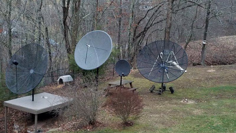

A pic of mine shows how close the actuator holes are to each other"

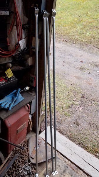

Here is a picture of mine, looks similar, went to lowes and got 4 5ft pcs 1/2 metal conduit to convert it to struts.
I was also surprised that it has the small hole ku mesh.
Reactions: armadillo_115
Those are very nice bends, especially on the scalar end. How did you go about making those bends?
I turned the conduit into something useful for the dish. No painting or installing them for awhile with this weather thoughView attachment 123241 View attachment 123242 .
I always liked a button hook feed, especially when the hook is long enough to extend through the back of the dish. Makes setting the polarity a snap and keeps you out from in front the dish. I like the support legs you made. Not much danger of it getting off center once you set it. I had a 12 foot Cassegrain antenna once upon a time. The feed sat behind the antenna, making it very easy to set the polarity and feed. I'd like to find one sitting around that someone wants to get out of their way. I'd snatch that baby up in a heartbeat.
Agreed! I am also a BIG fan of buttonhooks! As long as the hardware is solid, installs are fast and setting the FD and FL combo is simple!
I have added support wires once the position is set if there is any concern of feedhorn movement.
