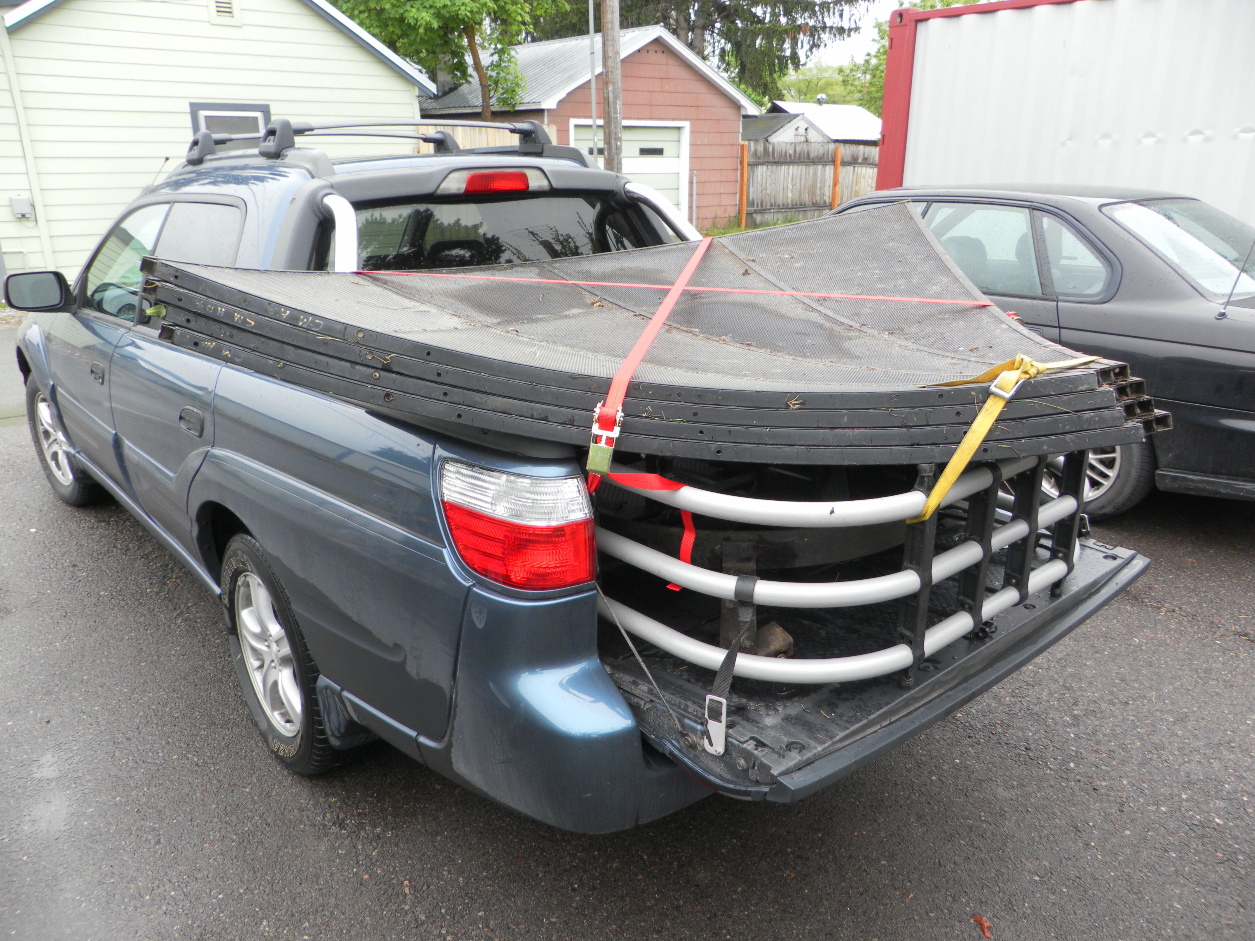

Here's a 10' Channel Master in the back of my Subaru. Comes apart in four sections. The mount and the rest are underneath the panels.

Yes it looked like your picture, just wanted to know in the dismantling process which should be done first since I will probably be doing most of it myself.
I've done several 10 footers by myself. Not a problem. :) I usually pull the LNBF supports first, than pop the dish off the mount. I disassemble the dish on the ground. Then pull the mount off the pole.
ahh MS beat me to it. there isn't a specific order that must be followed everytime. every dish breakdown is unique. generally feedhorn & legs come off first (lightweight). then individual panels (medium weight) then back support ring & pipe cap mount (heaviest items). when I disassembled my 10 foot fiberglass beast it was above someones roof & i was alone so I tilted it via the elevation bolt so it sat like a birdbath for easier access .... i'm 5'3" :). also another consideration is renting a boomtruck crane & operator. I've heard (no firsthand knowledge) in the usa its very economical (around 300-500ish?) to do so plus they're insured for damages. (not so economical here in Canada).

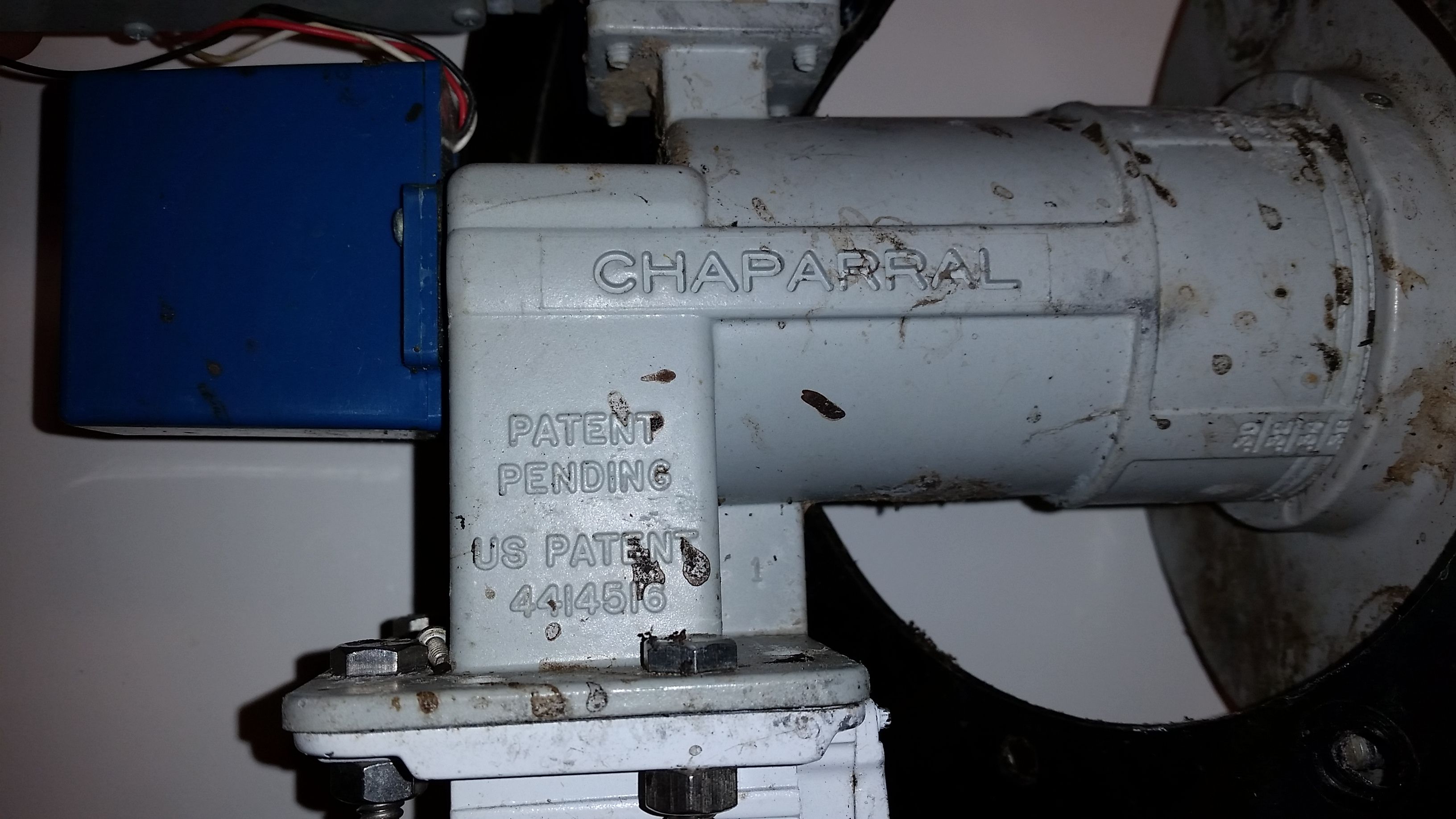

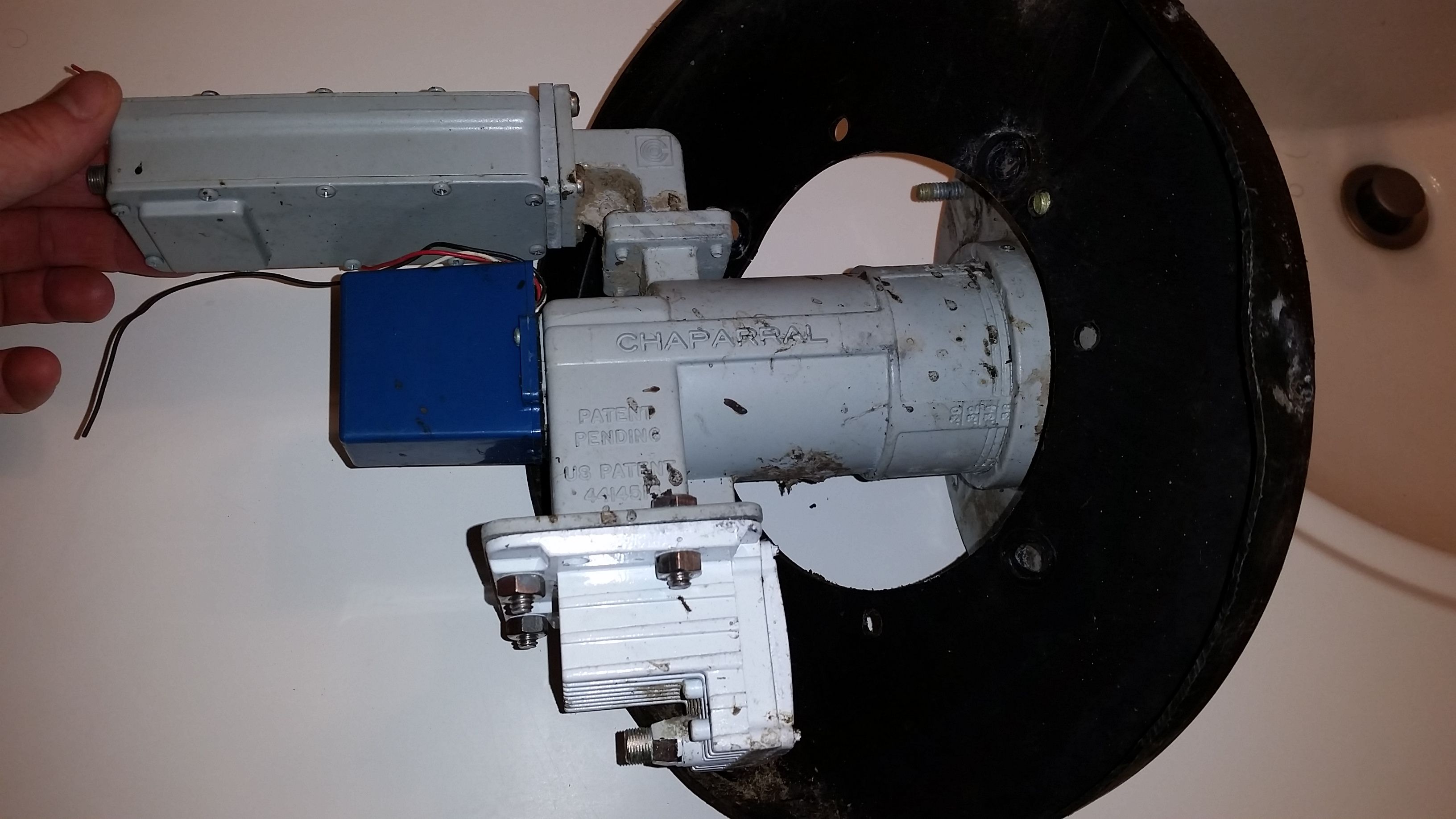

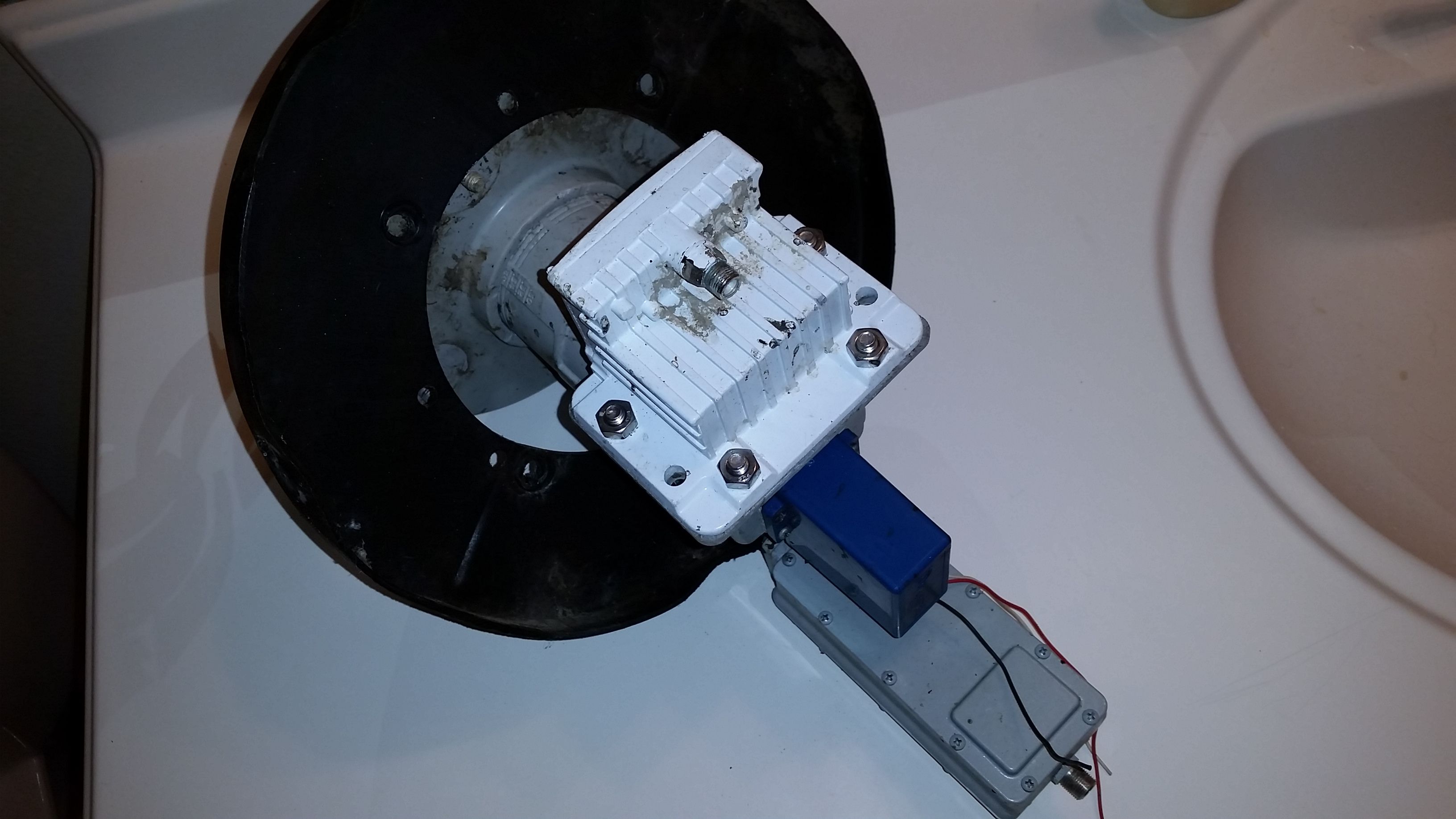

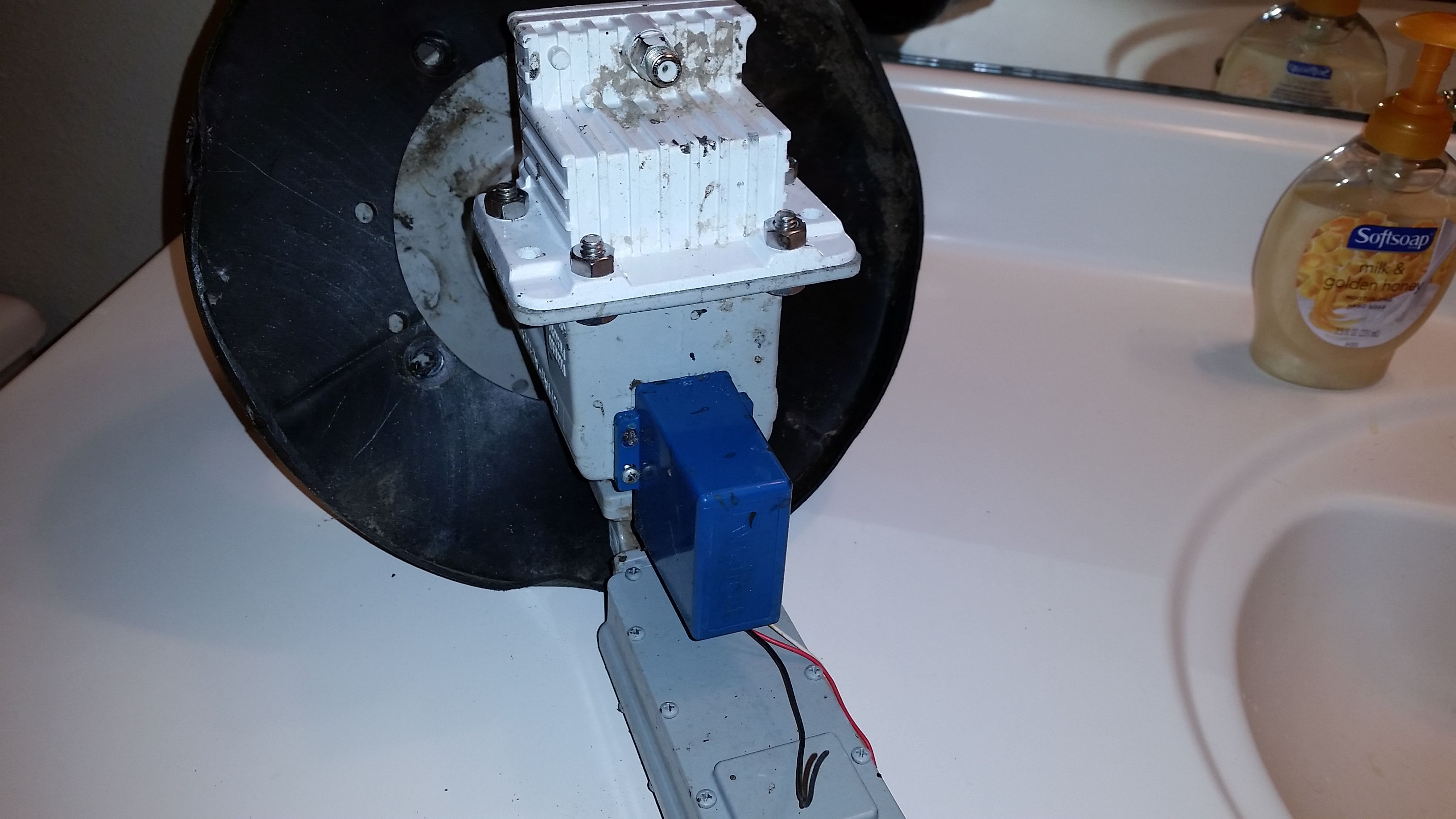

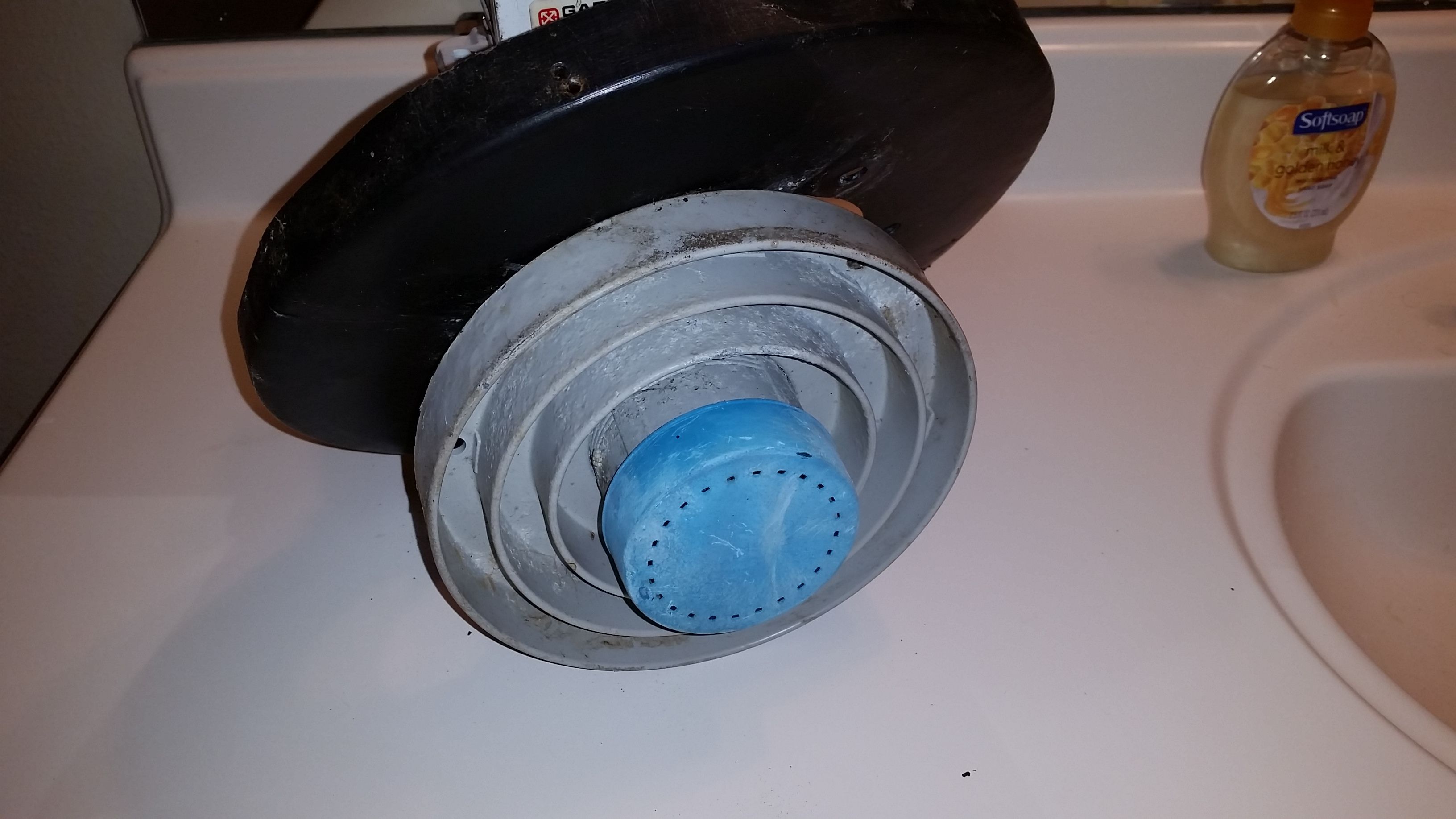

ok folks... here are some pics of the LNB that came with my channel master dish, looks fairly impressive, just need to know what I have and if it still good or not.

What you have there is a Chaparral CoRotor. The short White LNB is C-band and the longer one is for Ku.
I'm sure it still works and yes people still use them. I use one myself. I had to replace the servo motor on mine about a year ago, but it still works great.
You will need something like the Titanium ASC-1 so you can change polarity. Very nice though to be able to dial it in on some birds.
I would try and see if it works and consider changing the servo motor if it does work. Then look for a good quality LNBs for it.
It may work as is though at first and give you some time to do some research.
Reactions: dougruss
could I just use the c-band part if I wanted? (considering it still works that is)
