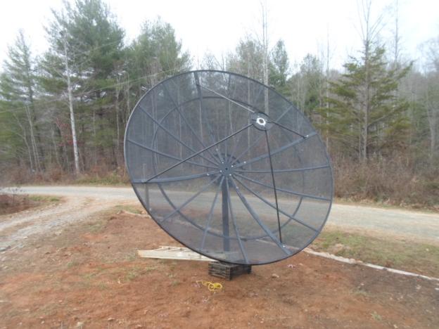

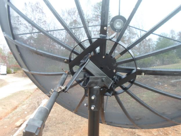

10 foot Unimesh Perf is up.(Mostly) I still have to center the scaler, install a titanium lnbf, run coax, and re-attach the nosecone; All stuff that I can do at my leisure without helpers around. I may paint the dish next spring...or just leave it as is. (I did blow a little paint on the worst shiny spots) Too cold to do any more today and rain coming tomorrow. Here's some Pics:

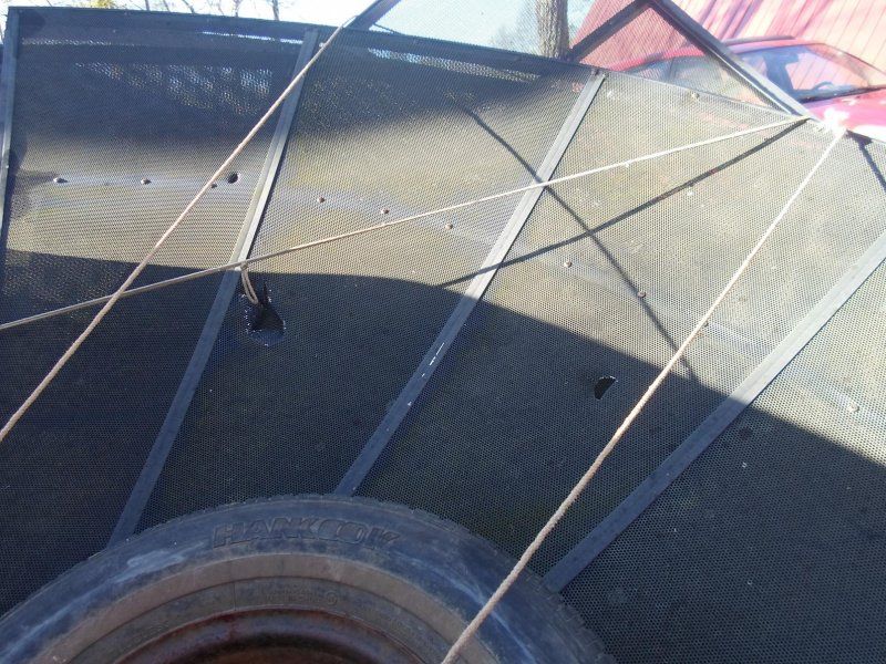

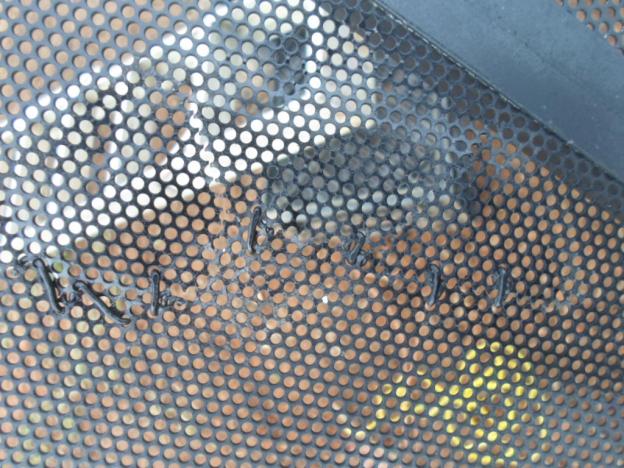

Before and after of worst hole in perf panel. This is temporary... plan to do a better stitch job when it's warm.( That darn aluminum was cold today) :

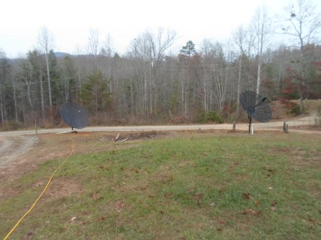

Finally, a pic of my "Twins" as I'm calling them. Unimesh perf on the left, Channel Master mesh on the right :
How many more before I can call it a Dish Farm? :biggrin
EDIT: I installed actuator on the east side. This dish will be able to drop farther east than the other dish. I want it to bottom out at 40w.
