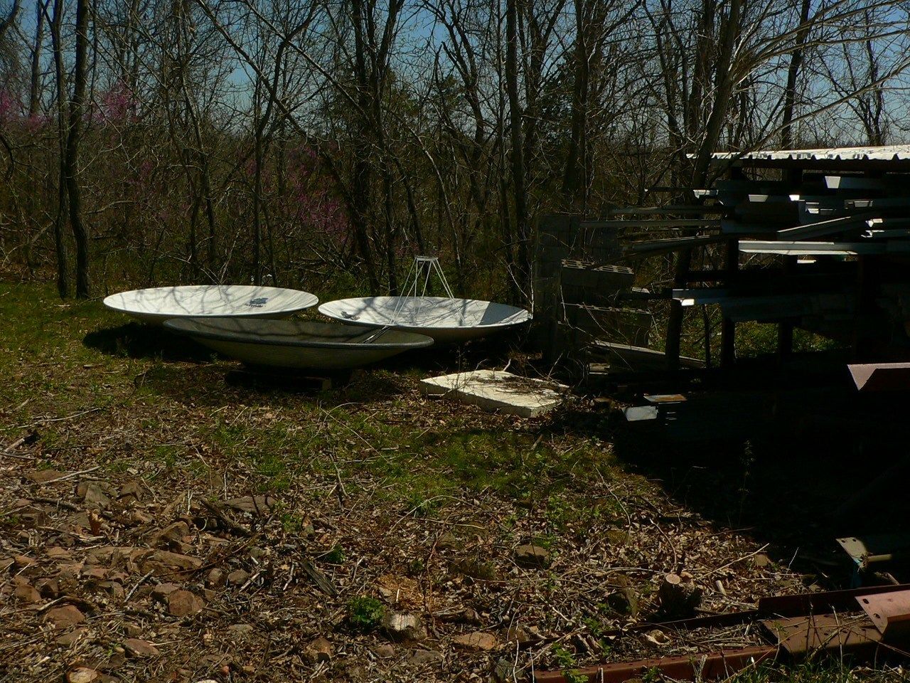

Here is a pic of my 3 BV reflectors @ 8'-6, I have one of the solids in operation now.
Are you talking about the "AMCI" (?) dish? I don't see much similarity in that one in your pics to a BV, other than it is a perf reflector with a rolled perf edge. :)
Sure would like to find someone that worked at BV with some knowledge, some really interesting info out there somewhere. Sat BV 1, 2 and 3.JPG

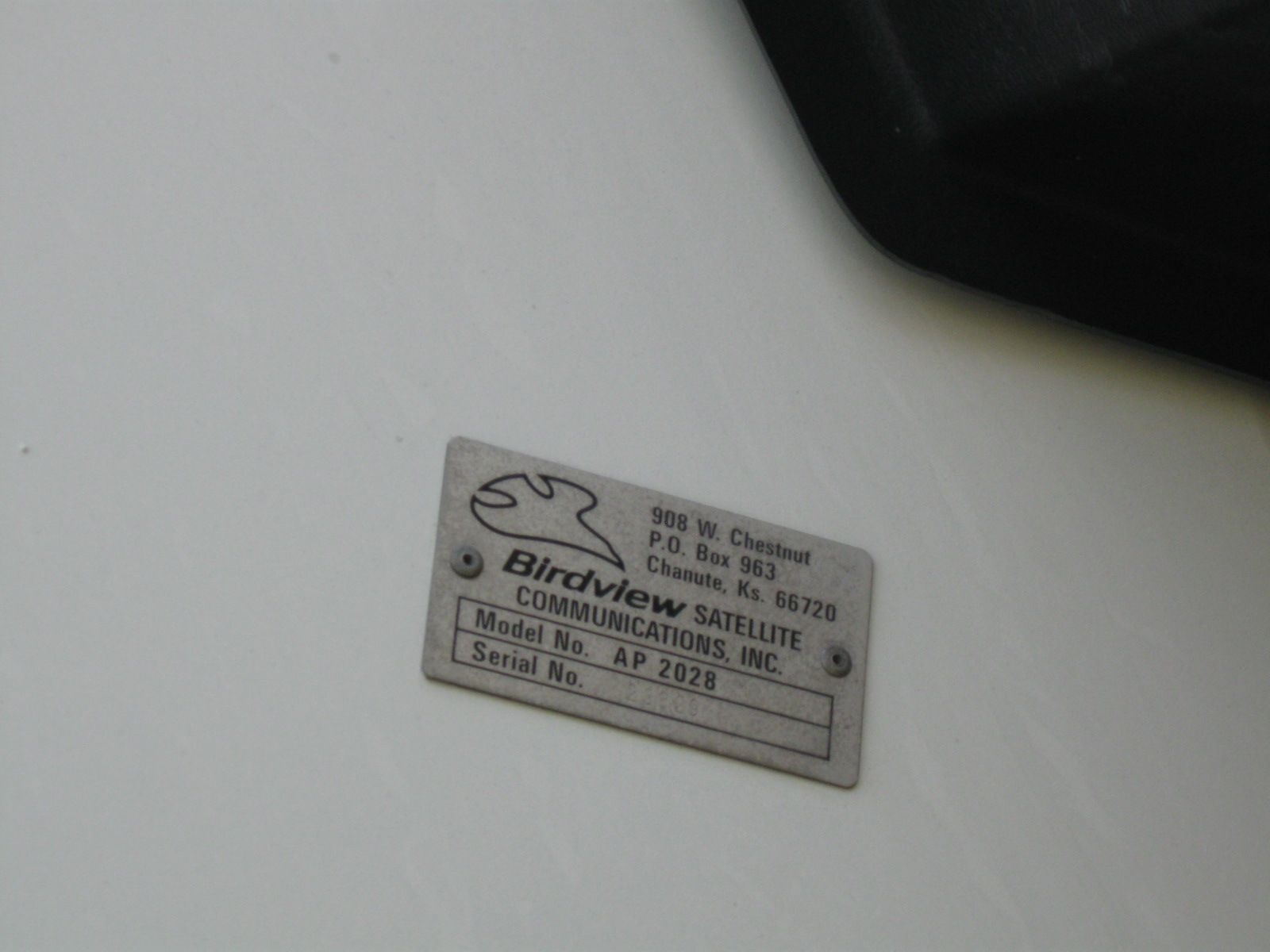

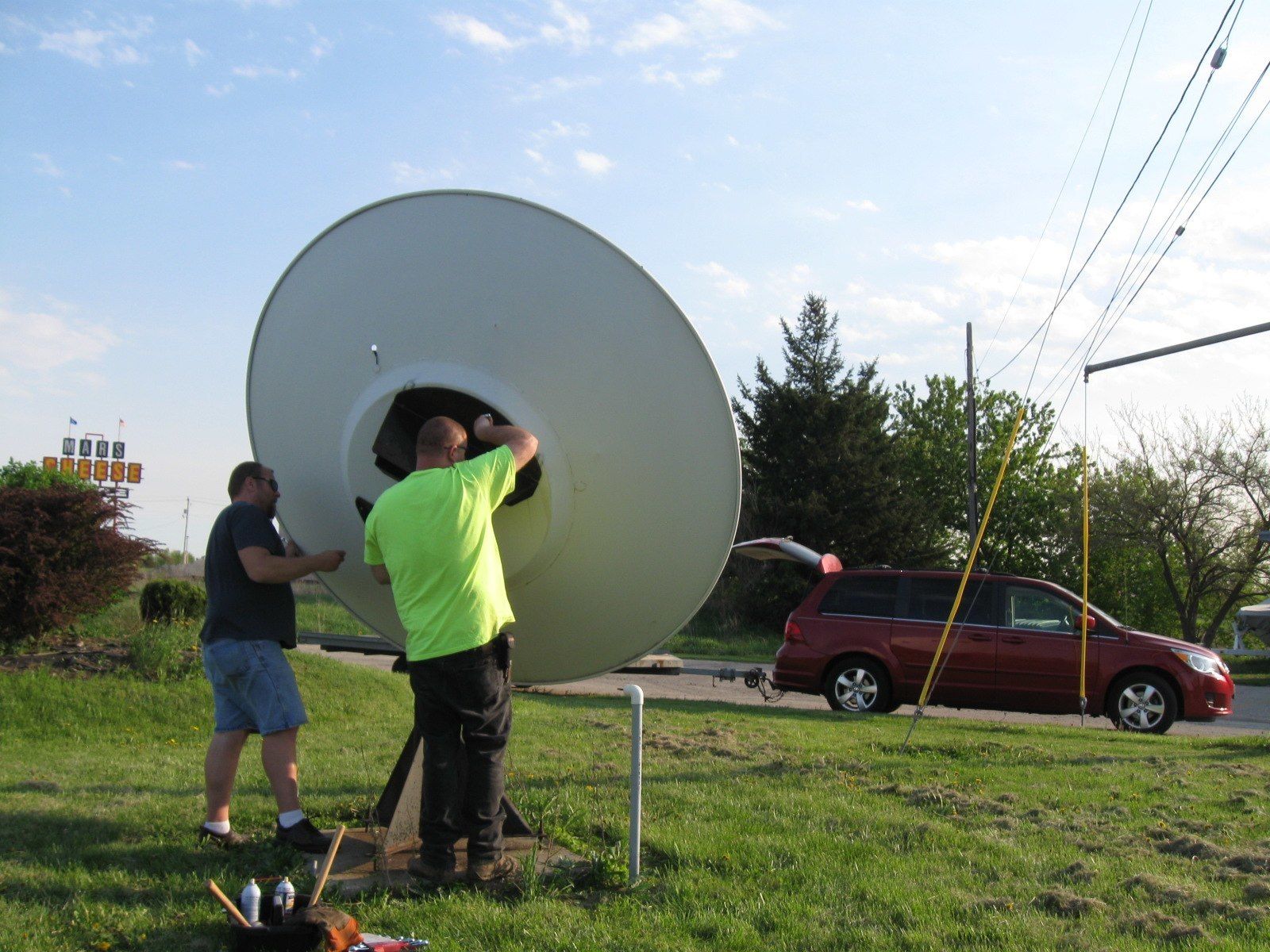

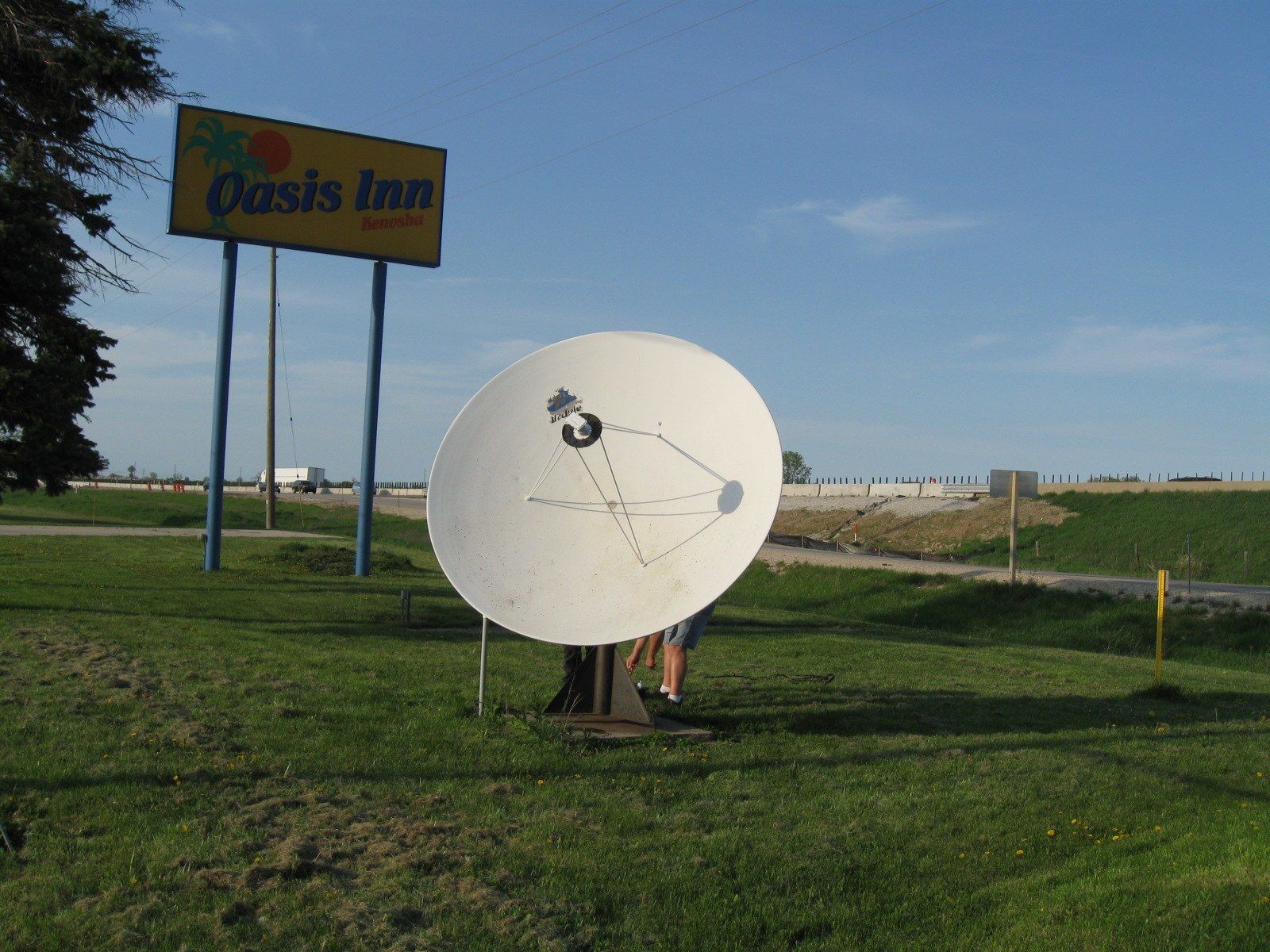

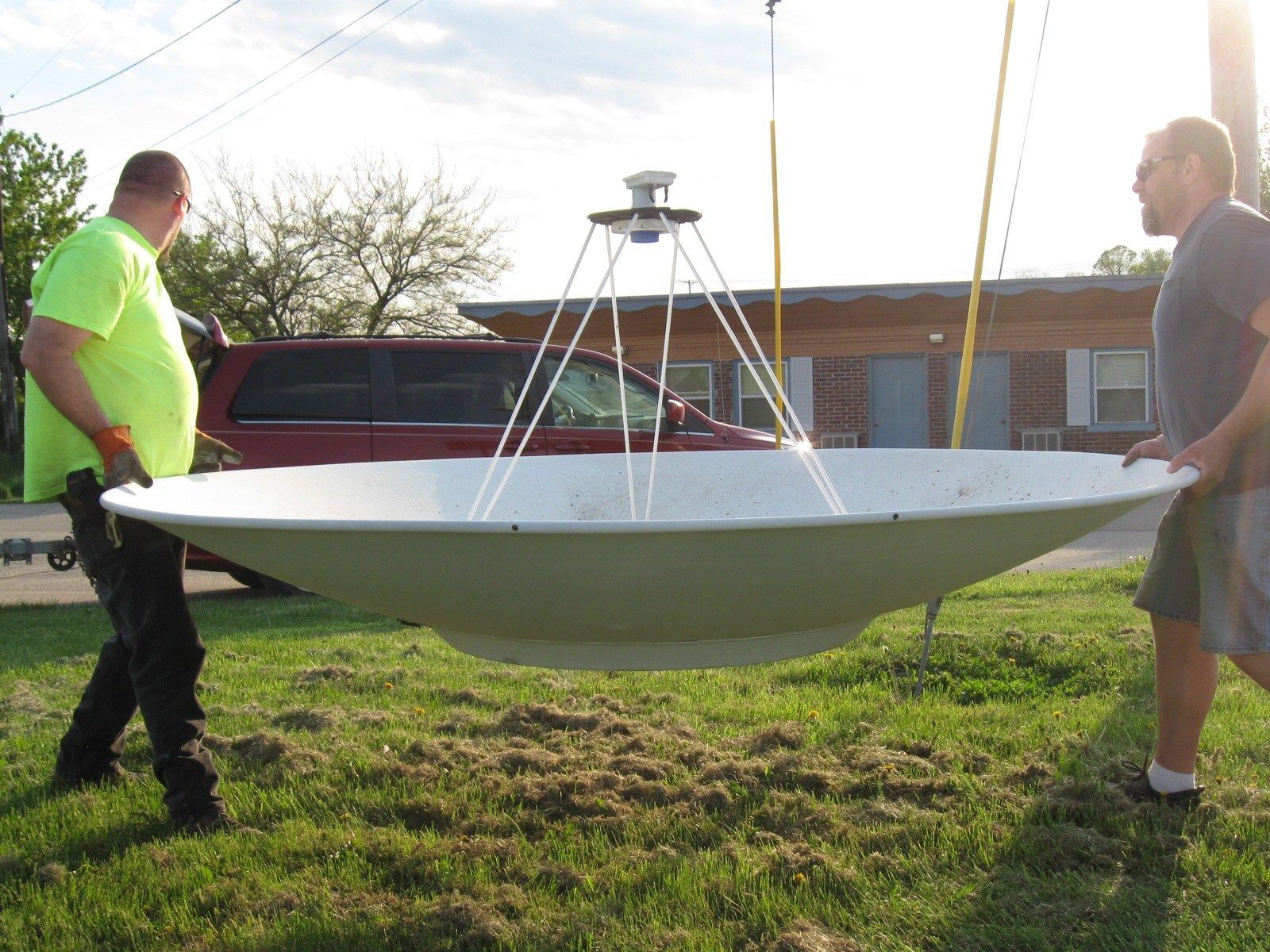

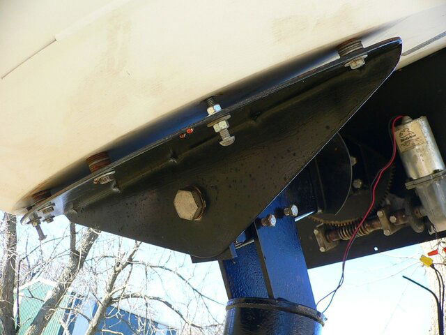

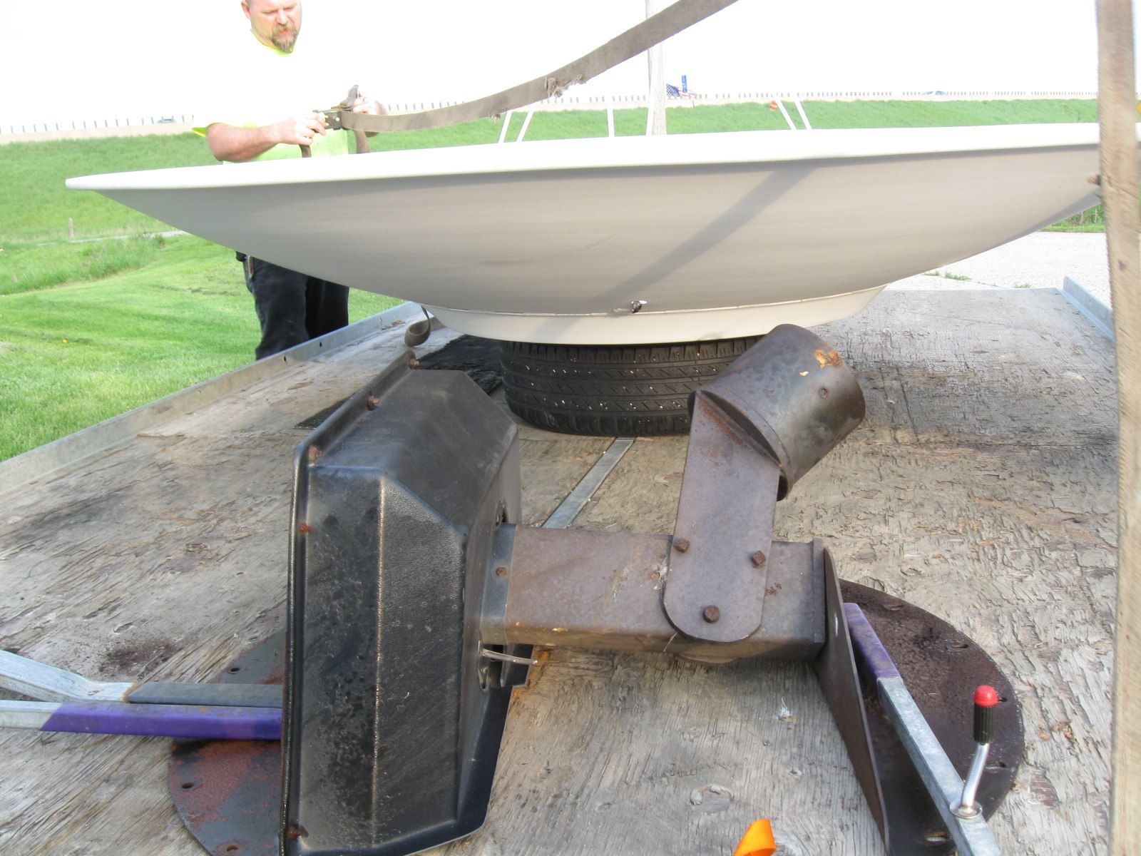

Here's a few pics with my 7 y/o working the camera. Also, I'm in luck, the motor has the reed sensor kit installed. It's too bad that putting this in operation entails a new concrete pad. Now it's on to the Paraclipse.

The Birdview looks excellent!
Even clean. :)
Your kid did a fine job with the camera.
Be sure to take him/her along on all your recovery and install missions!

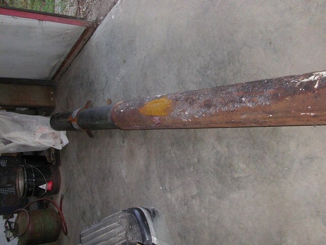

Hope you took the pole.
The BV mount won't fit onto anything else.
Anxious to see more pix.
Both installing the BV, and recovering the Paraclipse.
Oh yeah, I took everything, the dish, mount/motor, and the stand. After having read through a bunch of threads on here I see I got really lucky to have the reed sensor kit and the scalar ring conversion already installed on this Birdview. I thought he did a good job too, especially for being 7 y/o, I did get a few of these shots though.
Glad to hear it's mostly all converted!
The other mod is to move the scalar a few inches away from the dish.
Should be well documented in several threads.
Oh, and you may need to fine tune declination with washers.
Think that covers everything.
