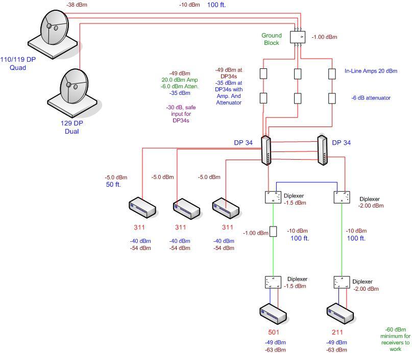

Adding a quality amp should increase signal strength in any situation. Whether that makes any difference to the receiver depends on a number of factors. Remember that the RF signals themselves are "analog" in the sense that they are continously varying in strength due to several contributors, and add to that the natural "noise" in the spectrum. As webbydude noted, garbage in, garbage out. However, a quality amp can help overcome some of those issues. Digital receivers need some minimum strength, relatively free of inteference, to lock the signals reliably. Adding an amp that increases the signal strength SHOULD help that situation. The amp needs to be a quality unit that does not add much noise or distortion itself (ideally both would be zero) or it may contribute to the problem rather than help it. How good are these low-cost commercially-available units? I'm not convinced that the signal meters in the receivers give a reliable indication of relative strength. A spectrum analyzer would be the best way to quantify what's happening, and the analyzer could also give a good indication of how much an amp is improving or hurting the signal.
In MikeD-C05's case I believe the amp is indeed increasing the signal strength, but as he noted the results are probably confounded by the time lag between the readings when natural variation in the signal may be adding or subtracting more than what the amp can contrubute. YMMV...
Amps do help only if the distance exceeds 150-200 ft. If you place an amp at 100 ft or less, the amp will over drive the switch or receiver.
For example, let's say you have a DP Twin and a DP34 switch. The DP Twin puts out an average of -36 dBm. When you place an in-line amp (20 dBm gain) between the LNB and the switch at 100 ft (avg. loss of 10 dBm) that will increase the signal level to -26 dBm (-36+20-10). The minimun safe input for a DP34 switch is -31 dBM. So in this case you will over drive the switch.
In the same example, if you place the amp at 150 ft. the input level at the DP34 switch will be -31 dBm. (assuming 15 dBm loss for the cable). So an amp will over drive a switch or receiver at distances less than 150 ft. Ideally, you want to use them at distances over 200 ft. to avoid over driving the receiver or switch.
BTW, I'm using in-line amplifiers at 100 ft. but I also have 6 dBM attenuators just before the DP34 switch and after the in-line amp. My receivers are located between 75-100 ft so I'm within the 200 ft. but just wanted to make sure that I wouldn't have a problem with voltage or signal loss. I also know that I don't need them but just wanted to experiment.
Here is an excellent document on how all this work:
http://www.sonoradesign.com/tipsAndTricksPages/DiskPro/DiskPro_01.html
I'm also attaching my old configuration, the only thing that's changed are the receivers.
