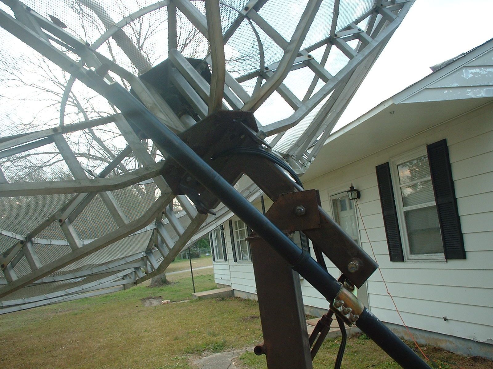

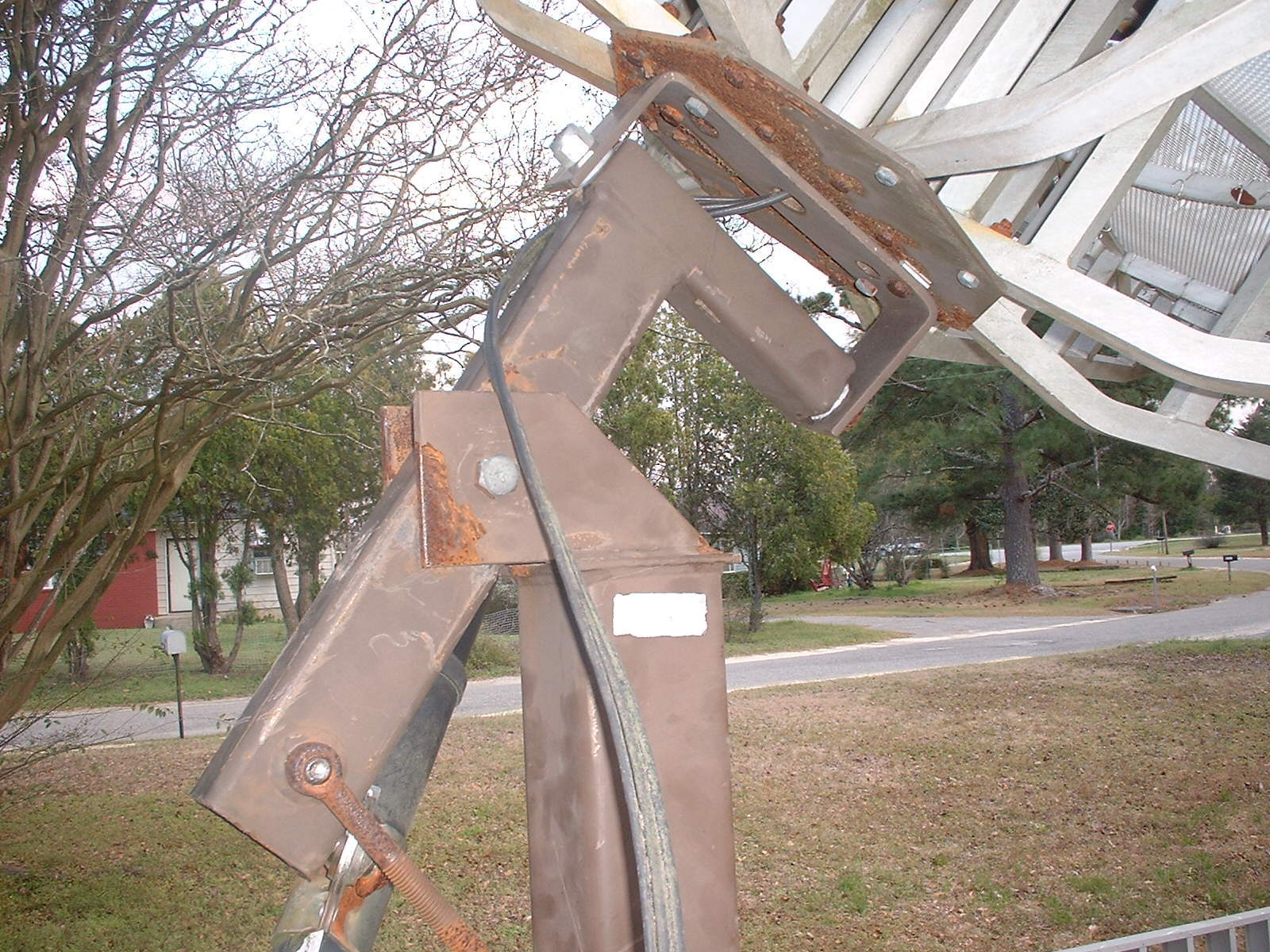

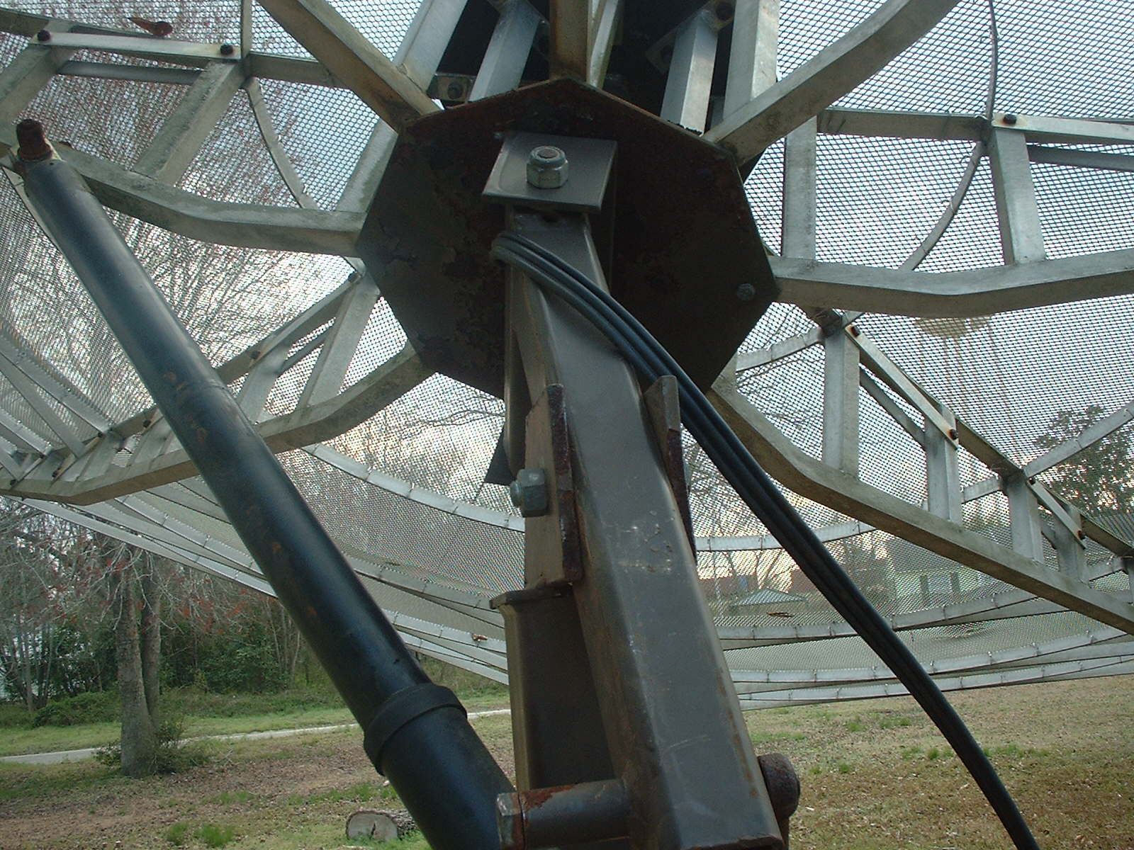

i dont know. im sitting on the east coast. and i cant understand, maybe i installed the satellite on the pole backwards or what. its not getting G5 or any satellite the signal is going to 205 as i move around. here is some pics. if anyone has the same satellite with this mount let me know if i have it installed wrong lol ? please help

I'll talk to ya. There are several places on the internet to get full instructions on dish installation procedures. Here's one:
http://www.satellitehelp.com/installation_index.asp
Also just looking and guessing, the actuator is installed on the wrong side. But that won't stop you from receiving satellites. Is the mount directly pointing due south? If not, you won't be able to find the satellites. Once the mount is pointing due south, move the dish due south and check the elevation with a protractor. I can tell you're pretty far south cause there's still leaves on the trees. The shims you have for the declination adjustment seems about right. That should make you point toward the orbital arc and able to find all the satellites. Have fun and good luck.

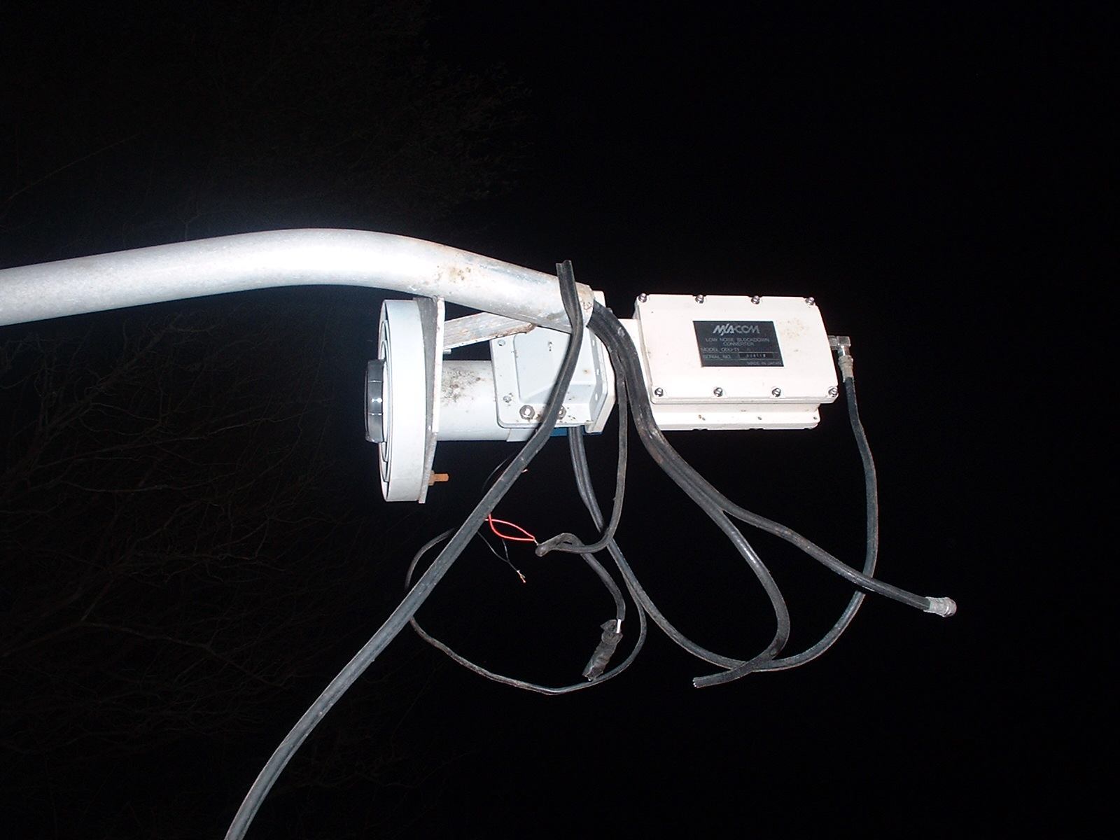

i got everything up and running now. its tracking the arc now and everything is great. its a chap feedhorn with an old Macom lnb its the one thats always been on it. thats what the guy told me. model # ODU-T1 but i dont know it looks pretty old. but the siginal is 100 and the quaity is 80 and jumps to 1 and freezes. could it be the lnb? making it do this?

i changed the lnb just a few minutes ago to a Calamp 25k with the led on it. and its quality is 93 and going back to 1. it jumps back and forth what could this be now?

I would check the voltage going to the lnb and see if it is up and down
I also found a ground strand touching the stinger before causes a variety of problems
are you talking about that frayed wires on the shielding of the coax? And by stinger you mean the copper wire in the middle? I guess that could look like a wasp stinger, just making sure....
Also could you clarify how to check voltage? Positive lead to the copper and negative to any nearby metal, like on the frame? or to the foil shielding?
It might be a bad co-ax connector, maybe they're causing a short. It wouldn't hurt to replace them. The shield should be the ground and the copper should be the voltage.

can you believe, my crazy ass figured it out after messing with the settings i was in and went to change installation settings . and then went to change dish settings . then LNB type it was set on C-band LNB and i changed it to c-band lnbf and BAM it started working like a charm . that made me happy. thanks for all ur help guys im going to order me some digital programming now. on my 12fter thanks alot . im happy! !
