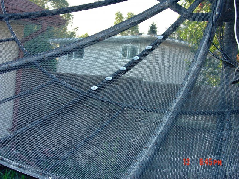

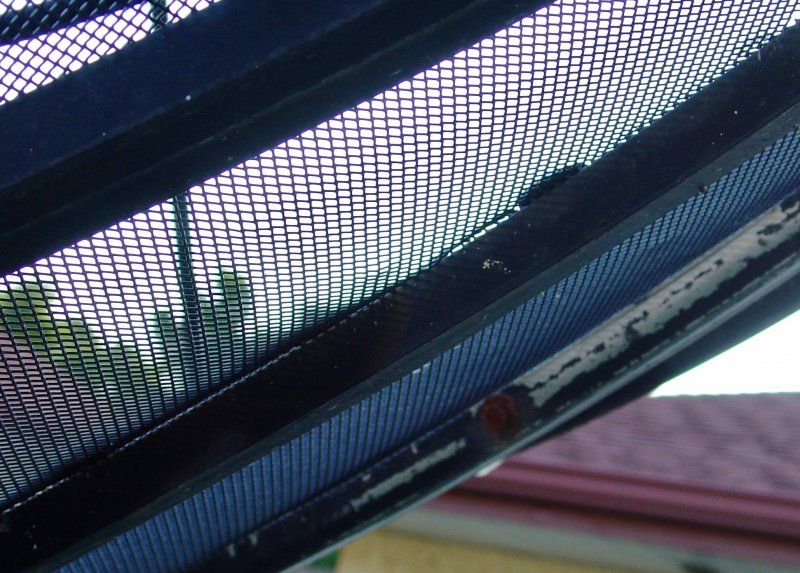

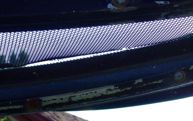

Yesterday I discovered a tear in the Wire Mesh of my 12 Footer where the wire mesh had detached itself away from one of the Ribs right in the middle of the Dish. We had 2 Blizzards here in Winnipeg, Manitoba, Canada last winter and I think wacking the dish with a long broom to clear the snow may have caused the problem.
Went to the local hardware store and purchased some very wide washers and screws a bit longer than the original ones. Original screws were almost welded down (my Dewalt Driver Drill wouldn't budge them) but I finally managed to loosen them using WD-40 Spray and a hand screwdriver. I was able to install 6 screws / washers combo and will attempt to upload the before and after pics. My question is I can't reach any higher without almost falling into the Dish and it looks like 1 more screw and washer up high would likely help. Does this repair look okay i.e. is it good enough? I'm also wondering if this repair will improve reception as I have been having trouble with many Tp's on 127.0W. Any comments / advice would be very much appreciated.

Your repair job looks good to me.
I would be surprised if you notice much difference in reception, the area of the parabola affected negatively by the damage is such a small percentage of the total area, especially on a 12 footer.

Thanks a lot for your replies Phlatwound and Wvman. You can be assured I won't ever be hitting the Dish again with my snow broom and will definitely check with Home Depot re those Telescoping Poles and Broom combos. Think I'll pass on trying to add a 7th screw and washer at the high end of the Dish as a second look at the Dish shows almost no gap left re the wire Mesh separation from the Rib. Thanks.

Great idea Keystone 7 yes zip ties would also work well. I managed to add a 7th washer and screw combination at the upper end of the dish and can see no more openings. With your zip tie idea you could just walk up to the back of the dish and insert the tie in from the back without having to climb up on the front of the Dish - great idea thanks for the valuable info.
