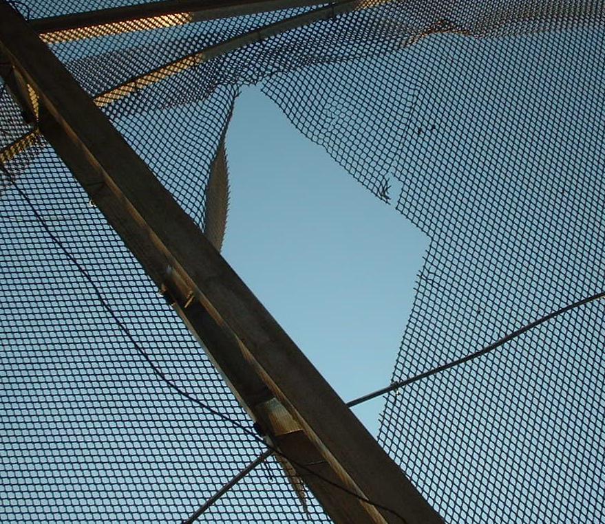

when i was trying to mount this heavy ass dish. it fell backwards when the wind got it and hit me in the back lol and the mesh got a hole in it from the pole. is this fixable?

Yeah should be, Skyvision has replcement panels for some dishes I think...

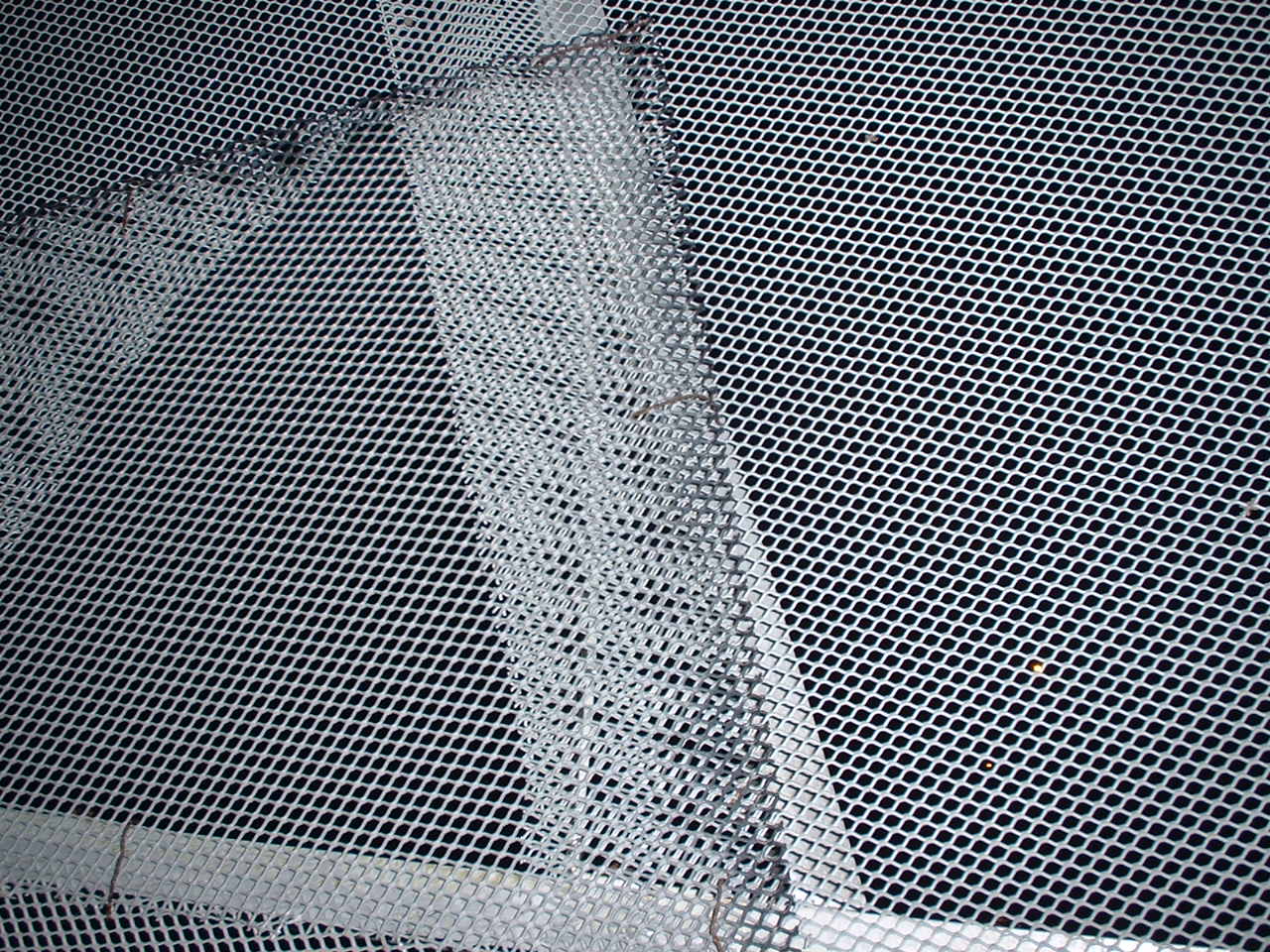

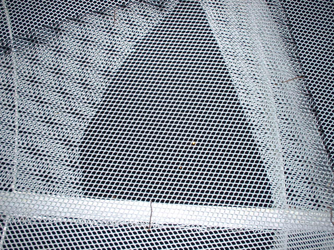

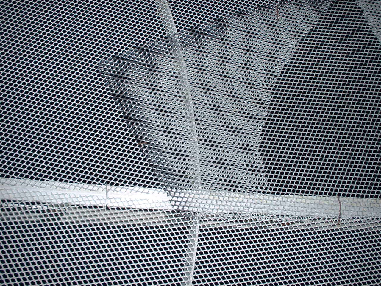

I took Some Mesh Off Another Dish and the mesh is the same i used steel wire and put it over the hole. ill have pictures later i fixed one panel . ill take a picture soon

does it matter if the mesh over lap the other mesh ? as long as the holes are covered up
The main thing is to keep the consistancy of the mesh flow, of the repaired area, as close to the mesh was before it was damaged. This is so it will reflect correctly to the LNB.
from the pictures do you think it will be ok. its as close as i can get it and real tight againest the other
