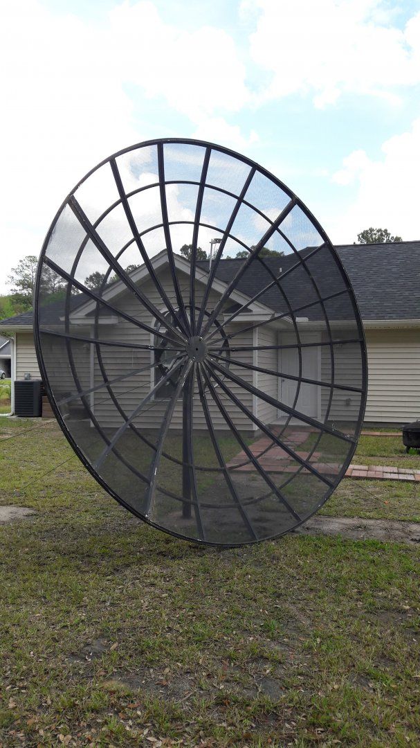

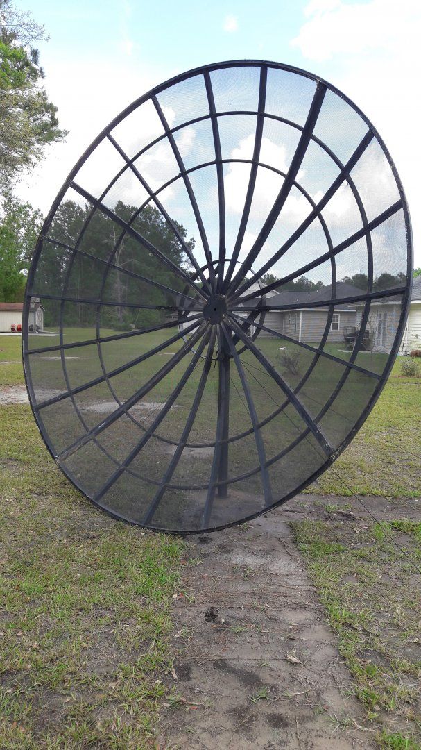

Today, I made huge progress with my newly acquired dish...It was definitely a learning experience with figuring out how the panels go together and then how they mount to the mounting ring, and also doing this by myself with a good breeze of 6-10mph here today! the position I have the dish in now will stay that way until I get my new LNB, this way it will be easier for me to install the quad arms and the LNB, super excited with the progress today and can't wait to finish it up and start scanning the sky! 4-11-19 003.jpg 4-11-19 004.jpg

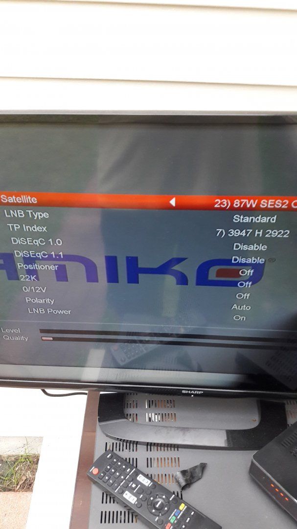

I would go with 87W, that is the closest one to you that has 24hr active transponders. I use to use 83W but 87W now. I am not too far from your QTH.

Do you have the old analog receiver moving the dish? If soo run it until until the polar mount is pointed due south. Look at the upright on the mount and make sure it is parallel with the pole. Move the dish about forty counts to the east and manually adjust for a strong signal on 87 west That will get you in the field.
I don't have the analog receiver hooked up yet...still need to get some actuator wire for it....the upright you are referring to..that is the part I have my angle count set on in the above picture?
Your elevation will be the same as your latitude.Decinatoin might have to modified a bit from were the dish came from, but only a half a degree maybe.
ok...I will reset my elevation back to where I had it before...not too sure on how to set the declination part yet...but will see if I can figure it out lol Thx for the input!
ok guys....have the dish driven to the highest point...have tried to get 87w but I have a good feeling that the dish is aimed a bit high and I am above the arc..no signal yet...any good advice? (Nick (Computech) I will be contacting you either tomorrow eve. or Thursday eve. for additional guidance)sat 7-9 001.jpg
