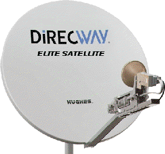

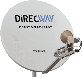

The first is the newer ODU which more than likley will not work.
The next is the olderstyle that may work.
The reason why is the olderstyle can be skewed @ the LNB.
Again Why are you trying?

Thanks Tate for replying, I am just trying because the signal strenght is too low, the system (0.74m dish, dw6000 mdem, 1 watt LNB) has been installed outside the us (Perhaps the original .74 dish is too small).
Since I had bought a 6'' FortecStar dish for TV sat reception, I was thinking of using it as a replacement of the original dish.
I have the LNB for residential service not those that are shown.
