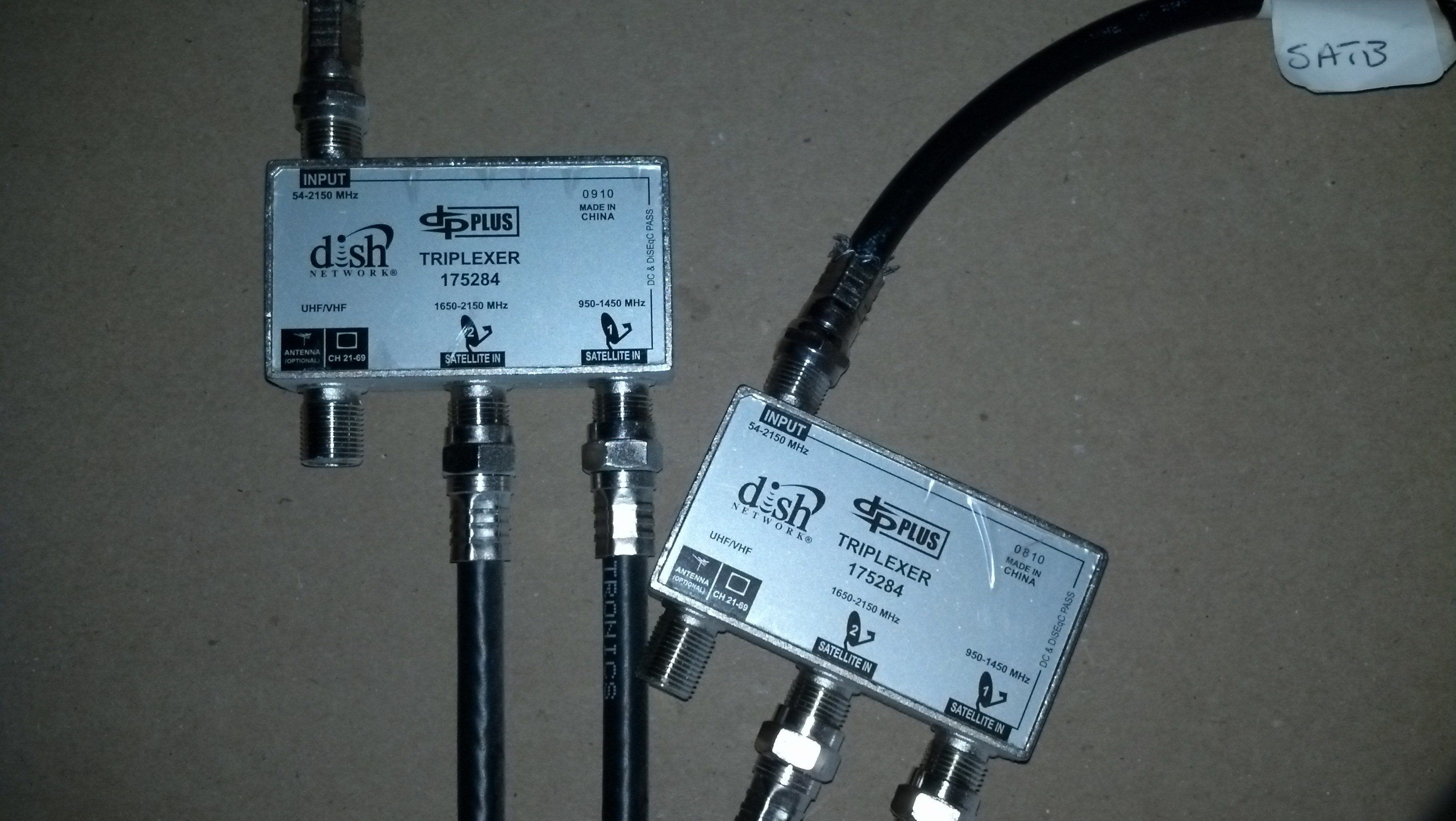

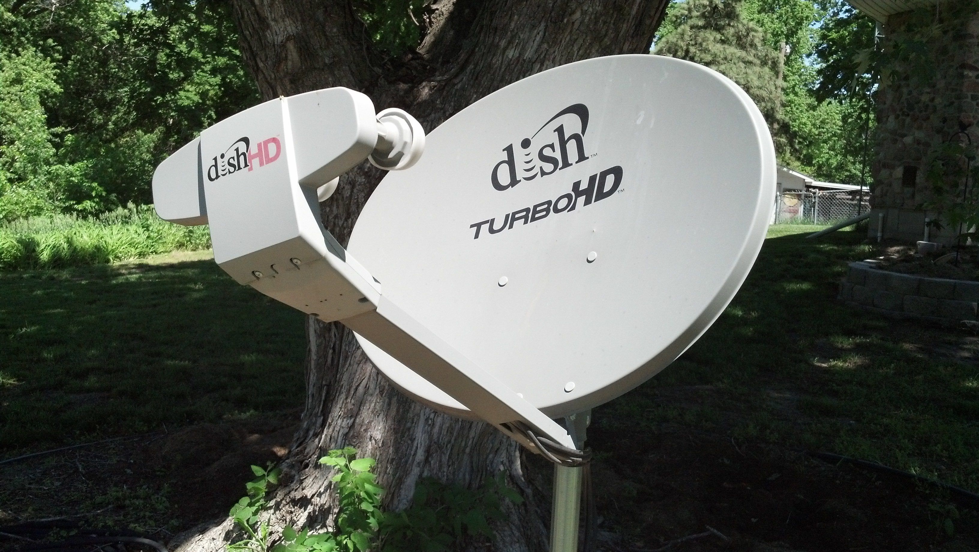

My current setup is a Dish TurboHD with 3 coax running to a wiring closet. In that closet 2 of the 3 coax are hooked to the inputs of 2 DPP Triplexers, which are then ran to the 322s. All cabling in the house is new and also runs to this closet.

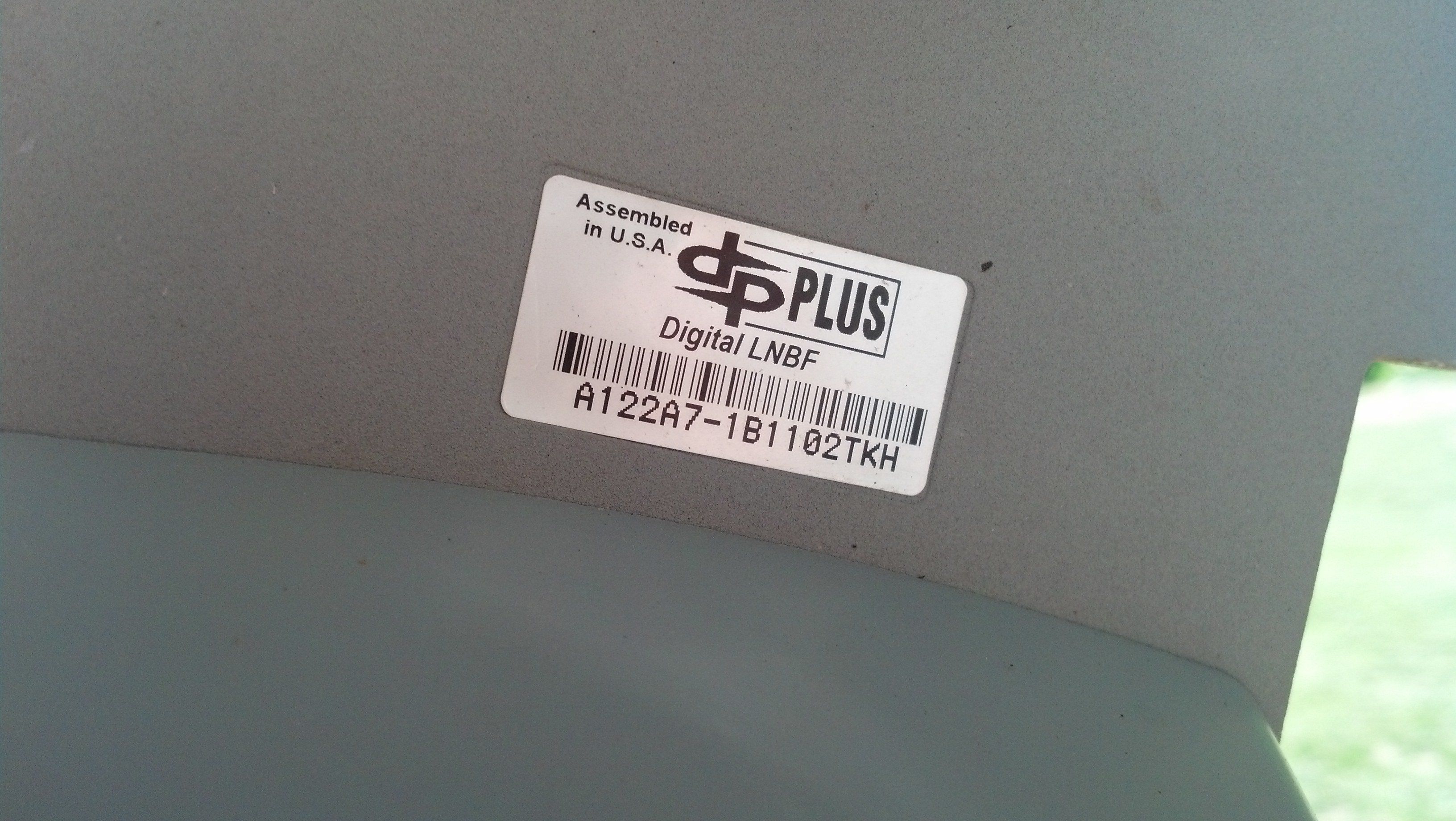

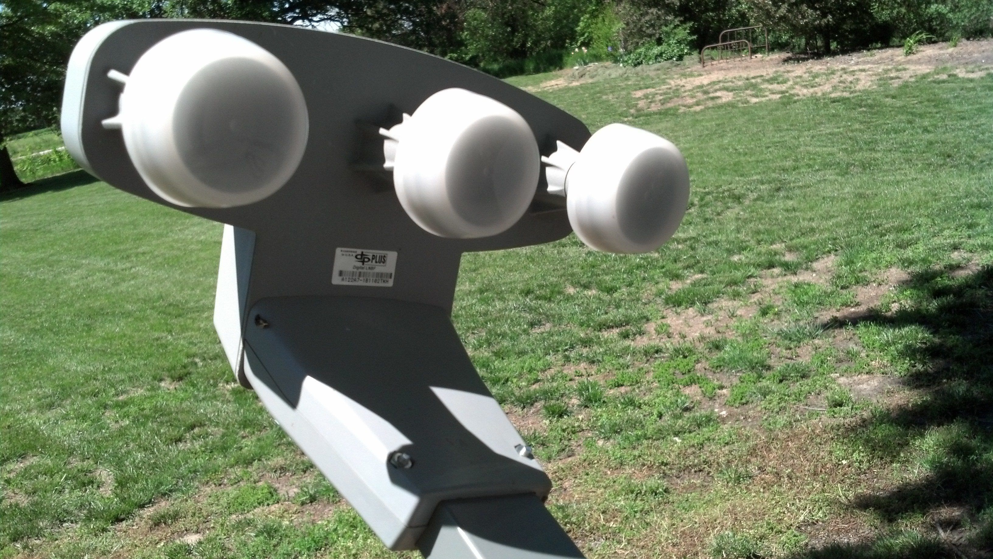

IMG_20130531_121343_623.jpgIMG_20130531_121400_120.jpgIMG_20130531_121354_936.jpgIMG_20130531_121603_801.jpg
