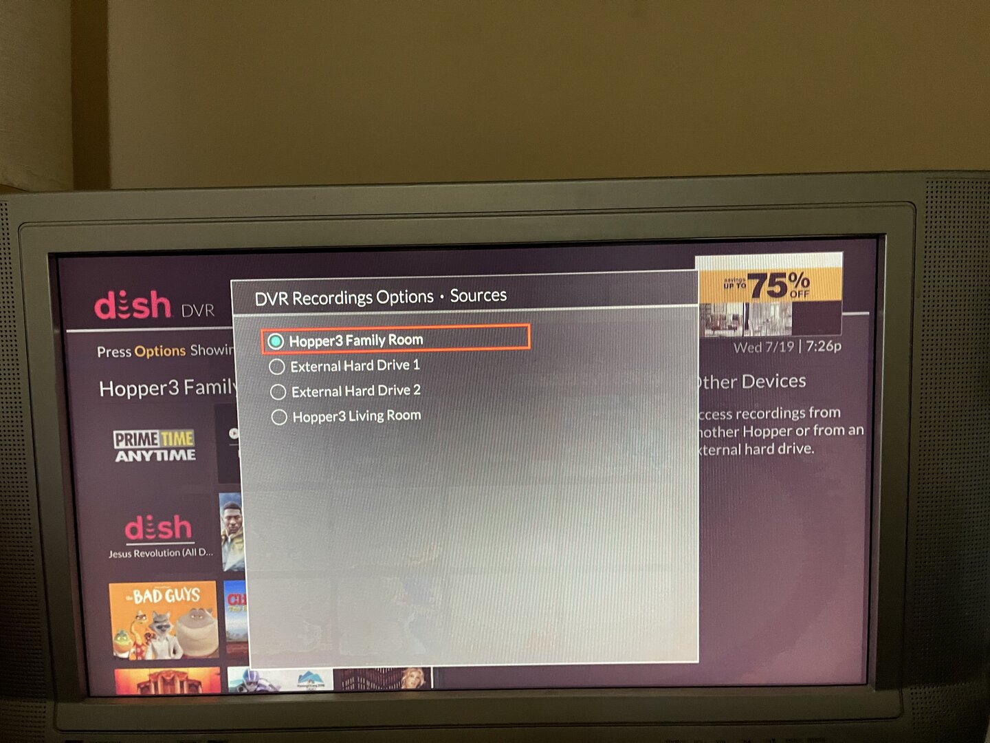

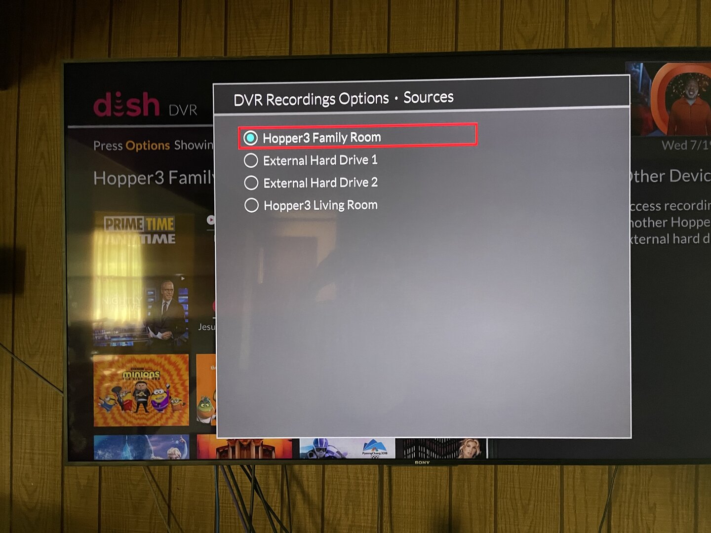

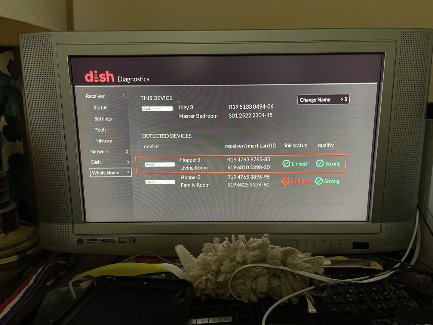

I have 2 Hopper3 receivers and a Joey3 client. My Living Room Hopper3 has one external hard drive and my Family Room Hopper3 has two external hard drives. Both of my Hopper3 receivers can access recordings on the remote Hopper3 internal drive but the Hopper3 can not access recordings on the remote Hopper3 external drives. Attached is a picture of my Family Room Hopper3.
My Joey 3 can be connected to either Hopper3 receiver and it can access the external drive of the Hopper3 that it is connected to. Attached is a picture showing how you decide which Hopper3 is linked to the Joey3.
Attached is a picture showing my Joey3 accessing the Family Room Hopper3.

My two Hopper3 receivers and my Joey3 are connected with a duo hub which allows both Hopper3 receivers to access each other. TJBoston is correct when he says that Dish does not normally recommend this setup. But I have had this setup for many years with no problems. If you use solo hubs you would need to connect the client ports together to allow both Hopper3 receivers to access each other. When my two Hopper3 receivers were first installed the Dish techs had no idea how to set it up. I showed them how based on information from SatelliteGuys.

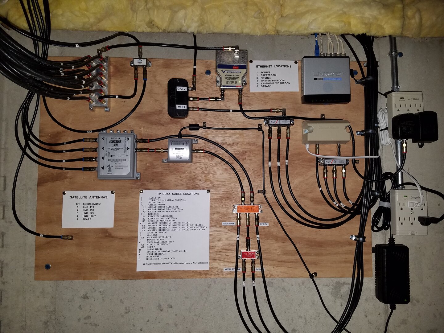

Does anyone have some diagrams that show the solo hub and duo hub configurations. That would be easier to understand.
You have Charles awesome picture above, but if you prefer a proper diagram I have posted some in the past, latter tonight if I get a chance I'll find them or just make some new ones for the people interested.
