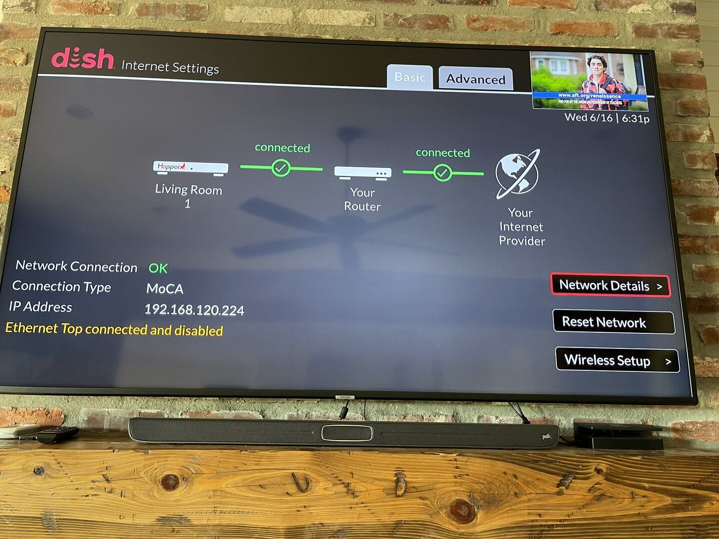

I have connected one via ethernet and one no internet. However , the Ethernet hopper says it's connected via moca and ethernet is connected and disabled. The other hopper says it's also connected via moca and that the wireless is connected and disabled .

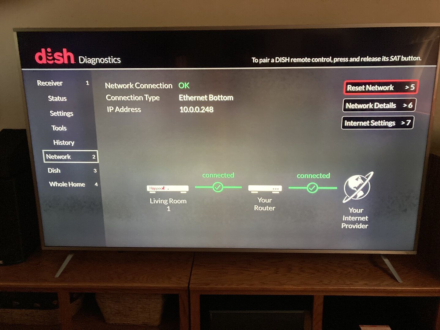

On the Hopper with the ethernet attached, press Home 3 times to get to the Diagnostics screen, go down to Network, press 5 on the remote to reset your network. That should fix the first one, and maybe the second. Those with 2 Hoppers would be better to advise you as to how they have that second one set up.

Don't ask me why, but if you are having troubles try connecting your Living Room H3 Ethernet cable to the Bottom Ethernet port.

I would try this, disconnect the Ethernet cable from the one Hopper it's connected to and on Both Hoppers, go to your Internet Settings (Home x3, #2 - Networking, then #7 - Internet Settings - I may have named those wrong, but those are the numbers) then on the remote, hit Info and then Recall and say yes to clearing internet settings, do a reset network and reboot. that's starting from scratch.
Making sure Bridging is on, on both Hoppers - which it should be, it is by default, connect the one to the Ethernet and use the Top LAN Input and it should connect then give you the Popup that it's sharing the Network. Once it's done, everything should be Moca Connected and the Hopper with the Ethernet should say Using Top Ethernet Port - WiFi Disconnected (or Disabled)
