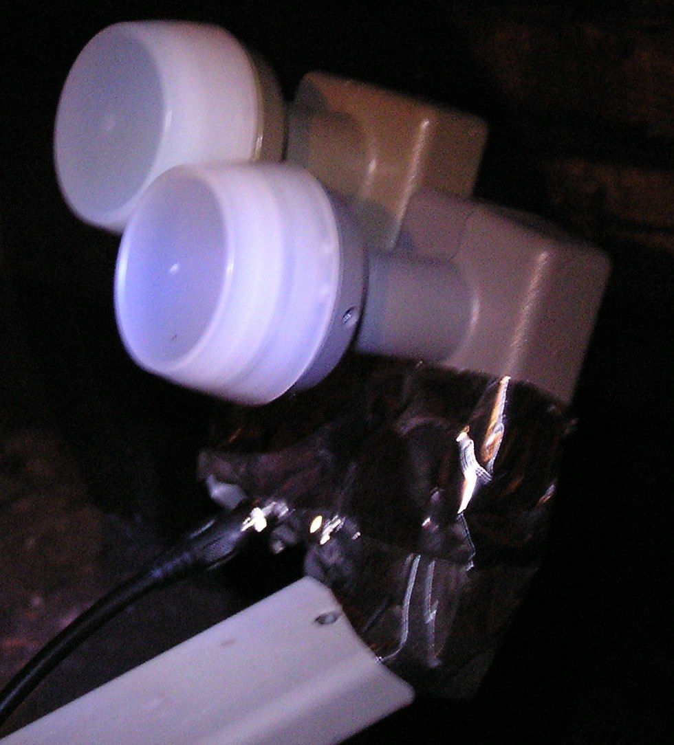

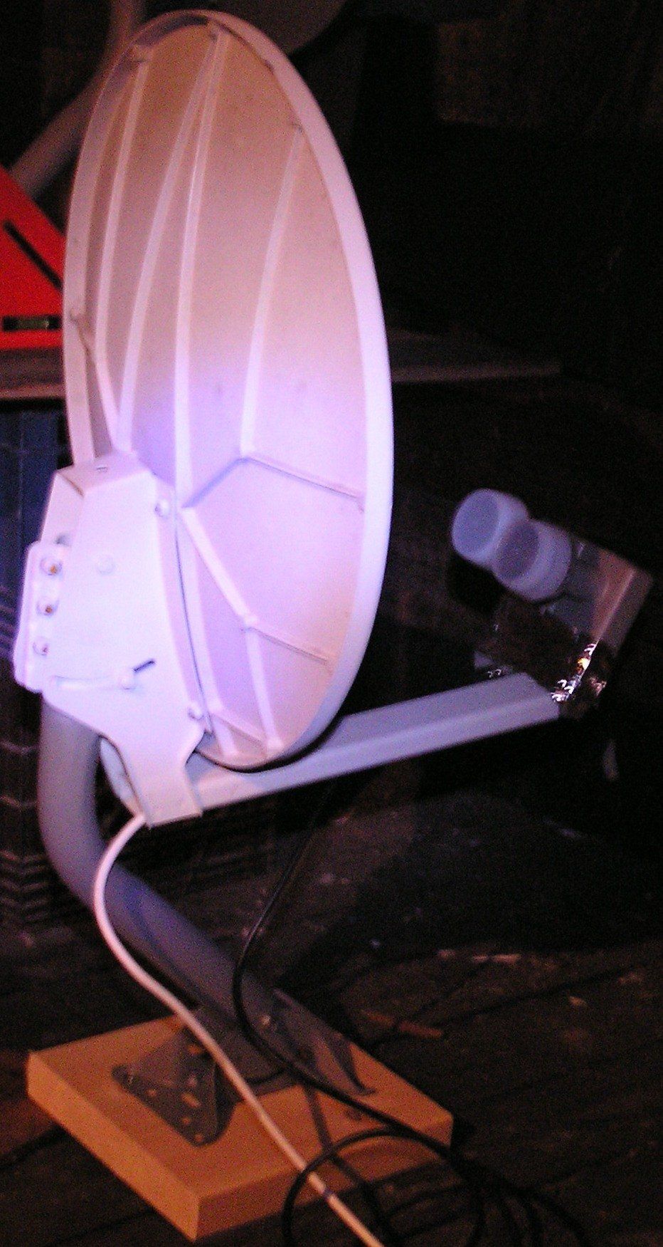

Thanks Iceberg. Well the temps went up to 20 F so I did some messing around in the attic and this is what I found.
There are a number of ways to do this. One way is to stager the LNBFs with the dish flat the other is to put them side by side and tilt the dish. Kinda of the way a Dish 500 is made. I think tilting the dish worked the best for me. I was getting like 80 on 110 and 70 on 119. A little low BUT I can work with it. Note I started this by pointing the dish to 110 to get the best quality and went from there.
Other findings. I held a third LNBF off to the other side and the signal meter said I was getting something. Most likely 101W BUT not sure because I did not not have a DTV receiver to tell me it was. I then moved the LNBF more to the right, with me behind the dish, and received 91W It was only 50 so it was kinda marginal.
Still fun to do tho. I also say on Ebay a guy selling some brackets to turn a 18" dish into a Dish 500 for like $20 + S&H.

those brackets seem expensive. you can do it for MUCH cheaper :)
How is it holding together? duct tape??
ken
hose clamps work real good to put 2 LNB's together.
Bought a whole bunch for .99 each at the hardware store and they are reusable :)
GREAT idea Iceberg. I will have to stop tonight and get some. I am using the silver foil tape you get for duct work BUT I know the clamps will hold up MUCH longer.

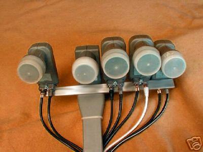

A picture is worth 1000 words. Getting any ideas?
Off E-bay $25 buy it now price.
