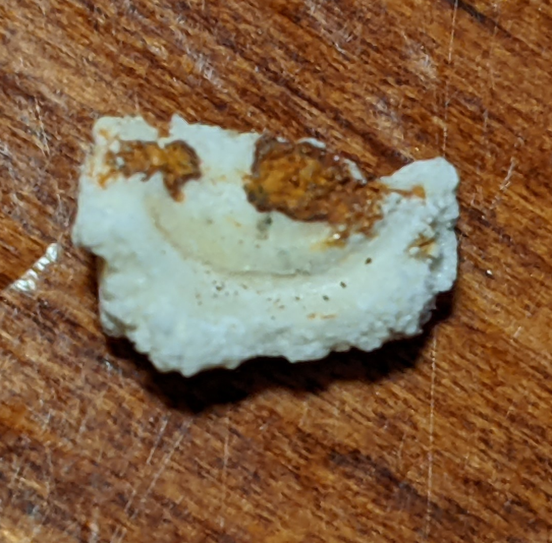

I took my remote apart since it was deemed that my new remote was dead. When I did, a chuck of white stone like material fell out from the negative battery 'coils' that are up inside of the remote. I also noted what looked like scorch marks on the circuit board under each 'coil'.
The remote now works after hitting it with electronic cleaner, lightly sanding the coils so they are bright, and reassembling.
Thinking that the white material was corrosion from a leaking battery; which I can't explain since the remote is stored without any, I made a paste of baking soda and water. I expected that the paste would fizz when placing the stone like material in it but nothing happened. So what is it? I don't know.
Maybe my testing was under a false impression or the material was left over from when the remote was made, or refurbished. I don't know if the remote was new when I received it from DISH or not.
Either way it now works :-).
