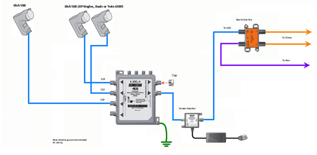

Wiring by diagram in post #16 by Hipkat - Probably cleaner to put the injector closer to the DPH 42. Looked at the DPH44 and DPH 42, in the diagram above - but that puts a lot of parts in the system.
Well, I finally got this wired per the below diagram
dp5-png.136413
and, it did not work. Both receivers showed to signal detected. - Using the DPH42, going to the power injector, then going to a Hybrid Solo Hub 203952. On this unit I put the output from the signal injector to the ODU port and the Hopper to the Host port and the 211K to one of the Client HVN ports - Mis-wired, or not the correct parts? TIA

The 211K won't work on the client port, in fact you should disconnect it ASAP as it is trying to put voltage on the MoCA line which may have already caused damage to the hub and/or Hopper.
I've never tried a 211K on a Hybrid system so I don't know if it will work but if it has any chance of working it has to be connected to the other port on the DPH42 switch.

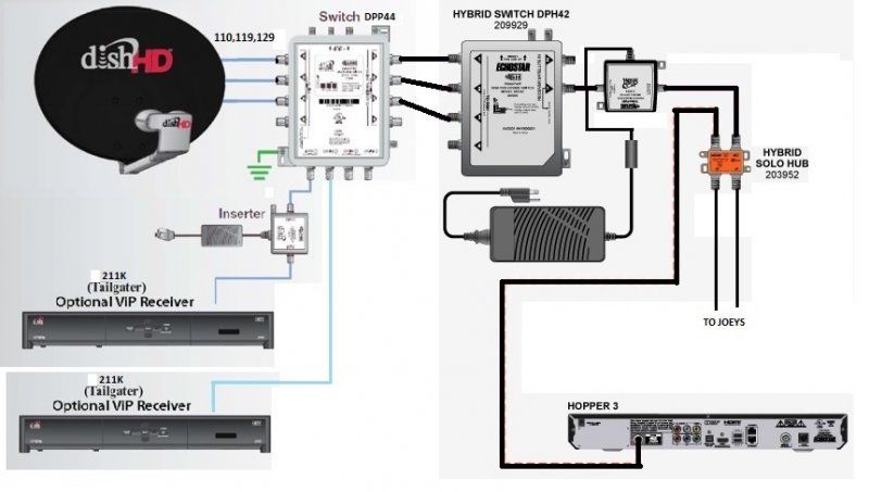

Not positive but a 211k will not work on a hybrid system. Once you turn it into a hybrid system either at the hybrid lnb or DPH42 the 211k will not work. That's why we have our 211k's before the DPH42 with a standard lnb. Once you install a DPH42 on a regular lnb you have a standard system before it and a hybrid system after it. If that makes any sense.
