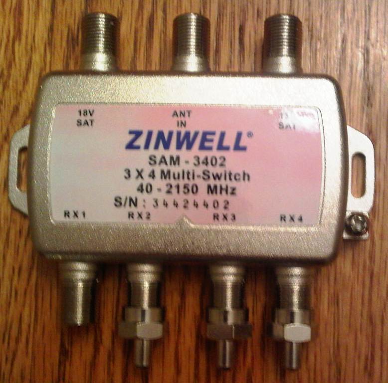

The 3x4 switch looks like this.

2. I already have OTA setup and get about 37 channels that way. I use a small 3x4 switch to feed 4 TV's around the house. Assuming a Dish 500 can I just plug in this 3x4 switch?
The switch that you displayed is aftermarket and may not work with your DISH Network equipment (for DISH Network's signal).

2. no that switch is for Directv. Dish uses its own setup

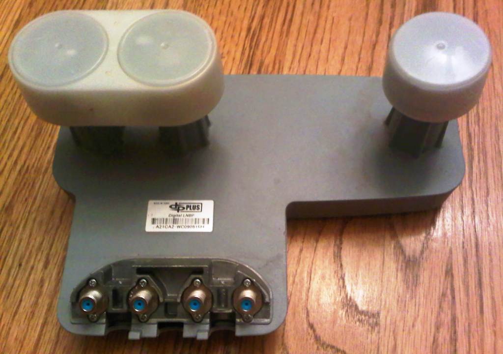

WOW, thanks for all the responds. Talked to my wife - - she is not especially excited about spending money on TV - - I'm the TV person she really is not.
Anyway, I dug around in my hayloft and found an Eastern Arc dish!! My wife says collecting dishes is a sickness of mine (how true)!!

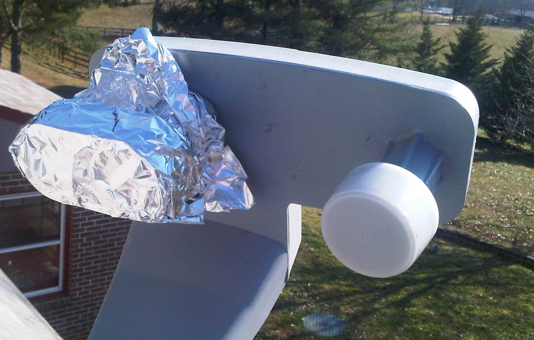

Anyway, did some reading and it says that this dish has an internal switch - - can I just run one cable to the ground block and then to the receiver? If so what port on the dish should I use? I don't have a current dish receiver yet, but could I point it using an old Dish 510?
Wife is very worried!!!:D:D:D
As long as it isnt the "input" one you'll be fine
The 510 wont work. Eastern Arc is MPEG4 and the 510 is only MPEG2
wait....scratch that. 61.5 TP29 is MPEG2 so you could try and aim the dish. You couldnt do a check switch as it would only find 61.5 though

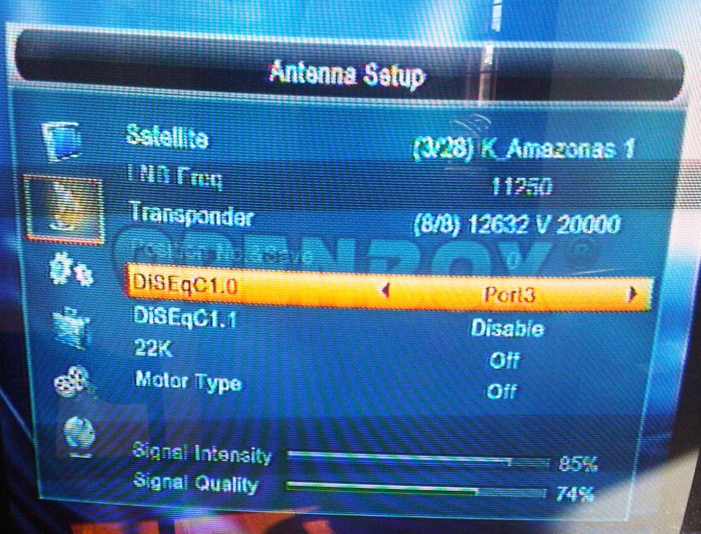

Since you probably have a FTA receiver around try it with that. I learned the 211k meter is S L O W at reacting
Is the LNB DIshPro or Legacy? If DIshPro set it up as such on the FTA reciever
11250 LNB LO
diseqc port 2 (this is the 61.5 LNB...the one on the right if you're holding the dish from behind)
transponder 12632 V 20000
when you lock signal then remove and hook up 211k and go from there

Well - - I tried and tried to get the Eastern Arc dish going but - - in the end I think it is warped a bit. Highest I got was 37 on 61.5 and 22 on 72.7 this was using the VIP211K receiver.
Ice - - I tried what you said and it worked very well for 61.5 but the other two satellites were still off after hours of fiddling. I even modified the Eastern Arc Dish to put a 1000 Plus reflector on the TurboHD dish since it was bigger. Still no dice.
Finally, I went with a Dish 500 on 110 and 119 and that works very well - - - with very strong signals. This should be just fine as all my programing will be SD only.

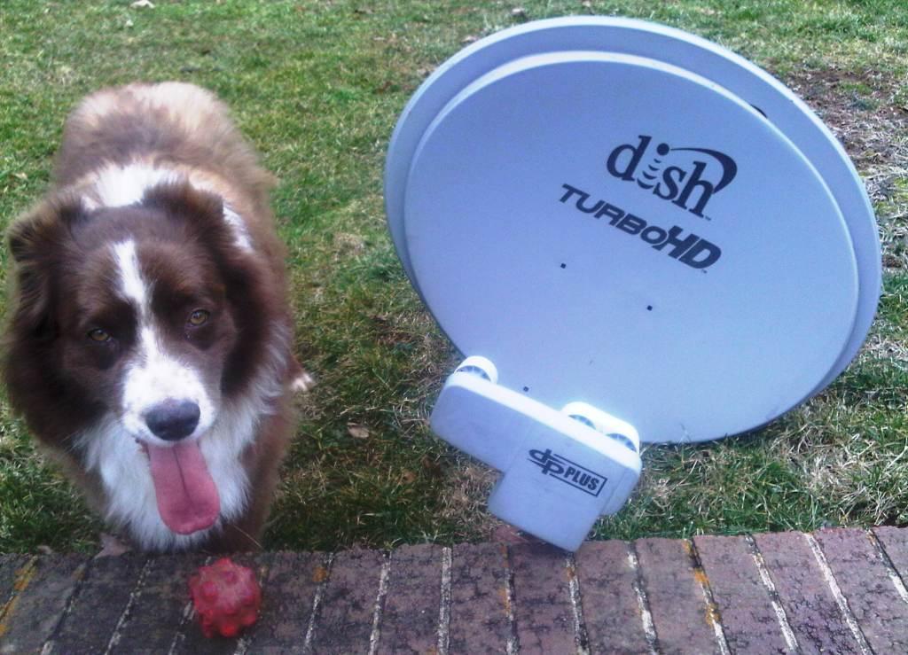

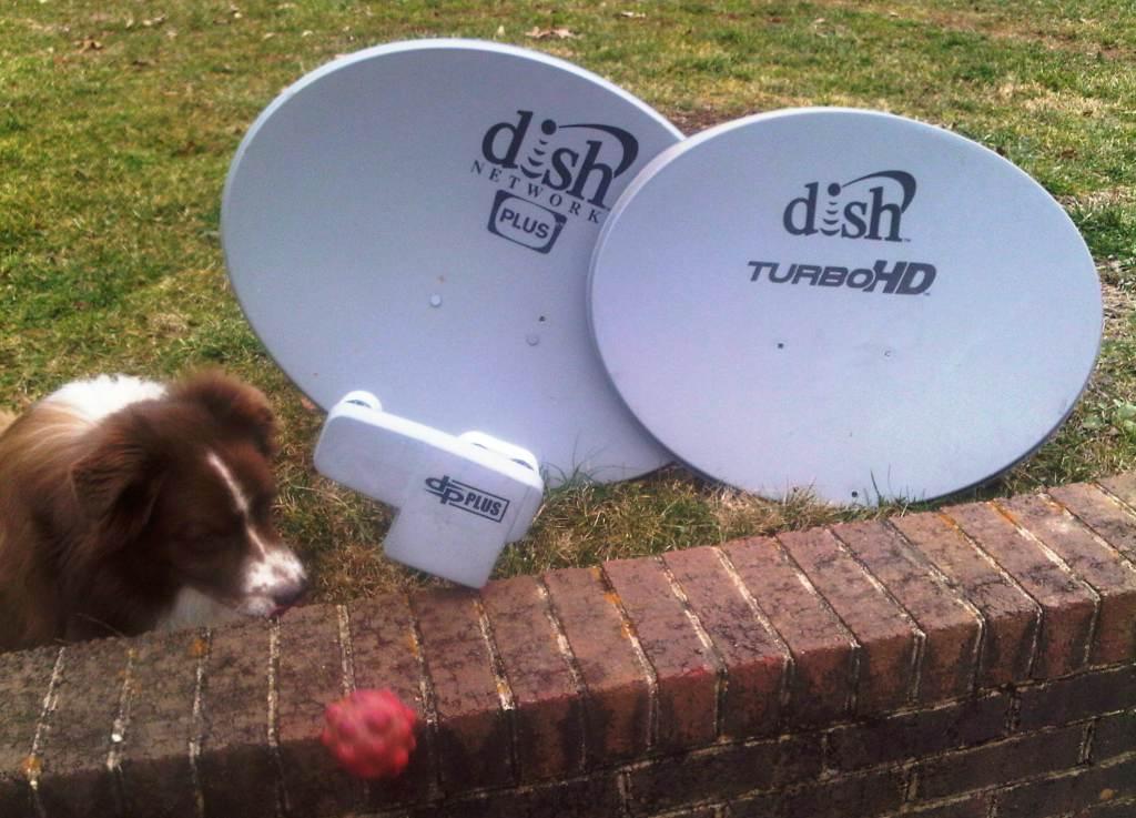

A few pix of the effort.
that woudlnt work as the focal point would be off a little bit
Yah, I finally figured that out - - but wasted about 2 hours on that one.
