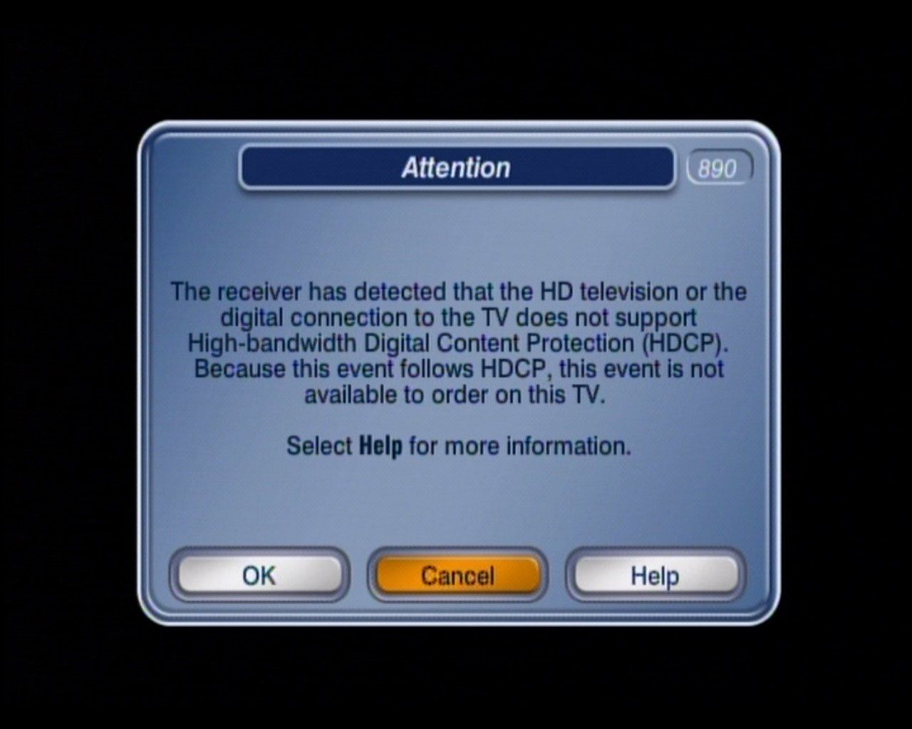

This is what I get on recorder when trying to record anything, with TV off!
You could try to connect to your TV with component cables (red, green, blue) instead of HDMI. You would also need to run red and white audio to the TV. I think that will accomplish your desired result.
Reactions: Stormy_2021
What difference does it make what is connected to TV when it's OFF!
That sound like your tv is not hdcp compliant and the having the hdmi connected is killing the video outputs. Connected it via component and I bet it goes away
